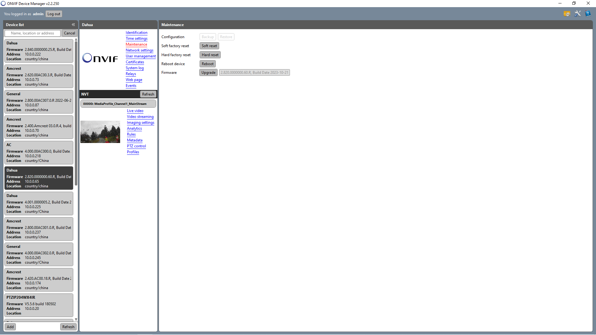

Can RTSP do this? Maybe this will help..
Screenshot (826).png (116.78 KiB) Viewed 22017 times

This link is probably the simplest and best general explanation of how ONVIF is implemented at the level we are all most familiar with. And while access control is clearly the prominent feature of Profile A, Profile S is the common profile used for typical ONVIF compliant IP security cameras and associated systems..., at least at our level. (One must also bear in mind that ONVIF standards apply to other types of IP security infrastructures beyond basic surveillance devices.)
User creation and access capabilities are intended to be handled by vendor specific mechanisms aside from any ONVIF capabilities and are indeed required for access to ONVIF capable devices in the first place. This is obviously how ONVIF Device Manager pulls ONVIF information from target devices -- by using an already existing admin level user account of the device. It simply sees and interacts with what is available from the target device once authentication to do so has been established.
https://www.pelco.com/blog/onvif-guide# ... F%20camera.
The RTSP relationship is also explained for those who may find additional clarification useful.

Revo2Maxx wrote: ↑Wed Dec 27, 2023 9:32 pm One is a Standard and other is a Protocol as I have said a good few times in this thread here..
A good once or twice. LOL
I know this. I have known this. I knew this when addressing your initial post in a subtle attempt to indicate such.
I've read the entire ONVIF Core Specification and basically understand the purpose, limits and requirements (both mandatory and optional) of all its active profiles.
It provides standardization in the communication between devices and end points that each conform to at least some of its available specifications.
In and of itself it does nothing else, including create users and/or authentication credentials. While Dahau (and others) may implement a security layer to access certain ONVIF functonality (PTZ configuration access, etc.), ONVIF otherwise requires no authorization or specific 'ONVIF User'. If so implemented as a vendor specific interface feature, it will likely be just another name (alias) for the administrative user which was my initial point.
One the other hand, and as a data transportation protocol, RTSP does require authenticated access in most cases unless specifically configured to provide anonymous access. This would be established automatically by the creation of administrative credentials for RTSP systems and devices. In the case of your initial post, perhaps indeed by the creation of 'ONVIF User'. Again, my initial point.
Apples and oranges that just happen to be in the same basket.
While I appreciate all your input, I think it may just be a 'forest for the trees' thing.
It isn't the first time we've debated semantics about something we actually agree on!
