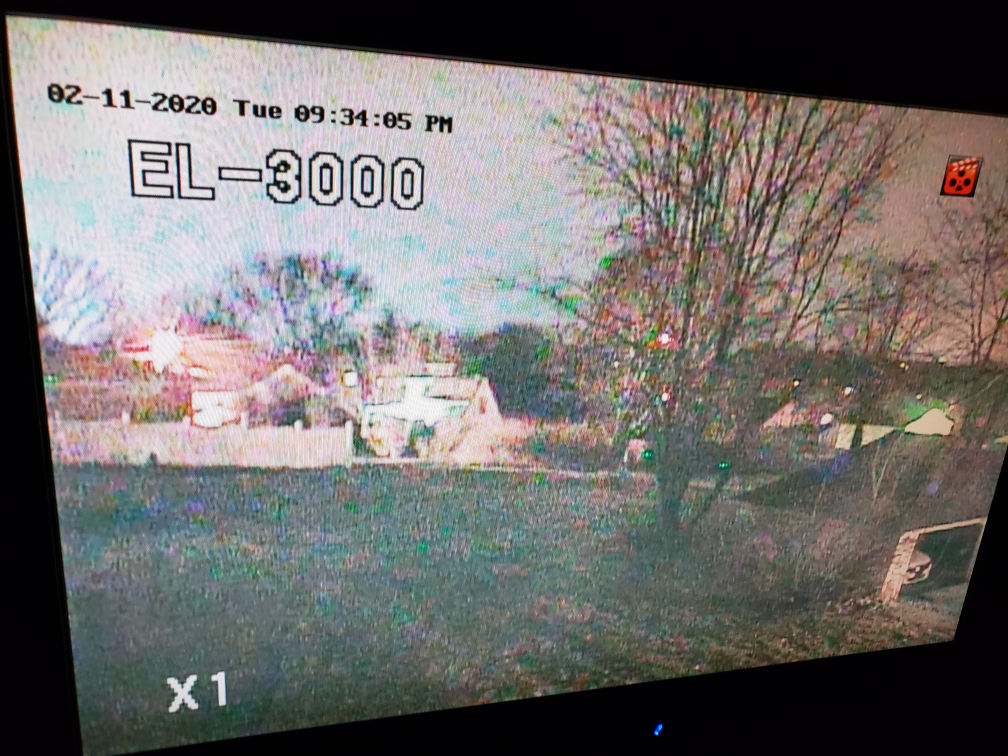

There is a few things that make working with Large MP cameras at night... Sadly it all starts out with the CMOS type of Sensor then there is image size and F-Stop and things that you can change in your camera but it is something that isn't easy to dial in... Biggest issue and I will show you pictures of one of my 10x about this next thing and that is IR wash out... If you have it pointing to close to things and using Manual IR it could have bad Results.. .If you use Smart IR could have low IR because of IR Reflections... The camera will take that as your to close and lower the IR so it don't wash out the Picture sadly at times this makes it bad...
If you have to make changes for Night time.. Please Make sure to setup for night time.. If you do under Normal time then it will be that setting all the time... Then you will want to go and make changes in the camera under Schedule for day/Night that way it will only use your night setting say after 9pm until 5am maybe need to change if it is really bad night to day difference... Because winter time days shorter so night might start now for you at 6pm and end at 7am... But want to find what works for you... By the Way... I will show you a couple of Pictures.. This camera is in the wrong place and I have had this for 10 years + THe Image is only 500TVL but you will see what I mean.. I have no outside lights on in the back, Neighbor has one facing to the front.

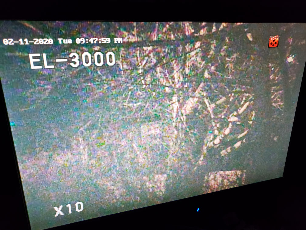

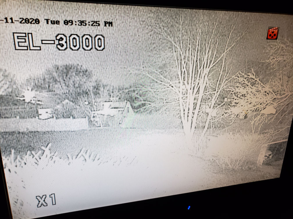

What I know is there are some camera that really are bad at night lol... I have a very old Camera that I used to use in another location.. When it was in the other location it was a nice camera most of the time. But at night time with the B/W going it was great for a few reasons 1st is that it is a Zoom camera and it would zoom much faster then when in Color mode... However one down side to this Crazy 10x zoom camera it isn't a SMART IR camera like the Amcrest cameras I own... So where I have it now I have no white light besides 1 light that is facing the other way at my neighbors.. 1 Thing that this camera has is the Ability to work in VERY LOW light at night in color.. So the image is soooo much nicer at night in Color then it is in B/W..(I can see someone walking in the yard Not to id them but see them). I am going to share this picture but DON't Judge lol Day time looks very nice Night time not so much... Also please note this camera is from 2009 or 10 I can't remember now.. I know that 500 for 10x bullet seems like a lot but seeing what I was paying for non outdoor Zoom cameras 500 was kind of cheap.. Anyway The outdoor picture in clor is loads better then in B/W because of the splash of IR sadly this camera don't have the COOL Smart IR that Amcrest Cameras have... I am going to make this smaller and I am going to put in 3 the 3rd picture is at 10x looking at a TREE zoomed in lol... I know I know this camera don't normally go here but I put it here as a Stand in for another camera that I have had to make some repairs on the Belt because it is a PTZ and also from 2011 and 9 years belt broke couple of weeks ago.. It is 12x zoom but pan and tilts this is just a HUGE BULLET no movement and weighs a ton mainly because of IR heat sink...
This one at night almost 10pm no moon out zoomed in 10x

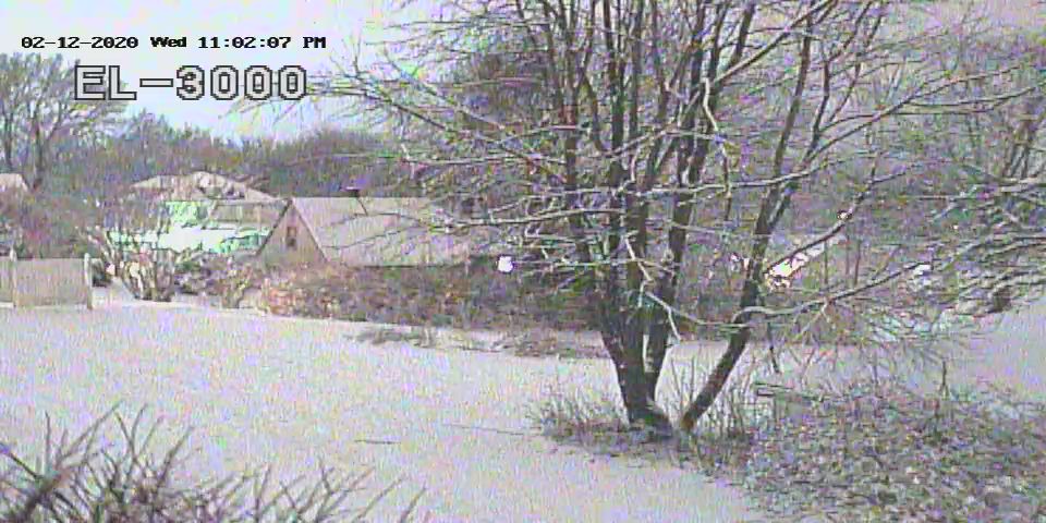

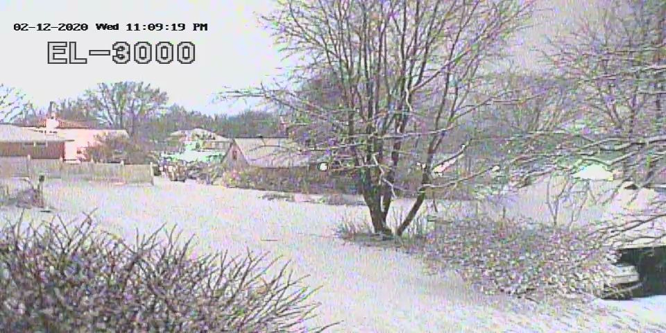

Love how snow gives the filling of light at night lol... Thought I would share tonights picture after it snowed lol... There is no more light tonight then there was last night infact to be honest with the clouds there is no Star light tonight... Just thought it looked kind of cool.
