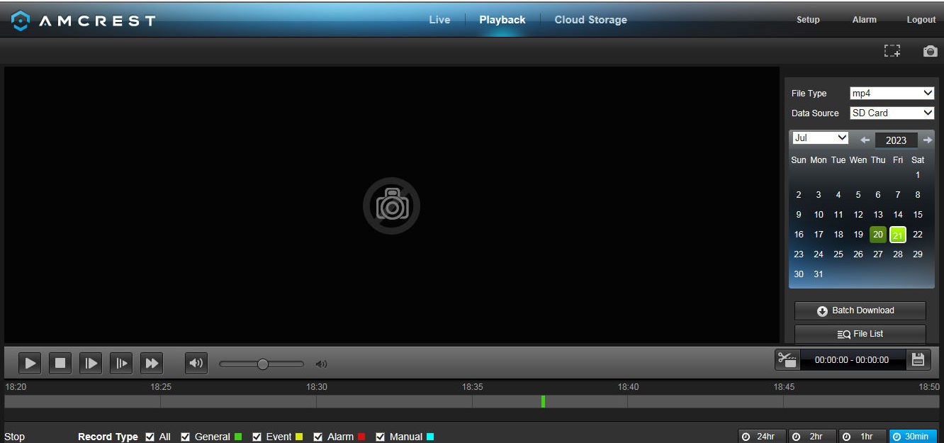

I have three IP8M-T2669-AI recently purchased that seemingly randomly stop recording to SD for anywhere from ten minutes to an hour.
The destination is a SanDisk 256GB Ultra microSDXC UHS-I Memory Card.
There appears to be some sort of pattern to the malfunction:
The breaks appear daily, often within an hour of the previous day's break. These times *may* coincide with a logon.
Sometimes I will log on during one of these breaks and recording resumes with the logon. Photo test1-1 shows recording resuming when I logged on. Same with camera test2.

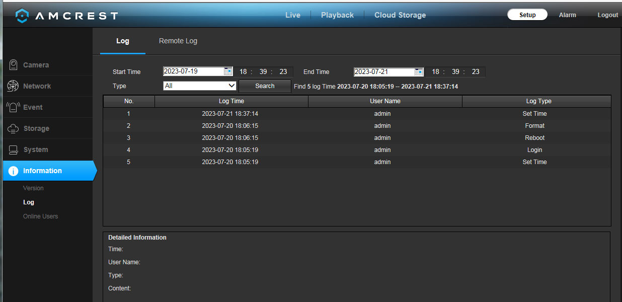

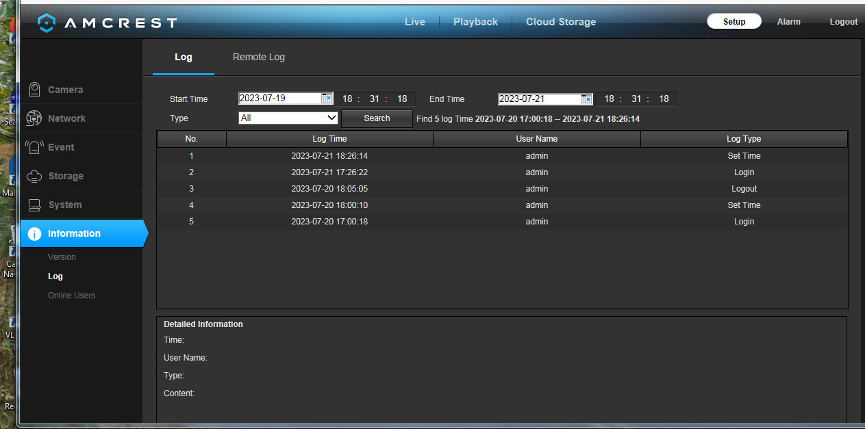

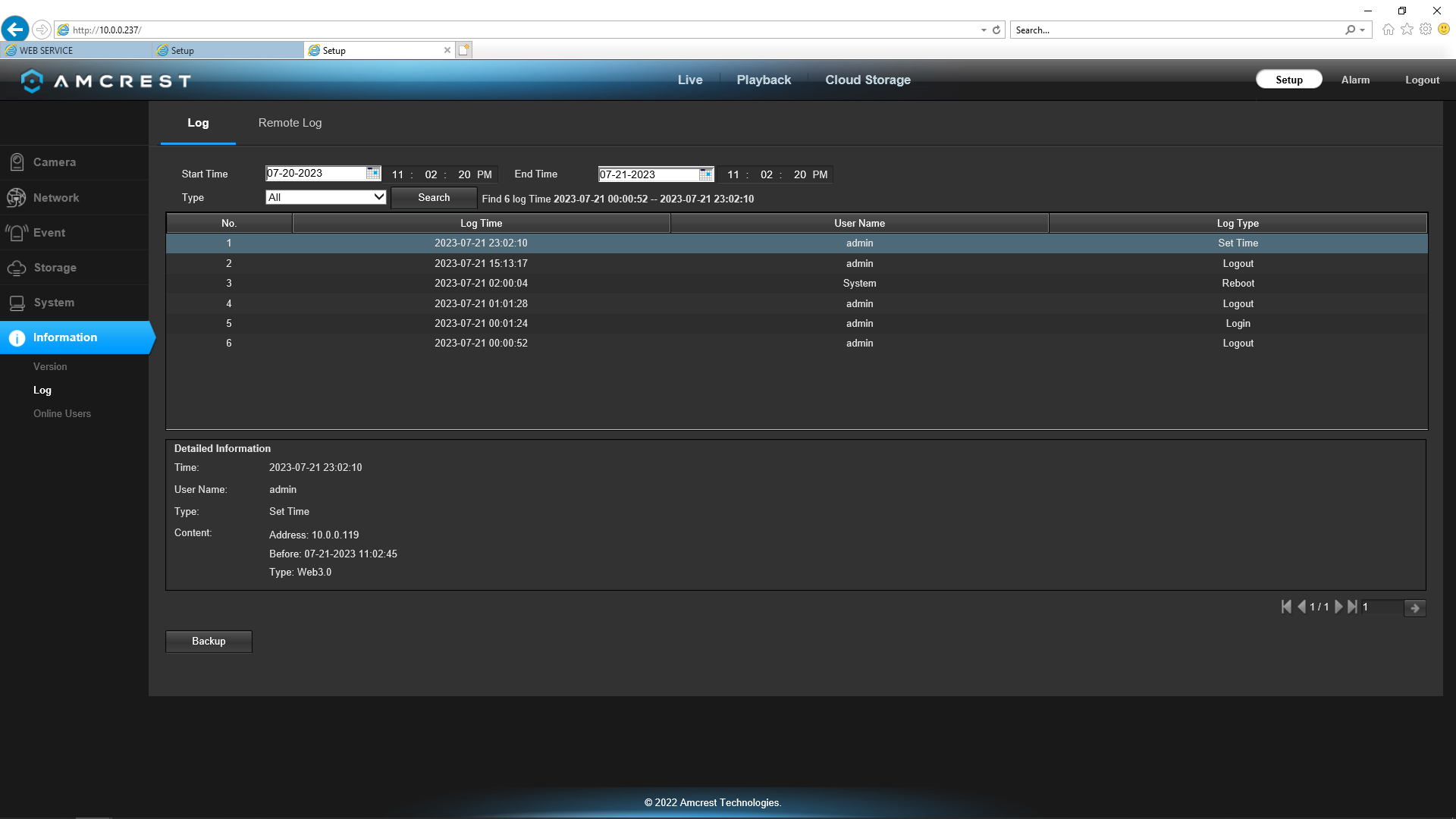

So I don't have your camera, This is from my new AI camera that is around 2 months old now. I reboot my camera every day.
So what I would do tomorrow the first time you log into your camera for the day go to setup, Information, log, and do a search for the logs. Then click on the one that shows the current log in time for Time Set and see what time it changed from. If it was like mine, less then a min or 2 then the camera should be fine for recording.
