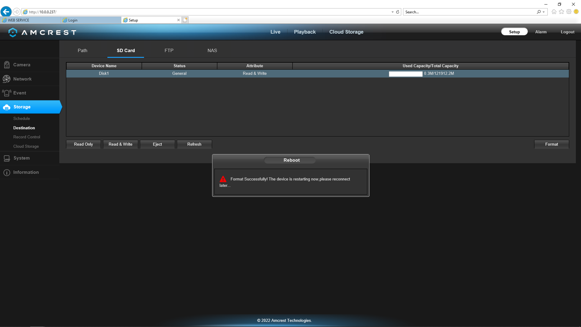

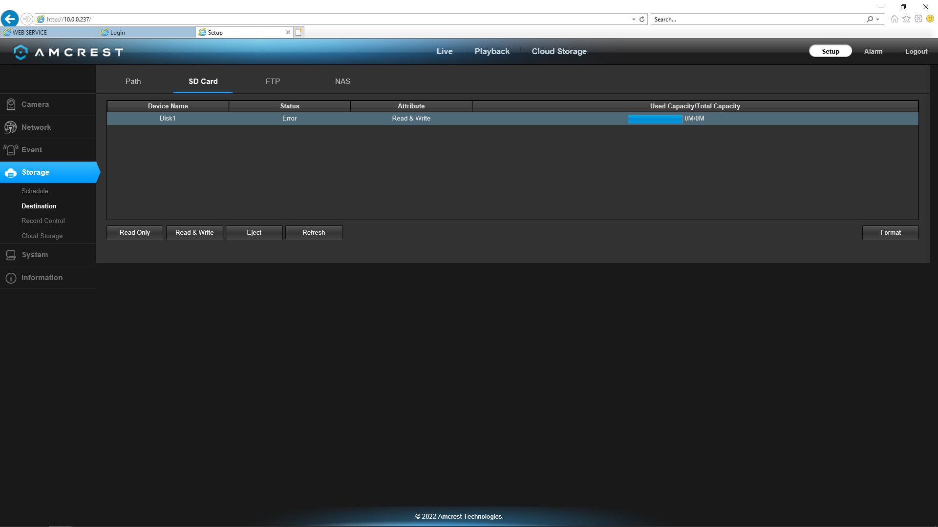

So I moved one of my 128gb WD Purple Micro SD cards to my camera and I changed the info to be stored on the MSD and not the FTP as I had it before. When I moved the card from a 4mp AI IP camera to the 8MP AI camera at first it showed an error as you can see in the picture below, I then formatted the MSD and everything says it is working and the camera Reboot. Only 2 things shows System on my Logs. The rest says admin. So I am guessing there might be an issue with your camera still. You did a factory Reset after doing the FW update?
Screenshot (4674).png (130.74 KiB) Viewed 4204 times
Screenshot (4675).png (137.07 KiB) Viewed 4204 times
