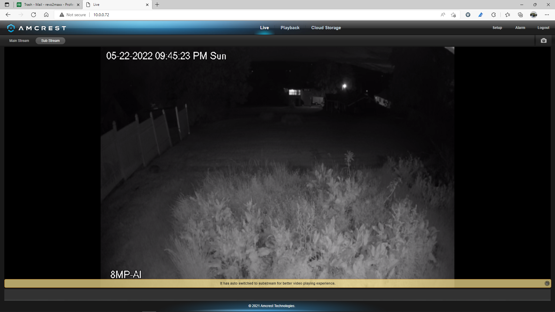

I just installed my brand new PoE Amcrest 5MP Turret POE Camera, UltraHD Outdoor IP5M-T1179EW and i have tried all sorts of video config settings but some things will cause the video feed to be slow-motion, stutter every few seconds, or just look ok but eventually switch to the Sub-stream.
I'm viewing it through 2 different web browsers (Brave and Edge) and the same thing happens.
Is this something known for this device? How do i fix it?

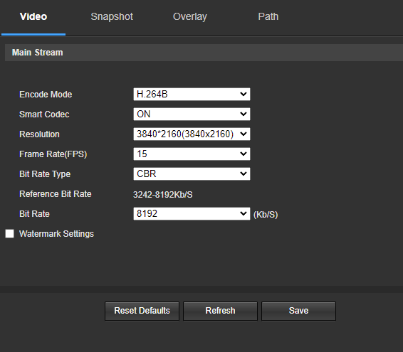

ok so mine is a 15FPS camera, 4k camera.
i can set it to:
H.264, H.264B, or H.265
smart codec: on or off
resolution: 3840x2160, 3072x2048, 3072x1728, 2592x1944, 2688x1520, 2048x1536, 2304x1296, 1920x1080, 1280x960, 1280x720
frame rate: 1-15
bit rate type: VBR or CBR
bit rate:1280, 1536, 1792, 2048, 4096, 6144, or 8192
i have made bold and underline the currently set options. when i have it on these settings and i go to view the live view feed from my brave or edge browser, after ~32 seconds it switches to the sub stream
any ideas?

so i quit using the web browsers and i switched to the Amcrest Surveillance Pro software on Windows 10 and with the following settings (see attachment) i haven't had it switch on me to Sub stream yet.
