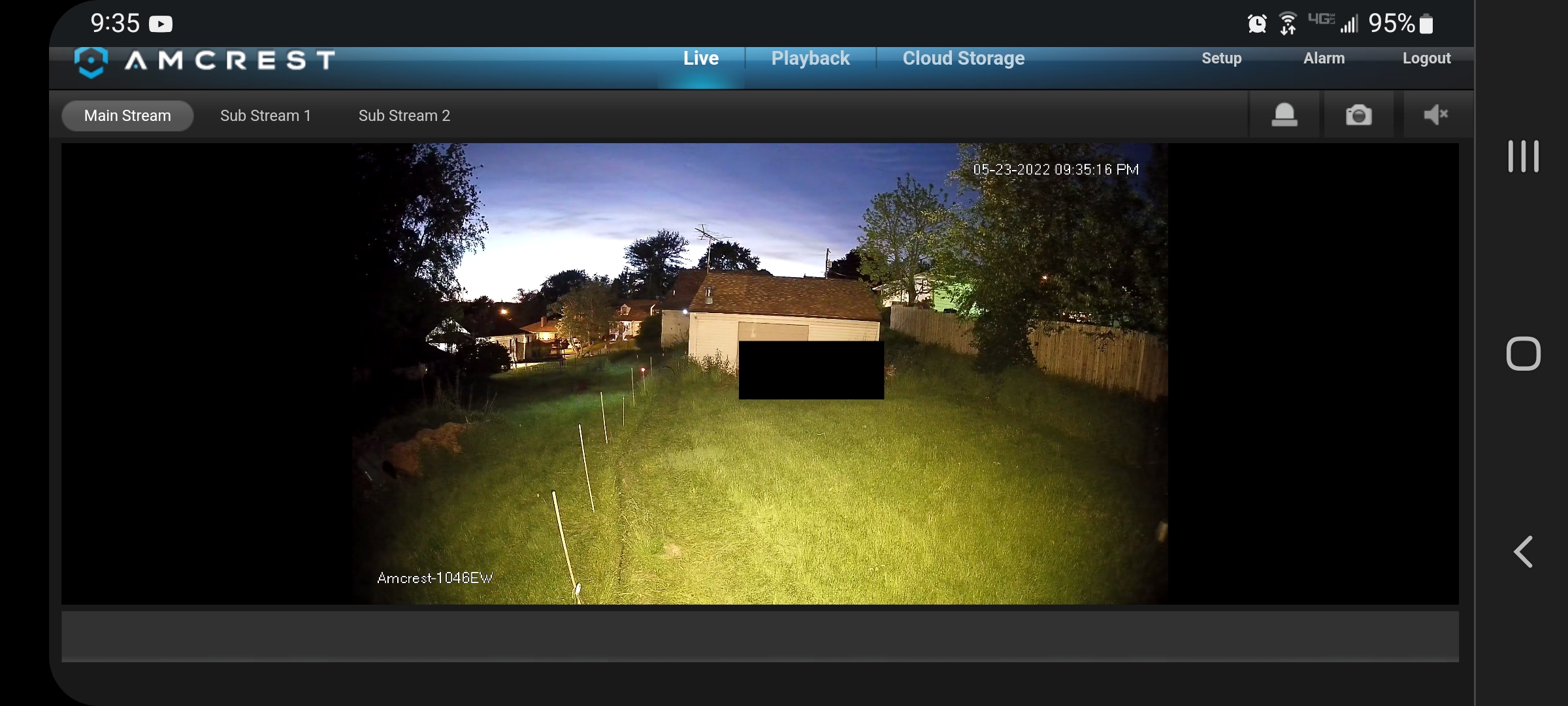

Well that is just crazy.. I normally log into my NVR or cameras if I need to set a preset from area outside of my monitor room with my Cell phone.. Wow my Cell phone is better at Video then my other 2 Computers that I listed. The main stream works fine form my S21 Ultra using Chrome. Didn't make any changes yet from when I tested the computers connection from the WebUI..
Also found my RTSP saved views for looking at the cameras live stream from Main no longer works either.. That might be something I can change in the settings however how they were setup it just does the Cone with orange bar going back and forth no load.. In case others that use RTSP that is reading this I thought was important to know..
