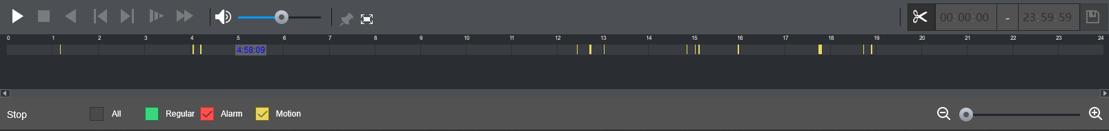

Well then that is just it.. Sadly Camera placement is the best way to make good Motion Detection setup.. So while I did show you some of the Motion alerts that do happen what I didn't show you is the ones that don't happen because it is on an area well away from random issues that would cause motion and when I ask for an alert at that area I know it is real.. Placement is key...
So this camera is showing a camera that is placed in an area that is monitored with another camera that gets false alerts do to sun and car lights however this camera is placed in an area that every one of the Motion alerts in this bar is a Real Event
Now this camera is also full time recording because it has a MIC I didn't post the Full Record Green lines so you could better see the Motion alerts.. Out of my Camera setup I have things that I don't show because of Security and one thing that I have started to do is show more cameras then I ever intended because of change in my security.. As I will be changing them in spring time..
