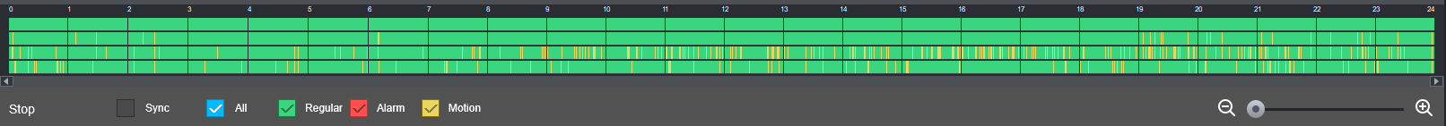

Edit here is a few of my recorders some not even showing Motion because it would be solid yellow line so I have it setup for full time only.. Will show 3 different recorders for 24 yesterday Sadly the second Recorder will just load all the events into 1 time line so that is why it only shows 1 line
