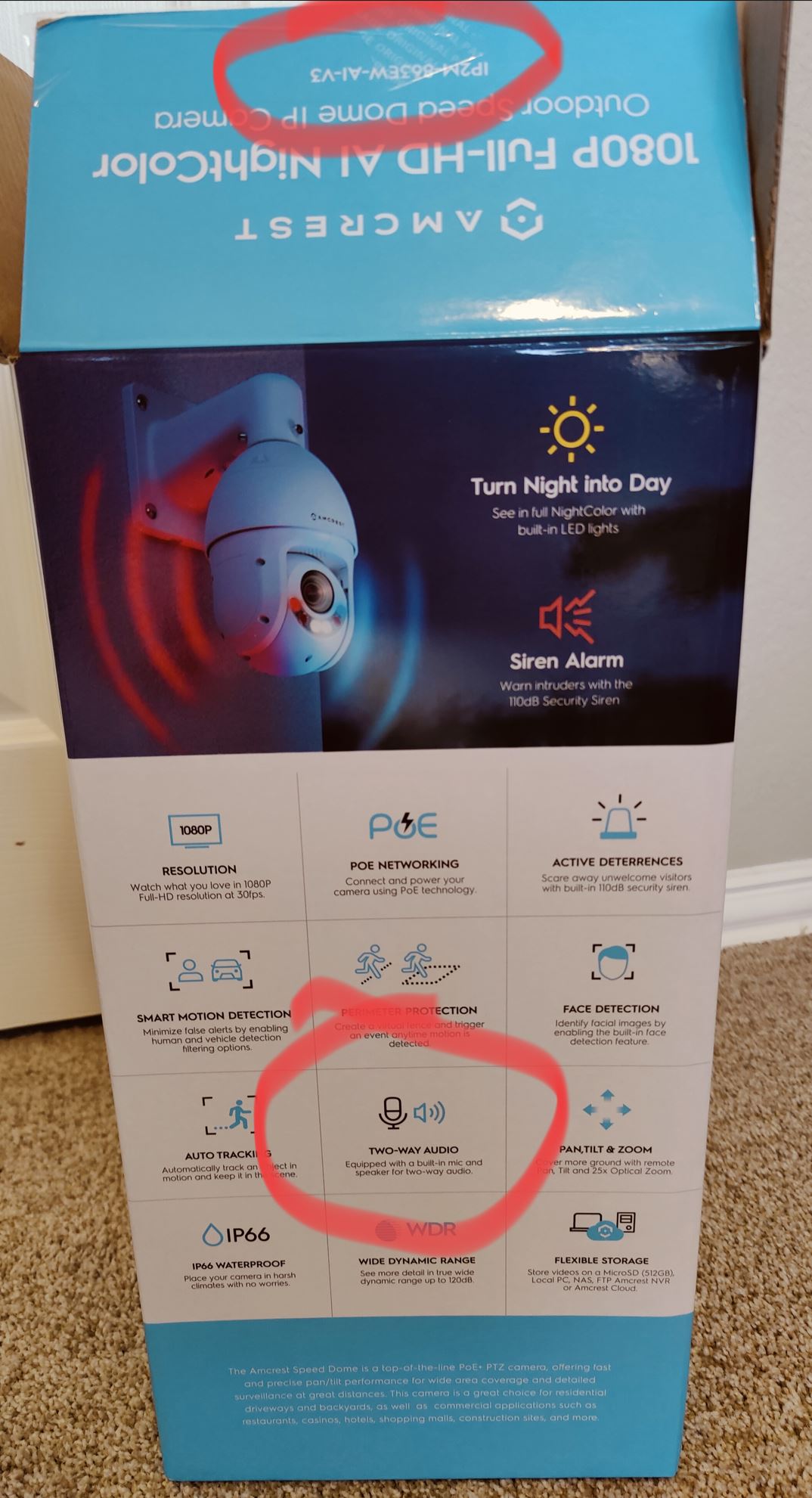

Re: Is the two-way audio included in the video recordings (IP2M-863EW-AI-V3)?
Clearly says "built-in mic" on the box ...

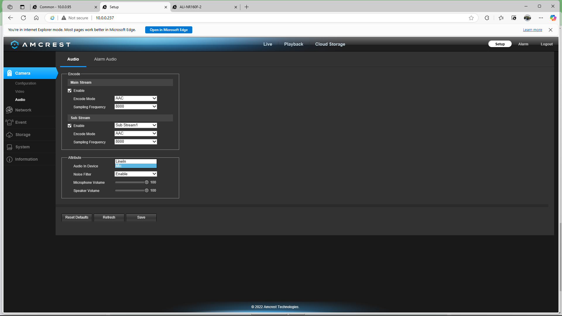

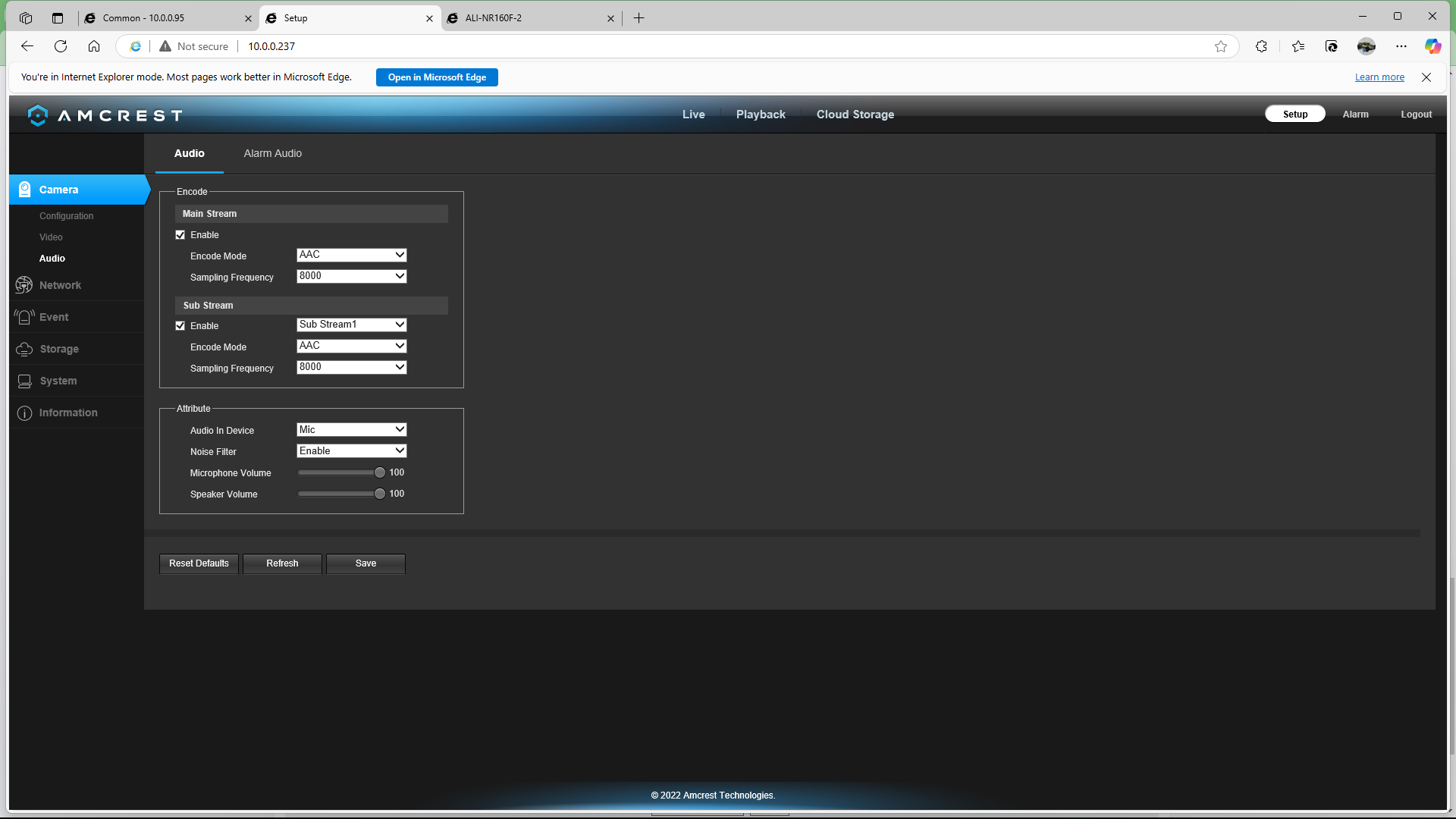

Can I see a picture of your WebUI for the camera.. At are where mine is showing in picture below? You can right click and open in new tab to see full sized image..
