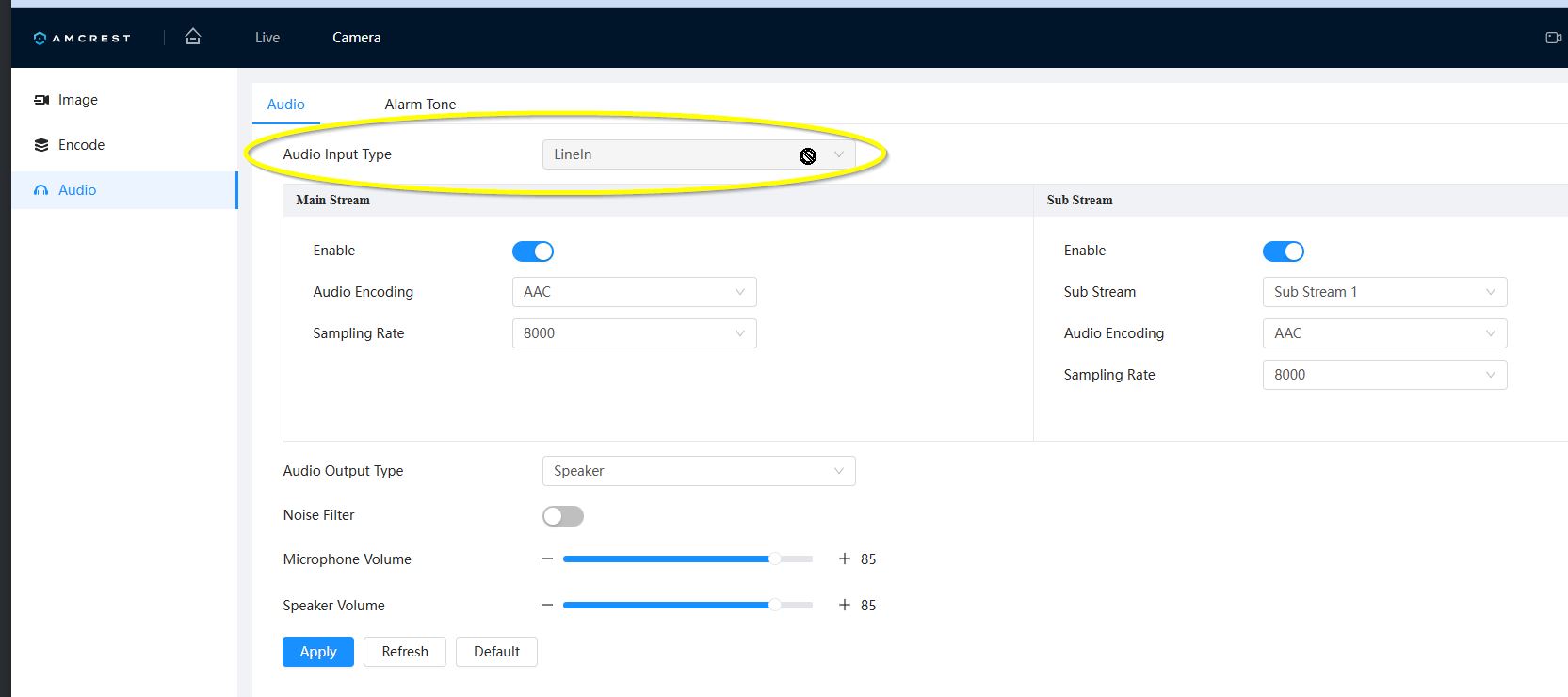

There's no dropdown to change the Audio Input Type from LineIn to Mic ...
V3 no mic dropdown option.jpg (70.15 KiB) Viewed 4033 times
Re: Is the two-way audio included in the video recordings (IP2M-863EW-AI-V3)?
Well that isn't good. I tried to see if I could send an API to the camera to change from Line in to Mic and the API that I have to the cameras with the option didn't work. So my guess with newer camera it wouldn't for you if the camera did have a Mic Input.. Sounds like Oops forgot the mic moment..

kind of absurd that they advertise a built-in mic everywhere, and in the end, it’s missing... :x
Anything could have happened. Maybe hardware issue or firmware glitch. Wish I could had my hands on one for better Idea what was going on. Maybe get lucky in April for my birthday lol.
