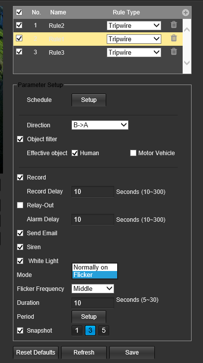

Re: IP8M-2796EB-AI how can i setup an area when motion is detected the white light turns on?
My guess is that is a feature that isn't within that camera. While I don't know all cameras offered by Amcrest I know the normal layout for most devices. So if looking at your cameras event page *Meaning Motion and or IVS if your device has IVS.. Where you make all the adjustments for the events if there is an ability to turn on a light for full time or even Flicker like the picture of one of my cameras below. It would talk about What you want to do for each event type. However there is another type that could be used still. This would be under the cameras setup area for Illumination, It might have an option of what to do for night time light. Options like Smart, IR or White led kind of thing. Under smart on my other brand camera it then turns on the led and changes to color image until the time runs out for the event then goes back to IR. So that might be an option as well..

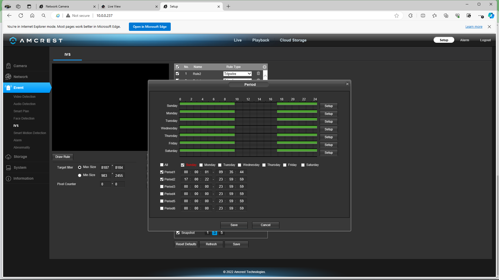

Hi sorry for the delay.....i think i may figured out the issue.... has to do with the profile setup.... during the "day" the camera light was turning on when motion detected in the camera view.
let's start from scratch. i just got the camera and i want to only have the light go on from 7pm to 8am when motion is detected in the whole camera view and when it is detected right away, not that there has to be motion for a number of seconds. how do i do this? thank you
On mine under the event you are working on in my case a Tripwire, under the light and siren area I have a Period option. In mine I have it setup to also not come on in the day time. while it isn't perfect it suits my needs... Oddly when I click it the screen for my camera goes black but there is a camera live there..
Screenshot (1882).png (158.08 KiB) Viewed 113533 times

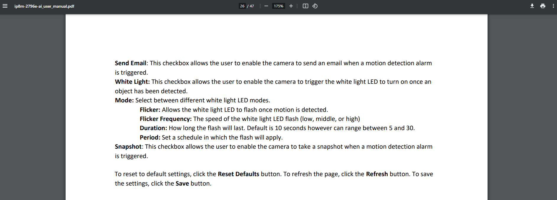

can i send the pic of the camera and you look at the intrusions i set up and see if the light should go on?
Looking at your online Manual it seems that unlike my 2685EW-AI camera your camera only option for white light is flicker.. Why mine differs is that I have an option that says Full On.. However to be honest your camera description is mis-leading then because it does say that it has Color at night ability?
