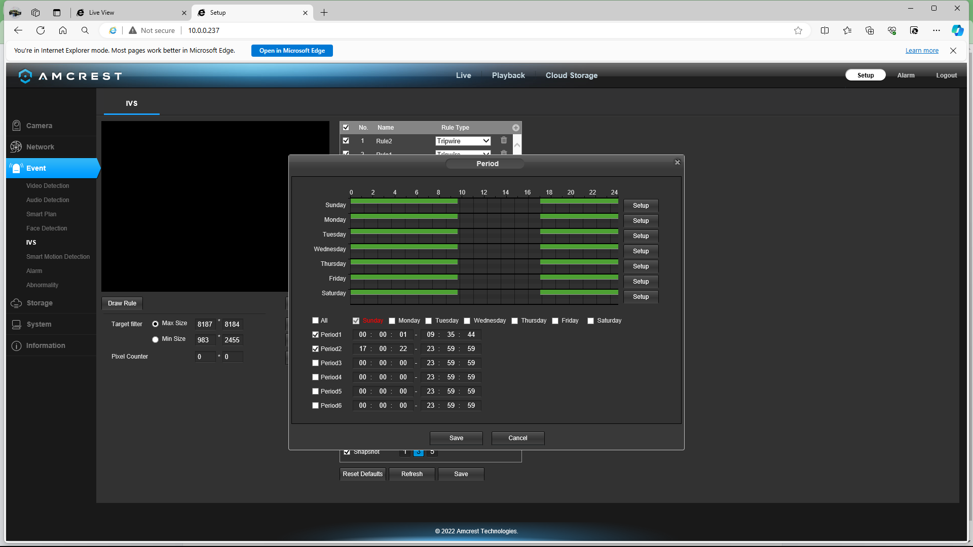

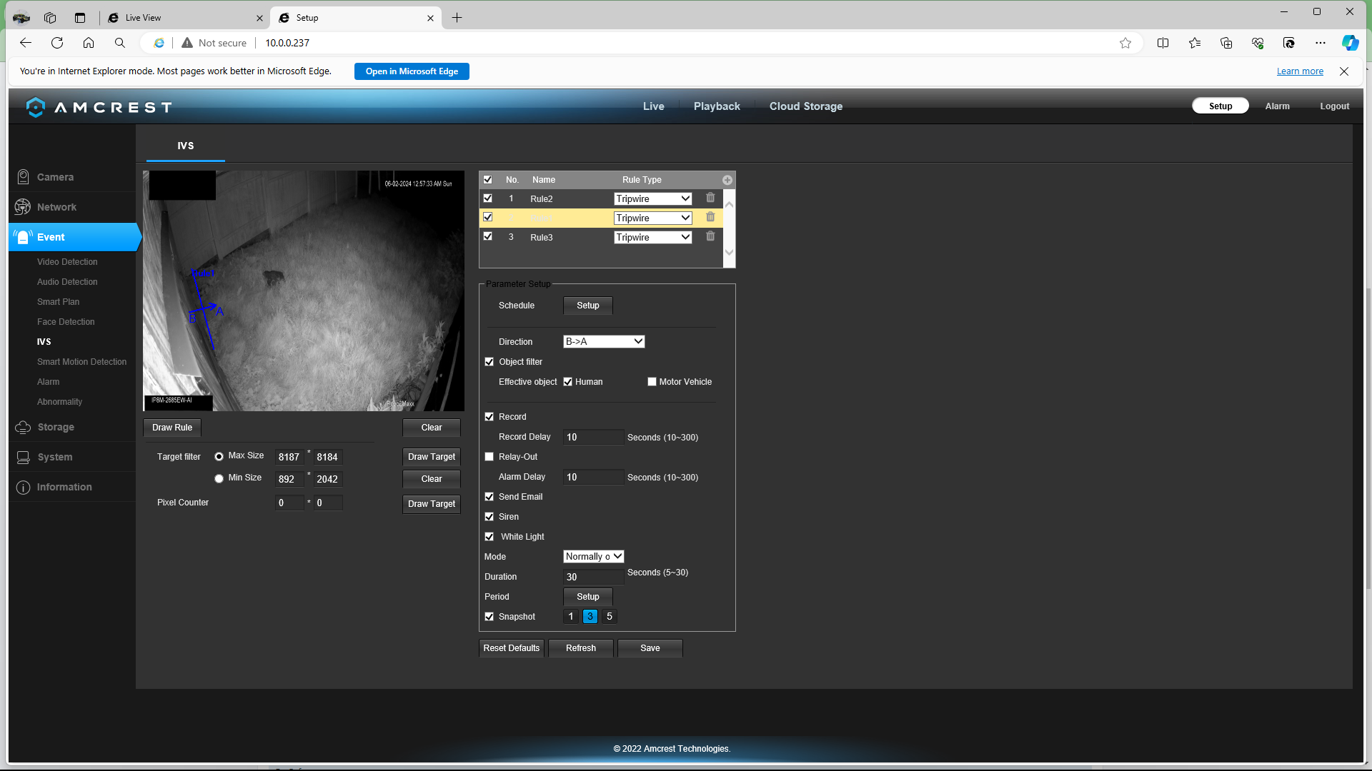

Re: IP8M-2796EB-AI how can i setup an area when motion is detected the white light turns on?
In that case, I know that my camera has the ability to setup a Schedule at day and night and maybe you setup that and didn't setup the right times. It can be hard to understand at times what is on and off using the schedules.. Please see pictures below to see if this might be the issue?
Screenshot (1960).png (291.67 KiB) Viewed 72730 times
Screenshot (1959).png (156.46 KiB) Viewed 72730 times

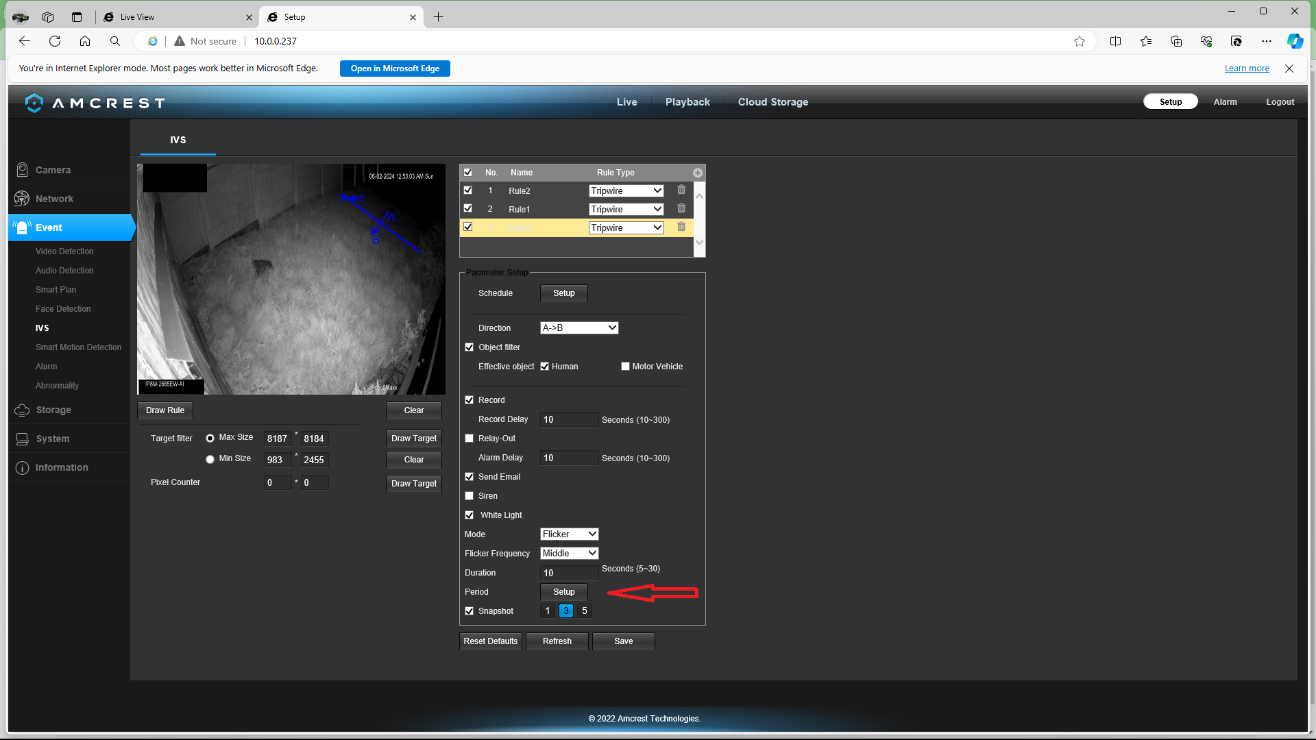

That one picture shows that event to be Flicker but this one I have setup to turn on the White light full time for 30 sec that is max offered.. Because I have other cameras that pick up the other event that I first posted in color full time already.. So that is why I have that on flicker.. Siren is normally on but have kids that were playing in it so for now I have alarm off to keep peace with my neighbors lol
Screenshot (1961).png (290.05 KiB) Viewed 72730 times
