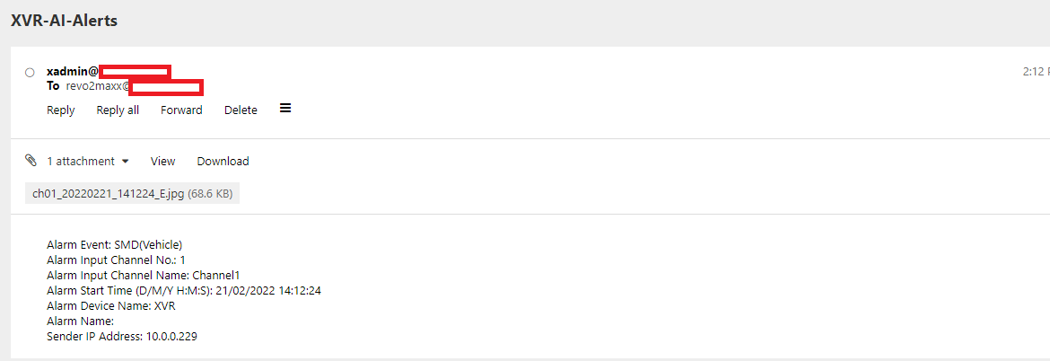

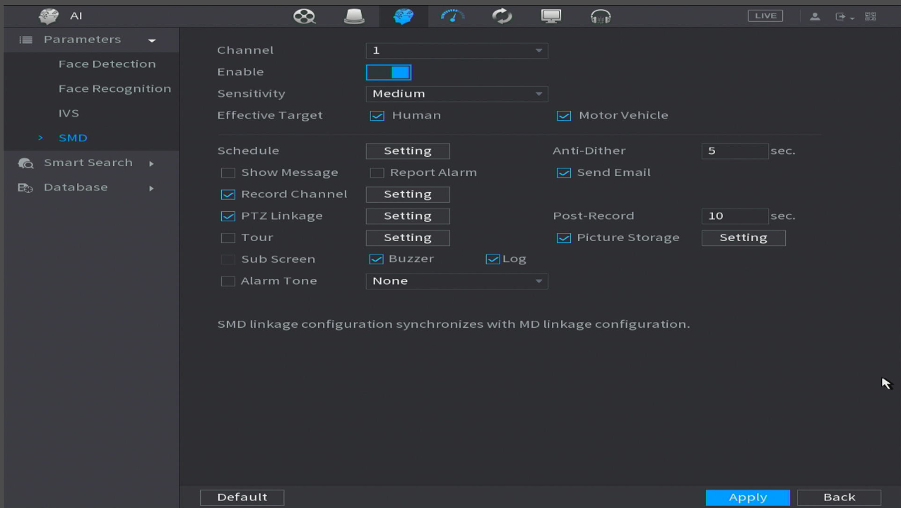

So looking at my AI Dvr that does offer SMD I did turn on my Ch1 for SMD that I normally have connected with IVS seeing it post a image and keeps tracking of numbers using IVS rules. Anyway about SMD, I enabled and turned on my Email and it works as expected (1 Picture per event) Not that is what I want lol I would prefer to have event record images like motion does with 1, 3, or 5 images.
So while this might be something that is different with the DVR seeing it does have larger CPU, Ram, and computing space it might be that the DVR preforms better in this area.
So what I know about SMD, the system uses motion info and adds some AI parts to weed out the false alarms. Can you 100% tell that your getting SMD and not motion emails? Do you have motion enabled with emails? On my DVR when I make a change to the Anti Dither on the SMD and I go look at the motion area under the alarms that change is also moved there as well. So it might be that all info for AD is just in 1 place for your camera where I have it on the SMD page as well of my DVR... Your email should say that it was SMD I have some pictures below
