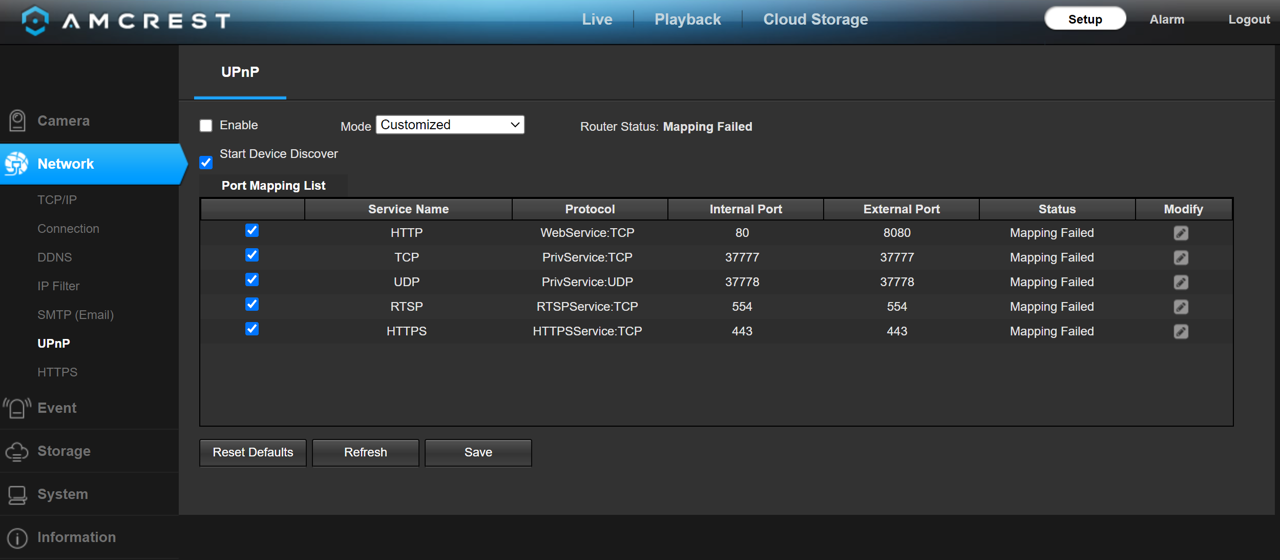

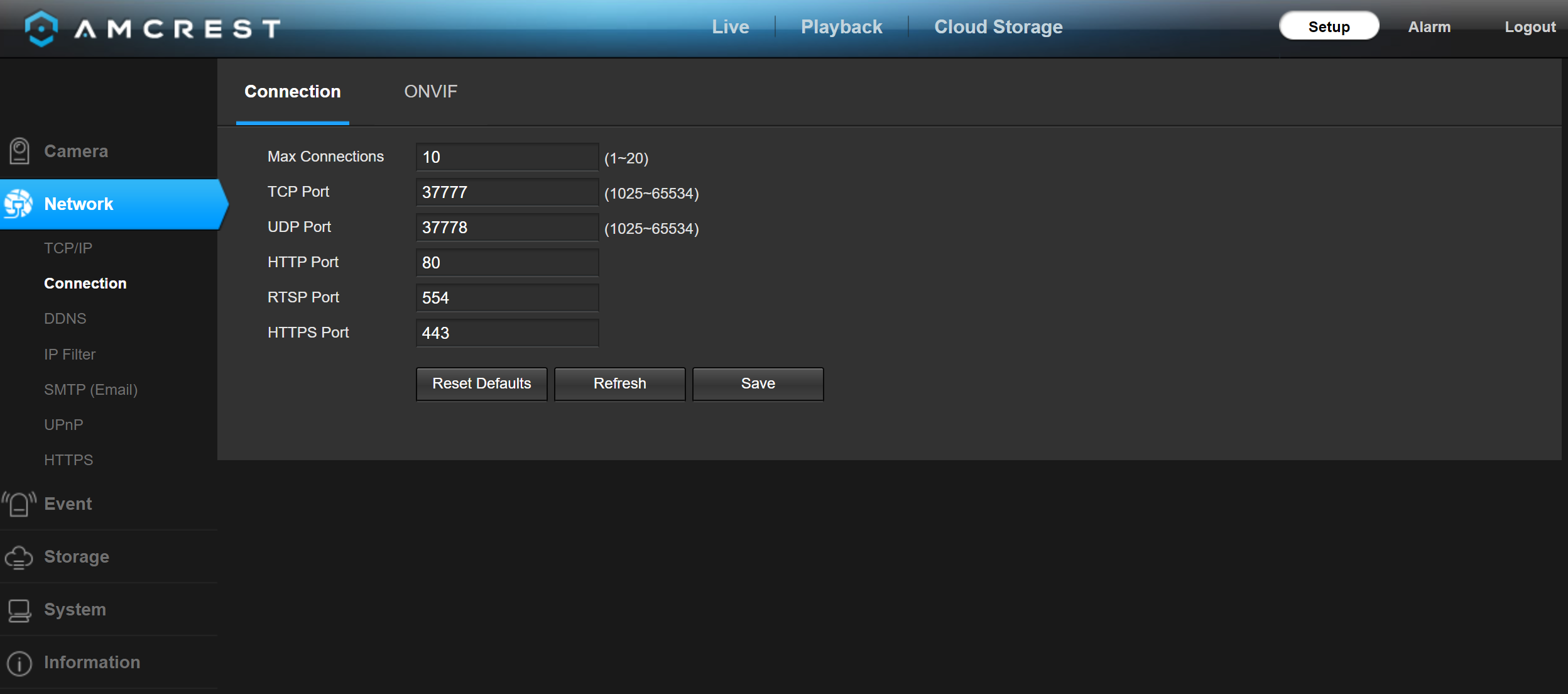

The challenge with inserting the YouTube URL is that there doesn't appear to be anywhere I can insert it in the Amcrest setup screens! I have attached a couple of screen images to show you what I mean. (Must admit I'm not that familiar with all this, so maybe I'm making a silly mistake somewhere? But under Network on the left hand side you can see I don't have an RTSP or RTMP option where I could (I assume) select it and enter any YT URL).

- Amcrest Network UPnP Setup Screen.png (178.46 KiB) Viewed 10593 times
- Amcrest Network Connection Setup Screen.png (216.72 KiB) Viewed 10593 times

If I go Network > Connection and change RTSP port to 1935 I get a Port Conflict error message
Sorry - beginning to realise I'm a bit of a numpty on this subject! But hopefully I'm following your suggestions correctly?
