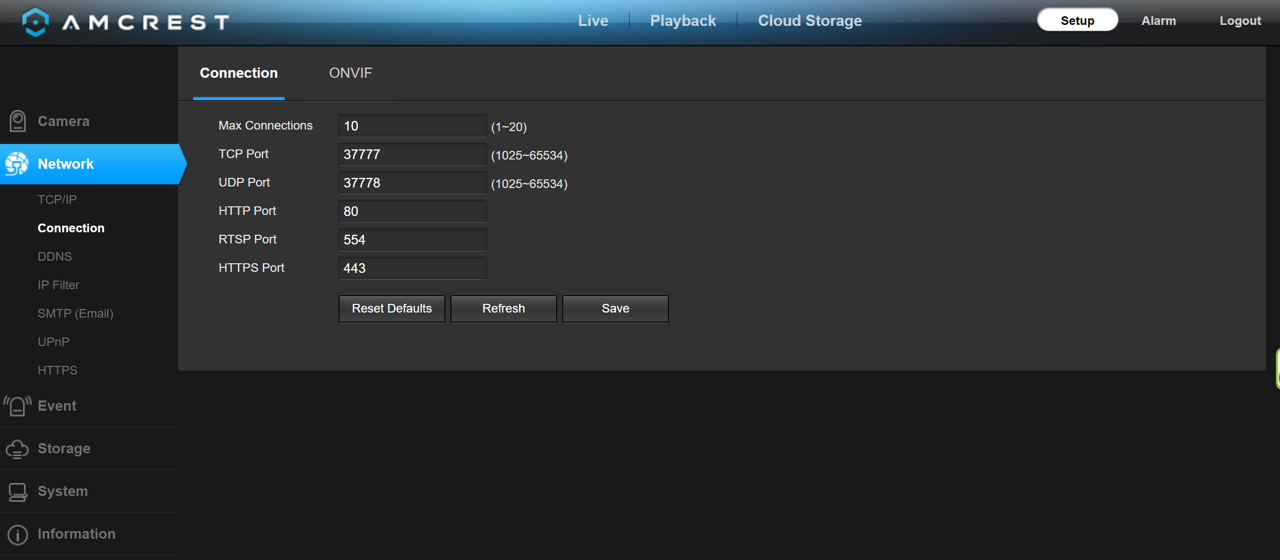

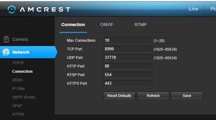

Before going too much further, check for the RTMP option here. This is where the magic happens.

Sadly, no RTMP option showing...
No RTMP option.png (130.27 KiB) Viewed 8315 times

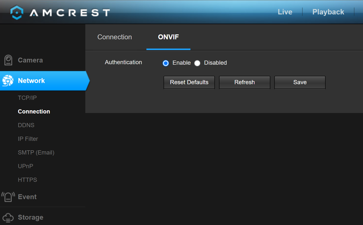

Hmmmm. Did you check what ONVIF has to offer?
Welshwood
Posts: 23
Joined: Tue Mar 15, 2022 8:05 am
Re: IP8M-2496E and RTMP
Post by Welshwood »
Yes... not a lot! Here's a pic of what I see. Not sure what I can do with this.
