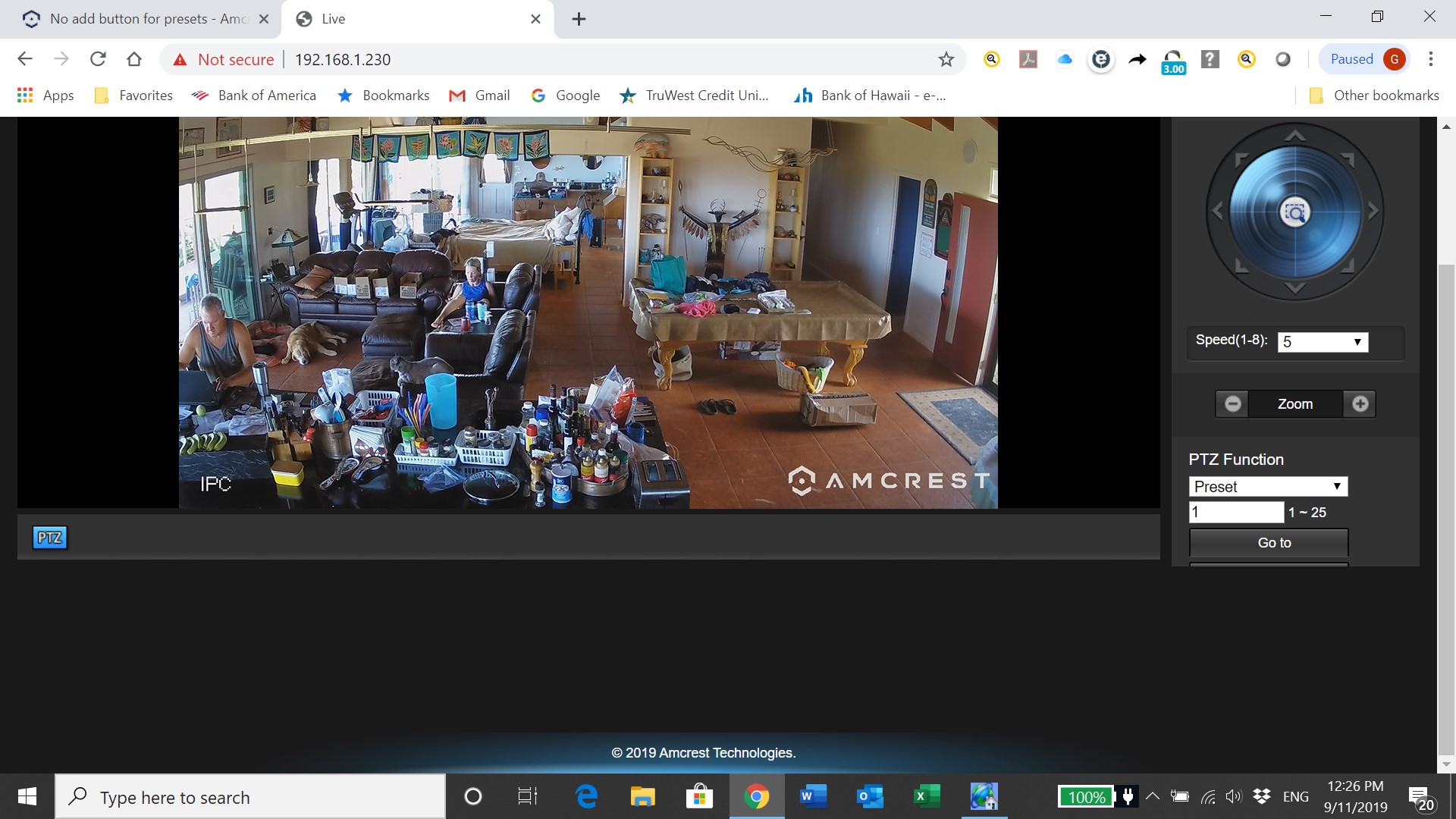

Preset buttons Add and Delete are not visible in Chrome.
Amcrest Preset 2.jpg (324.58 KiB) Viewed 40926 times
