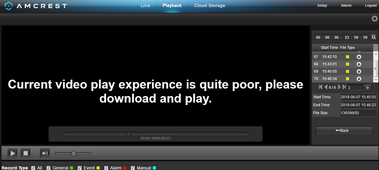

After using this new firmware a couple of more days, I've come up with an issue that needs attention.
My IP3M-941B has the new firmware. When doing playback on the Camera gui using Chrome, it will play for about 30 seconds, then stop and tell me to download the file to play back. That is an unacceptable method to review video. I never had this problem before the firmware update.
I've done a hard reset and completely re-installed the camera five times with same result. The camera is 12' from the router and has a maxed out signal. The computer is even closer. Same hardware as I was using prior to the firmware update.
I'm totally prepared to roll back the firmware to the previous version. Is that possible, risky, whatever?
https://amcrest.com/forum/download/file ... iew&id=930

- videoplayback.JPG (80.54 KiB) Viewed 21871 times

Yes, that's what they say. However, my camera is now sooooooo slooooooooooooow and I can't playback video without downloading it first, I'm willing to take the chance if it's possible to successfully do. Otherwise, the camera is almost useless.
