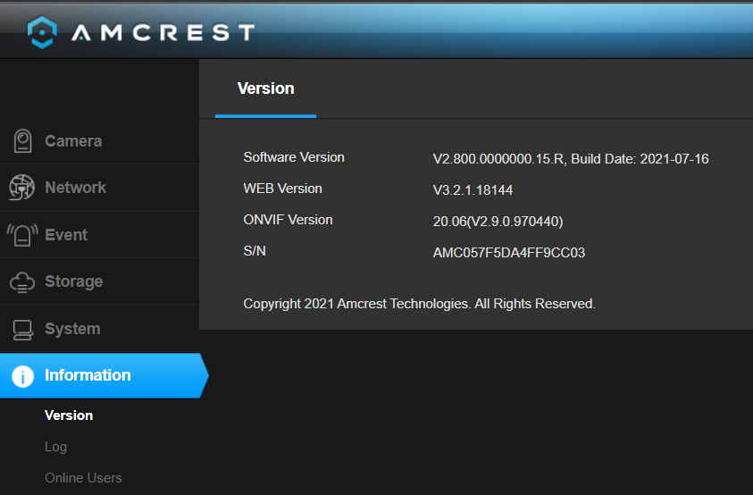

It has the latest firmware:
Code: Select all
Software VersionV2.800.0000000.15.R, Build Date: 2021-07-16
WEB VersionV3.2.1.18144

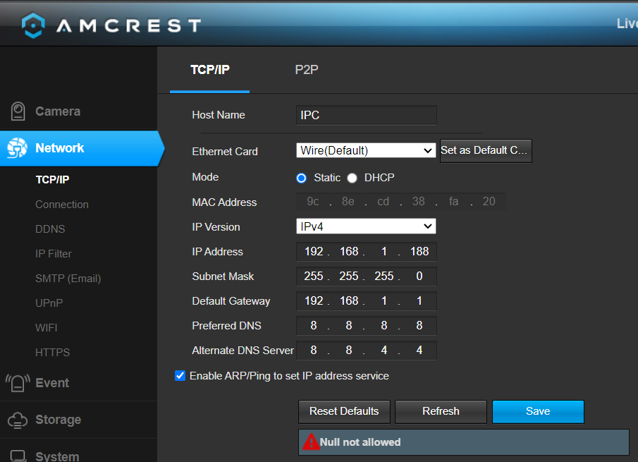

When I access its web page and go to Setup->Network->TCP/IP and select 'Static' for the Mode and click 'Save', I get "Null not Allowed"

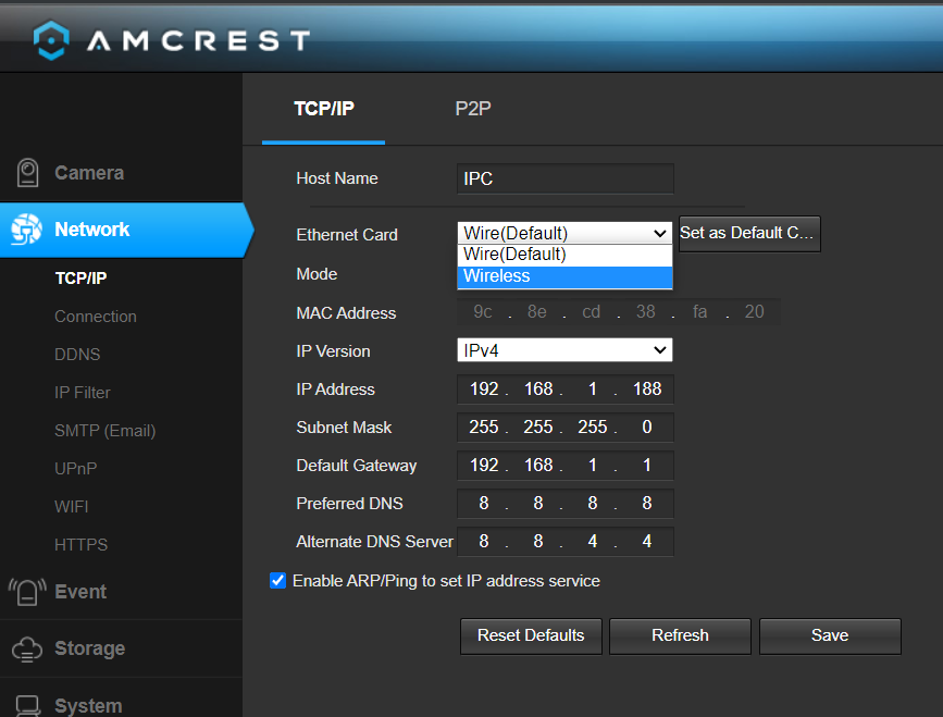

I need to run this over WiFi, but when I select "Wireless" for Ethernet Card, I get "Null not Allowed"
Nothing I change on that page sticks: I make a change, click on Save, get "Null not Allowed", click Refresh and it all goes back to the defaults.

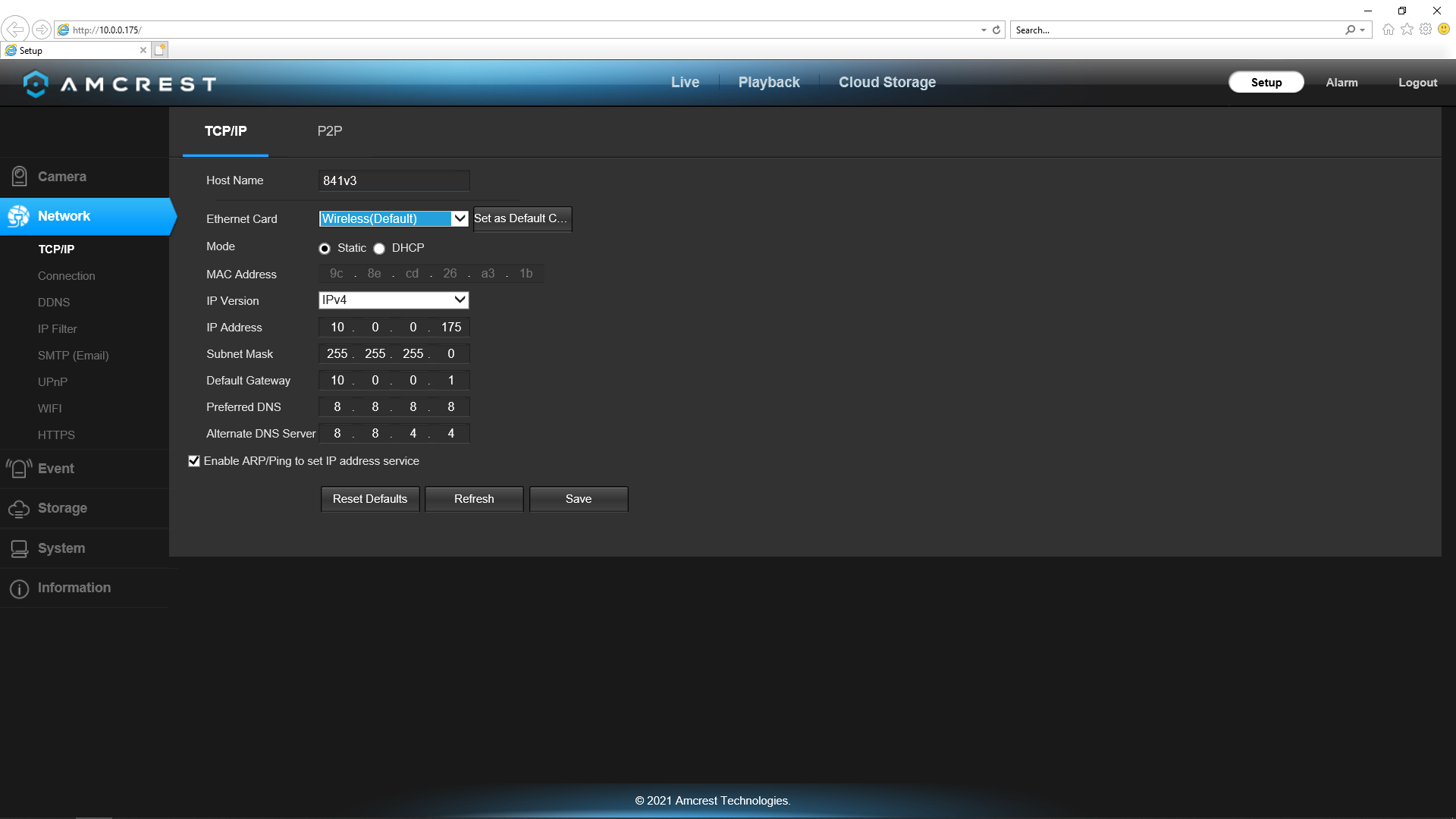

That is strange. I can't even get it to switch to Wireless card.

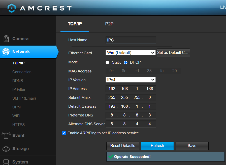

Here is where I select Wireless for the Ethernet Card:

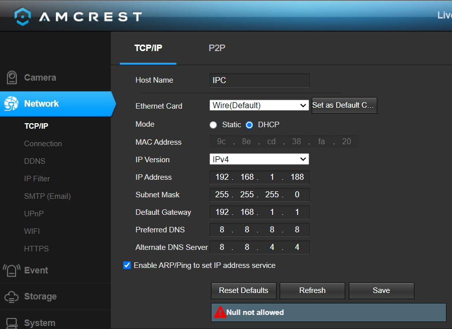

And it immediate responds with this error and goes back to Wire(Default):
If I click on Static and click on Save, I get this error:

Re: IP2M-841B-V3 Cannot set Static IP address

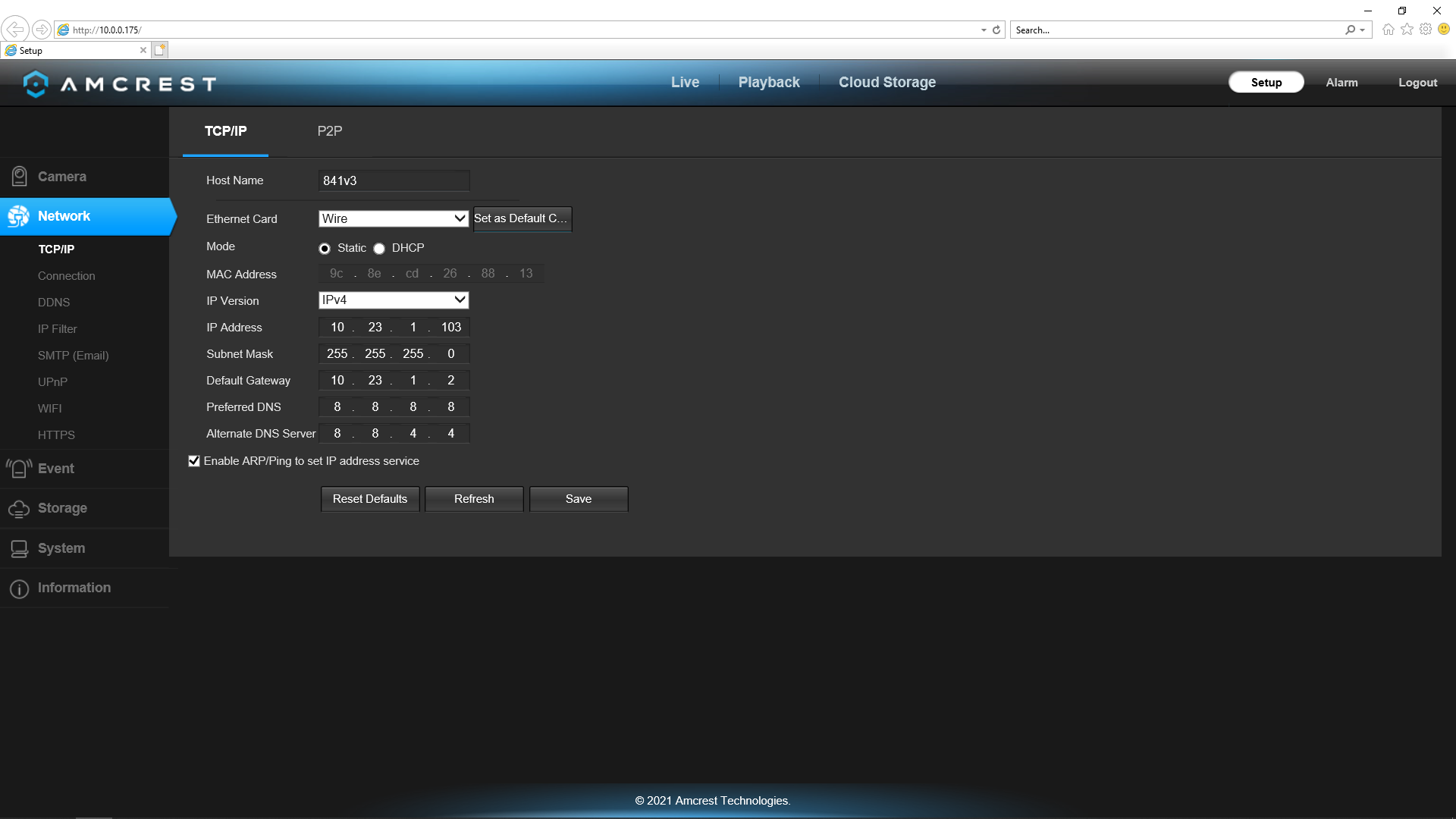

Here is how mine comes out I did change the wireless to being default as well but don't think that had anything to do with it
Screenshot (2655).png (159.2 KiB) Viewed 7031 times
Screenshot (2656).png (160.03 KiB) Viewed 7031 times

So after selecting Static from the previous post and clicking save, I then click on Refresh and it reverts back to DHCP:
Here is the full version:
