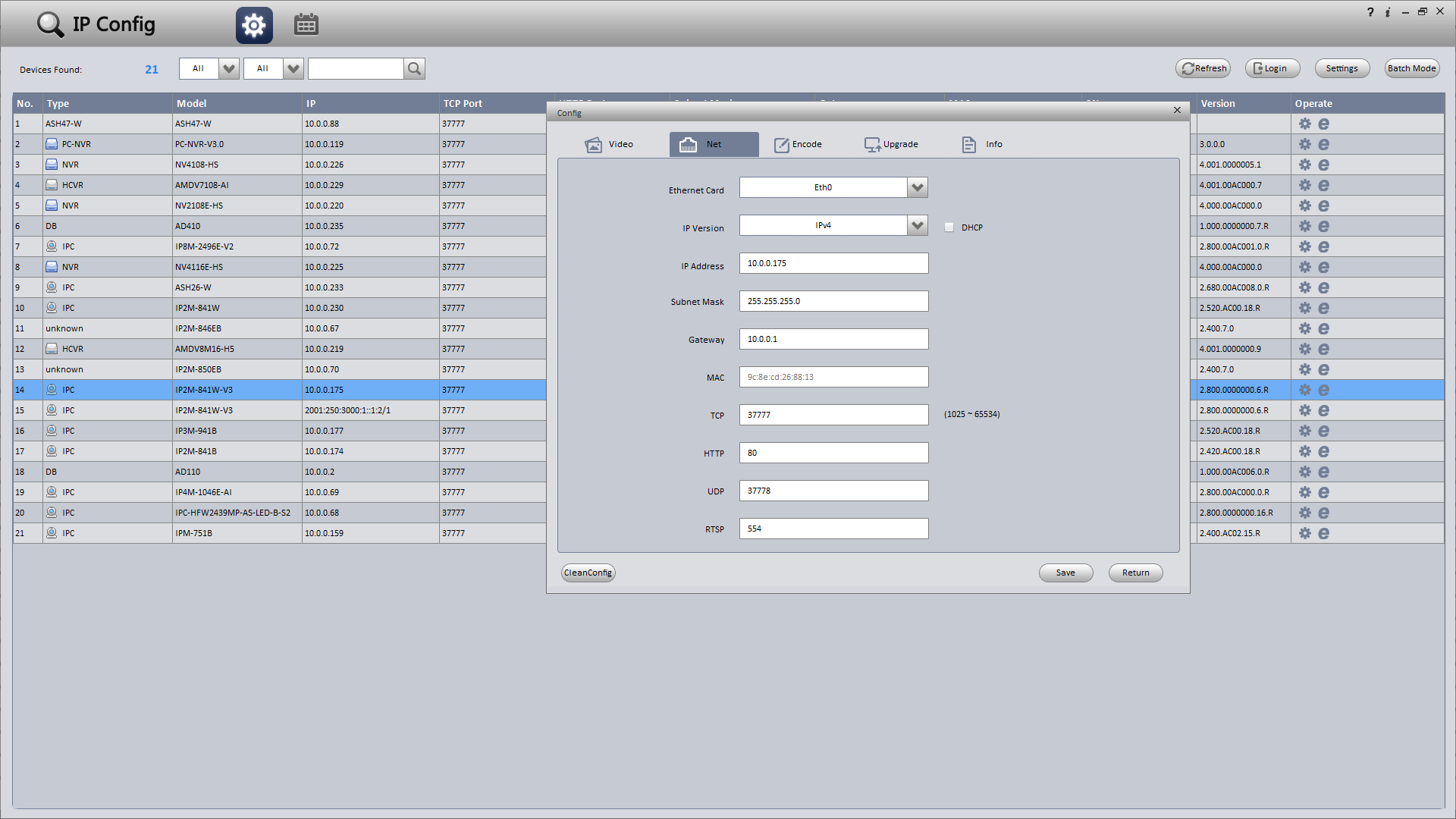

Download Ip Config from Amcrest. I think I might have found why the FW I have is no longer in use. *I Think* anyway I did away with the IP config i have been using for years and DL Amcrest one again. It is out of date to the one I was using but things are little easier to get though.
First once you DL and install, Run, Then click on Settings, then Enter your Default Password and IP range if needed. Password is what is most important. Then click Search, if you camera comes up click the COG next to the e at the end, Then click Net, Eth0 is for Wired and Eth1 is Wireless. So I just changed my v3 from the IP info that I had last time tonight to reflect the 175 for wired and I did change to 177 for wireless because it came up with error that I couldn't save as the same even though *I right now have wifi turned off because I am using on my Desk*
So to expand on Cloud, I asked because you had said that once you made changes it was changed back and only way I know for that to happen is from the cloud system. Now I don't know it will for network I know it does for Encoding and the changes is why I removed Cloud from all my Amcrest Devices. Was an Idea not saying it was the right one for the issue your having..
My V3 in IP config in Amcrest software is showing IP6 even though I have it turned off, I wonder if there was an issue with my Version and Ip6 and when they made your new Version if it messed up NEtworking.. I will put your FW back in and see if it still displays the IP6 it is only camera that has that and it is odd to me.. In the other IP config I was using it didn't show it..
