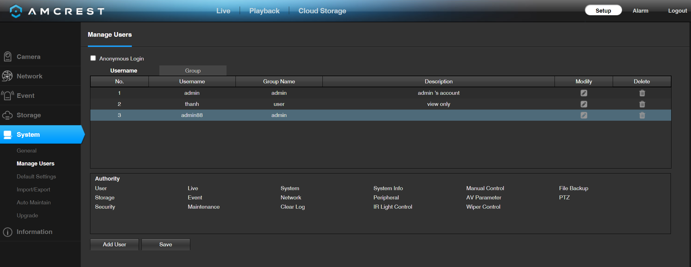

I have multiple IP2M-841B running with latest firmware. I observe that user "admin88" was created automatically without my consent despite:
- I have tried to delete this "admin88" user multiple of times but it automatically comes back.
- I have changed to a very strong and complex master password to make sure that noone can create addtional "admin88" user.
- I have manually done soft reset/hard reset the camera many times and verified that the "admin88" is automatically added in afterward.

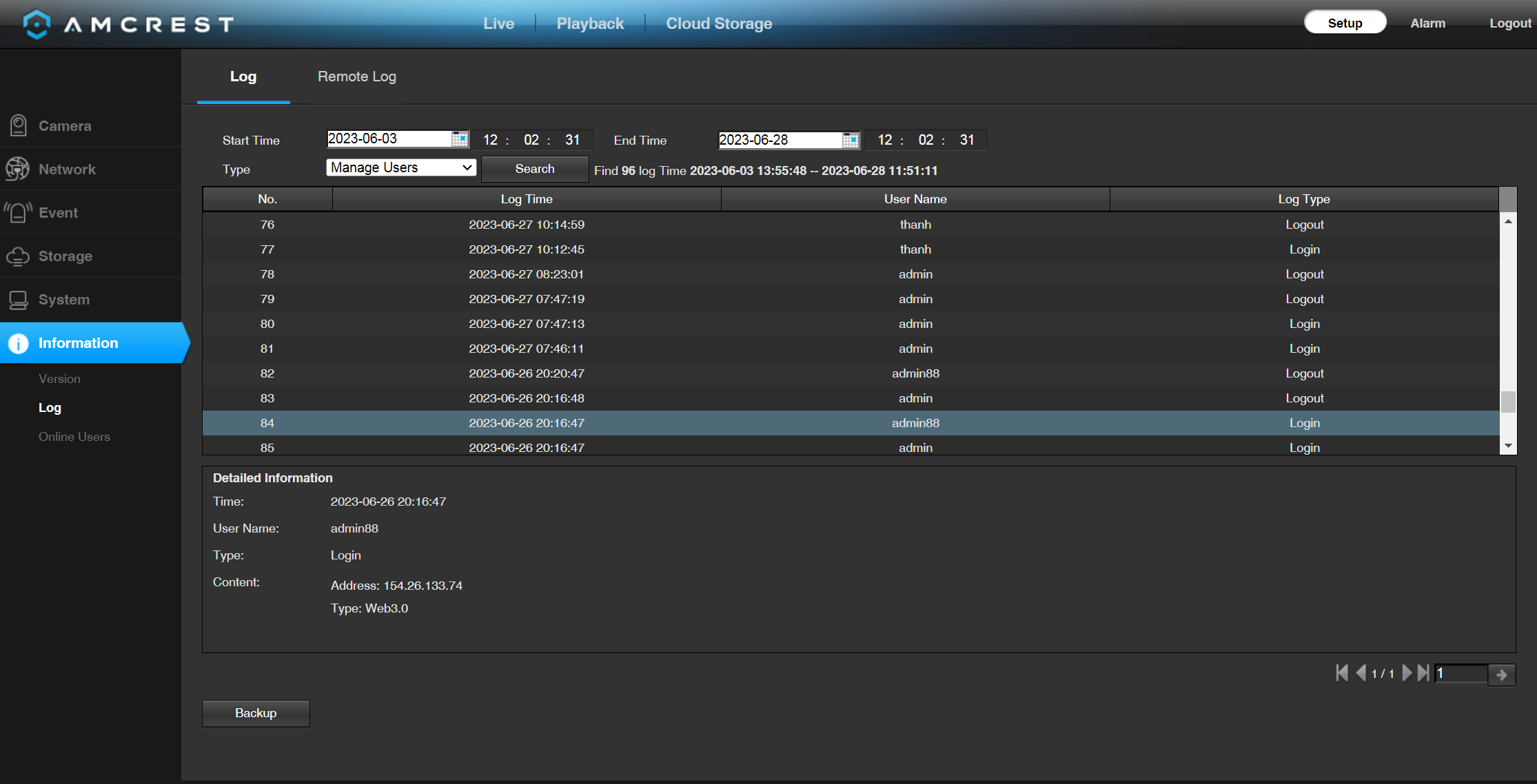

- The log has shown that "admin88" IP address is from the different country than my current location.

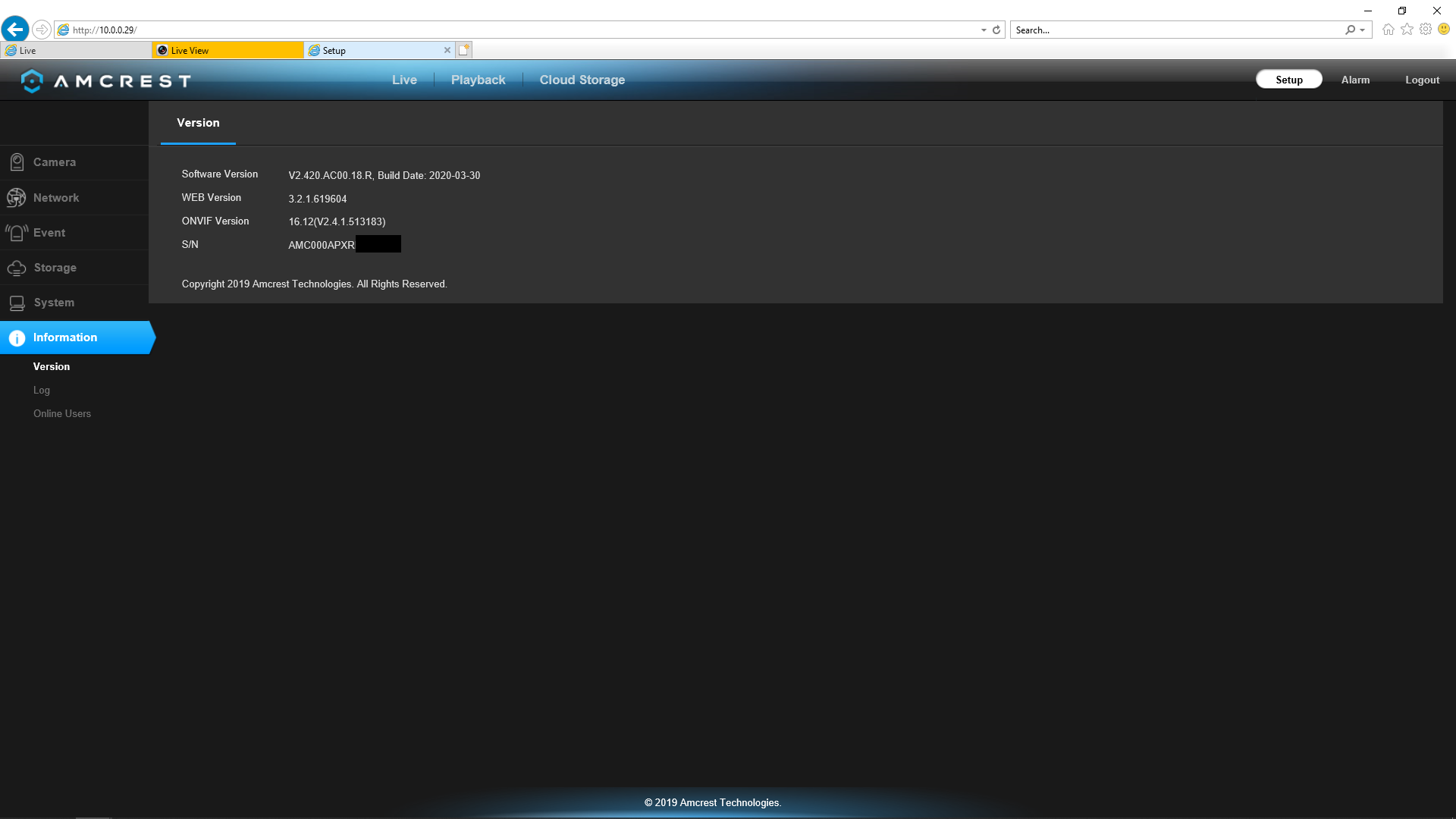

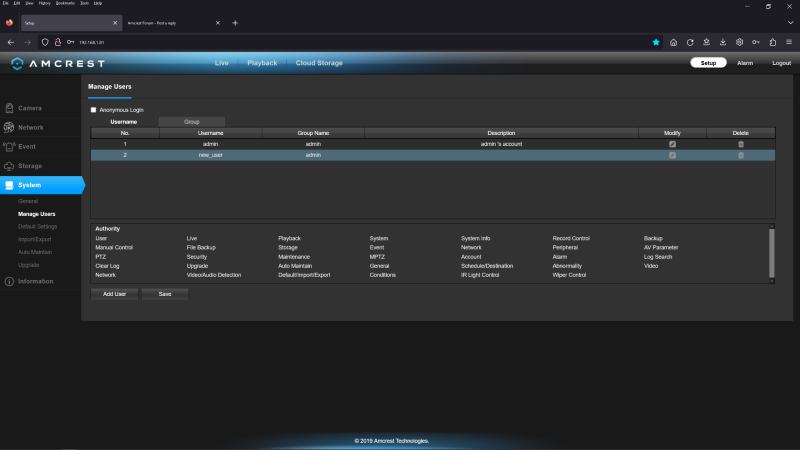

I've never heard of anything like this before, it sounds very suspicious and so I just downloaded a fresh copy of that firmware and installed it in my own camera.
I added a new user.
What I am seeing is entirely normal.

As I mentioned, I even tried soft/hard reset the cameras but user "admin88" will be automatically added in after a while.
I then try to login and manually delete that "admin88" user but again, it will be added back with in a month or so as seen in the log.

My own camera was also purchased from Amazon here in the UK. I downloaded the firmware just now from Amcrest website. I installed the firmware and did a factory reset.

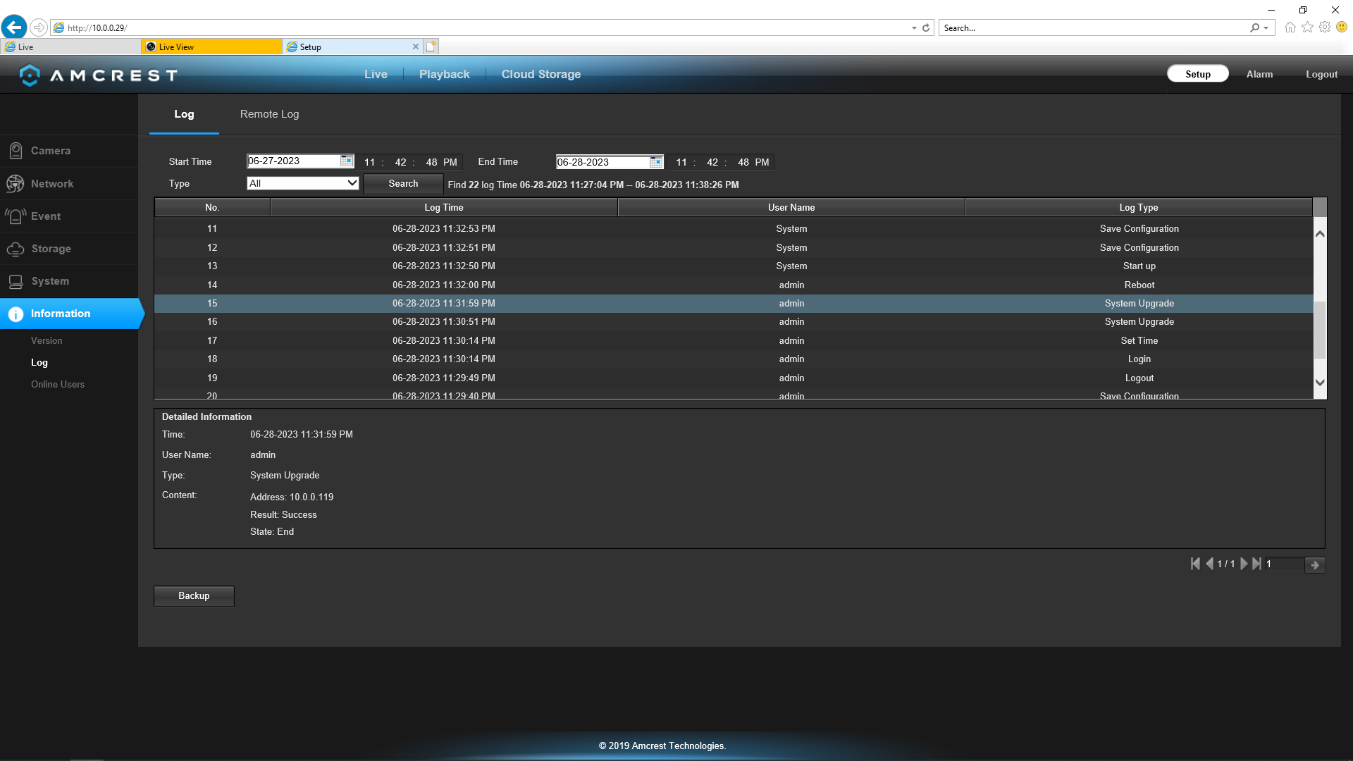

I don't know I have had one of my 841 online for over a year and I have no such admin88 added. I have no new user added and from the look of the log either that is your IP address or your camera is connected to the Internet and someone has access to your main password. They then make the new account admin88 is only thing that would make since of what could be going on. My camera is connected to my network and only has access to the Internet with P2P access as there is no one that could access my cameras from the Internet because I have it closed. P2P can get though and sure if someone has my password they could use ASP to gain access to my camera and make an account however they would need to know the password and the Serial Number to start out with..
There is a Ip address of the person that made a connection to the camera Off PSiNet from Washington DC. Either that is your Local Static Ip or one of the user that made the connection.
I would Downgrade to the 2019 FW, after it is done installing the FW, Do a factory Reset on the camera, then make sure you use a different password and check to see if you have same issue with admin88!

That Washington IP is different than my current location and no I will not downgrade the firmware due to the previous one with CVE audio vulnerability which Amcrest publicly admitted & patched.

Sorry but you might want to look at the CVE. The one they are referring to is the older 2017 FW for the Camera. The 2019 FW is new different and is now a 2.420 where the old one was a 2.520 FW. So the one that I said you should go to isn't the one in the CVE.. They wouldn't leave a FW posted on the web that has known issues...
Re: IP2M-841B backdoor admin88

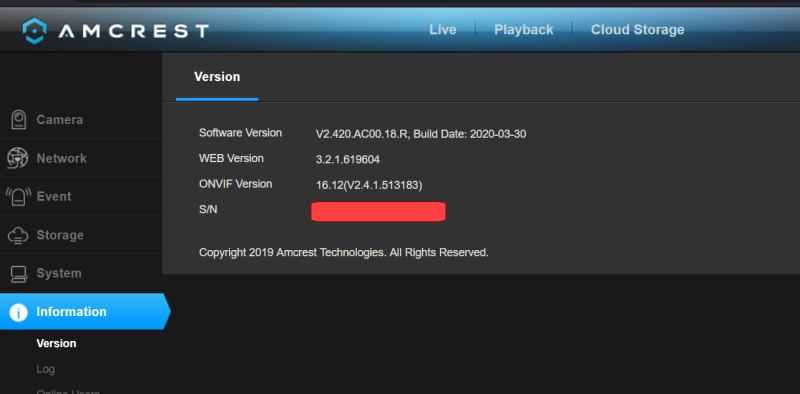

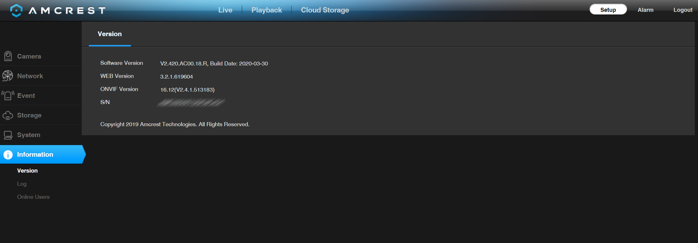

So I installed the FW again that I just DL from the website. I thought maybe there was something added to a different upload of the FW. So seeing my guess is that one that was there now is the one you are using (Not saying there was ever more then 1 just in case there happen to have been) I DL it again, Installed it again, and I will see if there is something special about it over what I was running...
Also while I don't have an admin88 and if you do have one showing on your user list then it would show up in this CGI. However after you remove and reboot the camera run this command and see if there is anything that is listed as admin88 in the file this kicks out.
http://10.0.0.29/cgi-bin/magicBox.cgi?a ... SystemInfo
Just change the IP for your ip and it should make a text file then do a search under edit aka (Find) and put in admin88 and would love to see what it is around in the file if there..
Opps sorry that is the wrong one
http://10.0.0.29/cgi-bin/Config.backup?action=All
That CGI will make a Text file in mine there is admin and admin2 that is disabled
