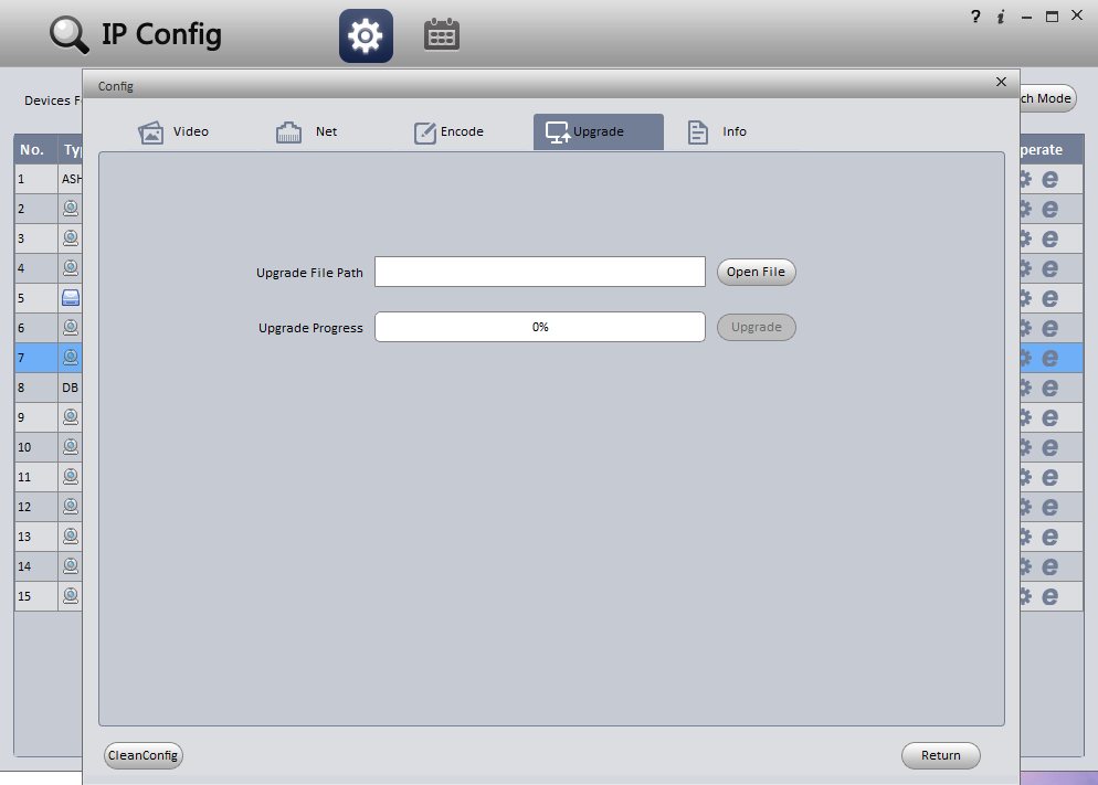

Hummm wow that is odd issue... Also an Odd FW package as well... That is showing FW of the camera shared with the 720p camera.. I wonder if the issue happened when the FW was installed.. Have you tried to install new FW from 2019 or 2020? WHile it is JS FW once installed it is not a good idea to go back to older non JS FW..
I do have a 841 that is on the 2017 FW from 6-29-2017 and I am wondering if the FW your camera is on was why they changed from the 2.420 over to the 2.520 for the 6-29 FW package so they knew it wouldn't be one with your issue loaded? If you use the IP config can you log in camera and see info using the tool?
Load IP Congig, CLick on the camera your having issues with just to high lite the area for the camera at the top of the page there is a log in button click that and put in your user and password leaving the rest the same unless you changed port.. Then see if you can get to that info that way? IF you can I would update the FW for the camera and see if that fixes the issue... I am going to guess that will be what Amcrest will have you do to try and fix this problem is Update the Cameras FW..
You can find the FW updates here https://amcrest.com/firmwaredownloads

Hi James, I have good news.
I have followed your instruction, downloaded the correct FW for IP2M-841 International version V2.420.AC00.18.R.20200217 for 841B (cam2) and 841W (cam1) and installed FW on camera (2). After rebooting it I can access the Web UI for this IP camera 2 successfully. I have also upgraded the FW of camera 1 so all is good.
Thank you very much for the advice and also the patience at troubleshooting this issue. It is now resolved. I really appreciate your assistance.

I am having a similar issue with my IP2M-841 camera. The camera works fine - I can see the Main and Substream feeds, but not able to login to the Web UI.
How did you update the firmware if you were not able to access the UI?
