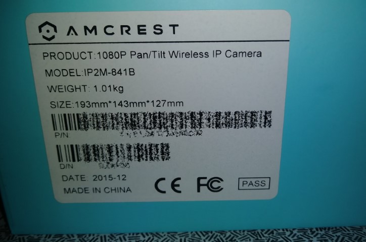

Hello and Welcome to the Forum @StratRider Could you let us know what the Silver Sticker on your BOX has for a Date? Not the Copy Right but on the Blue box the camera comes in there is a silver Sticker just wondering what date is on there?

@Revo2Maxx the date on the end of the box which has the serial #'s and such is 2015-12

@Revo2Maxx , yes the white label I am hoping to attach here and I bought the cam brand new from Amazon ordered on 8/26/2019 and it came with the most recent firmware at that time, which I have updated to the current most recent. It had this bug / feature with both firmwares though.
