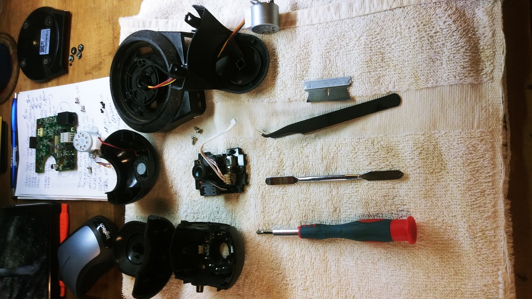

Piece o' cake if you're careful and patient. Getting it back together correctly may be a different story. LOL
(Thanks to Revo for providing some tips and instructions!) ;)

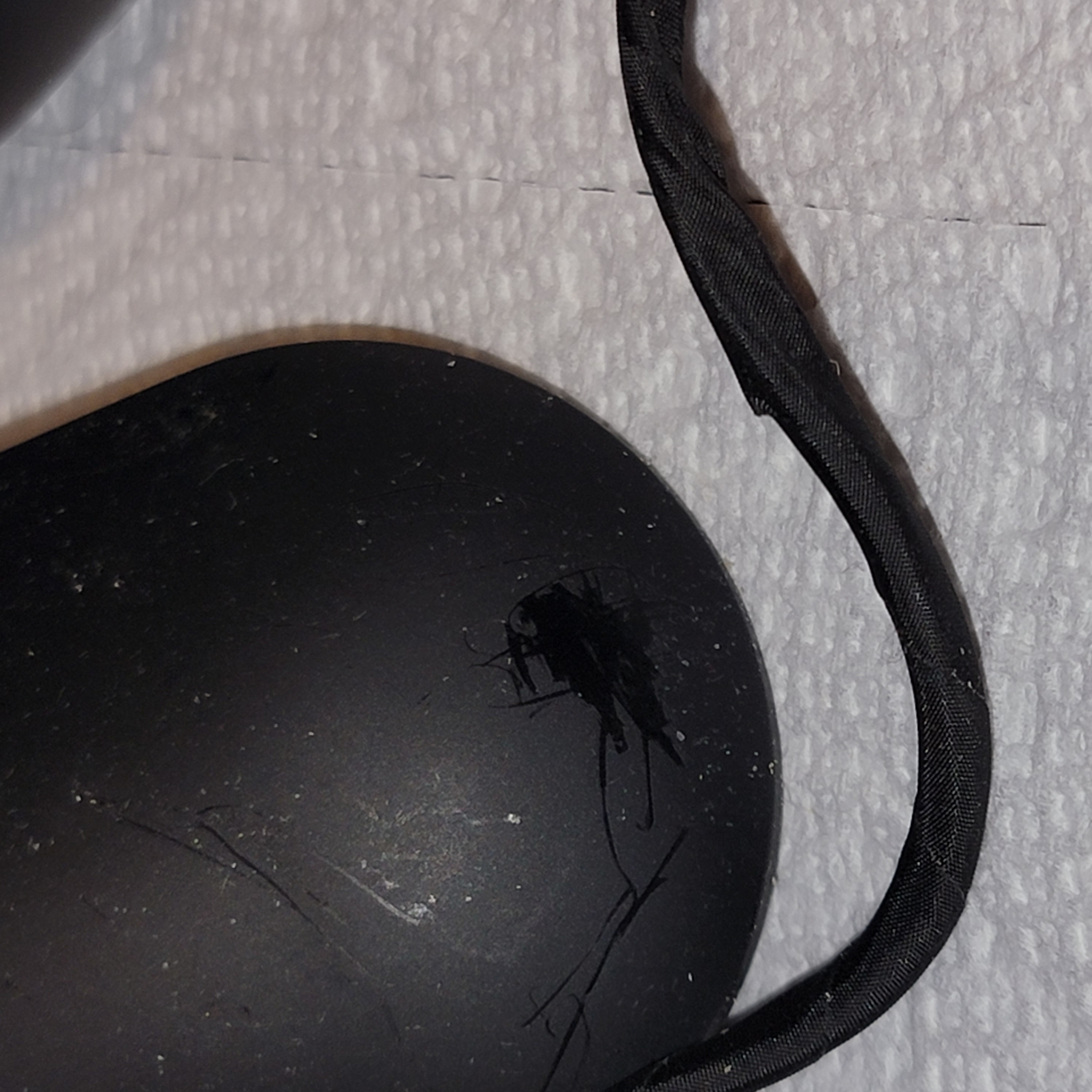

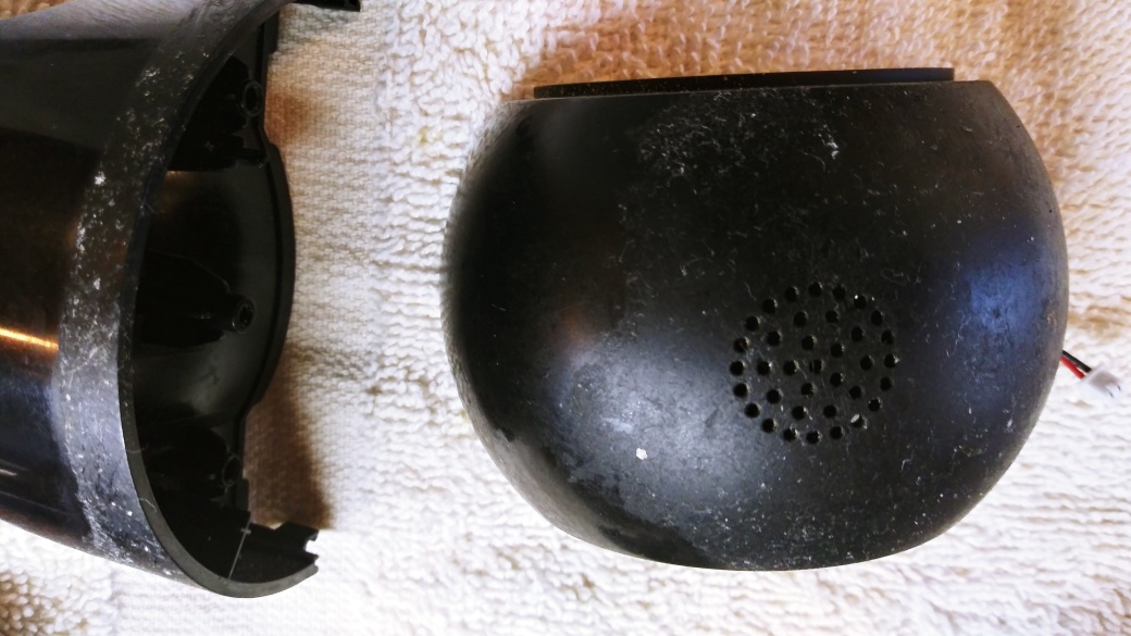

Picked it up super cheap along with an IP5M-T1179 (that is now a Dahua). It was used outdoors in a sheltered area and covered with goo-like sap or just suffered from plastic degeneration over time from heat or both..., or who knows what else. Absolutely nasty whatever it is.
841 Goo.jpg (182.15 KiB) Viewed 11556 times
Pure alcohol is the only thing that seems to be effective without risking lasting damage to the plastic as would lacquer thinner or brake cleaner. I think it will clean up nicely with a little work.

Tried IPA on one of mine made it worse lol Normally alcohol is bad on most plastics. Let me know what you end up with, have a couple that I will either convert to white or keep them where they are not seen lol. Most of the bulk buys for parts seem to be black.

A lot better and probably good enuff for the boss to allow it in the family room now.

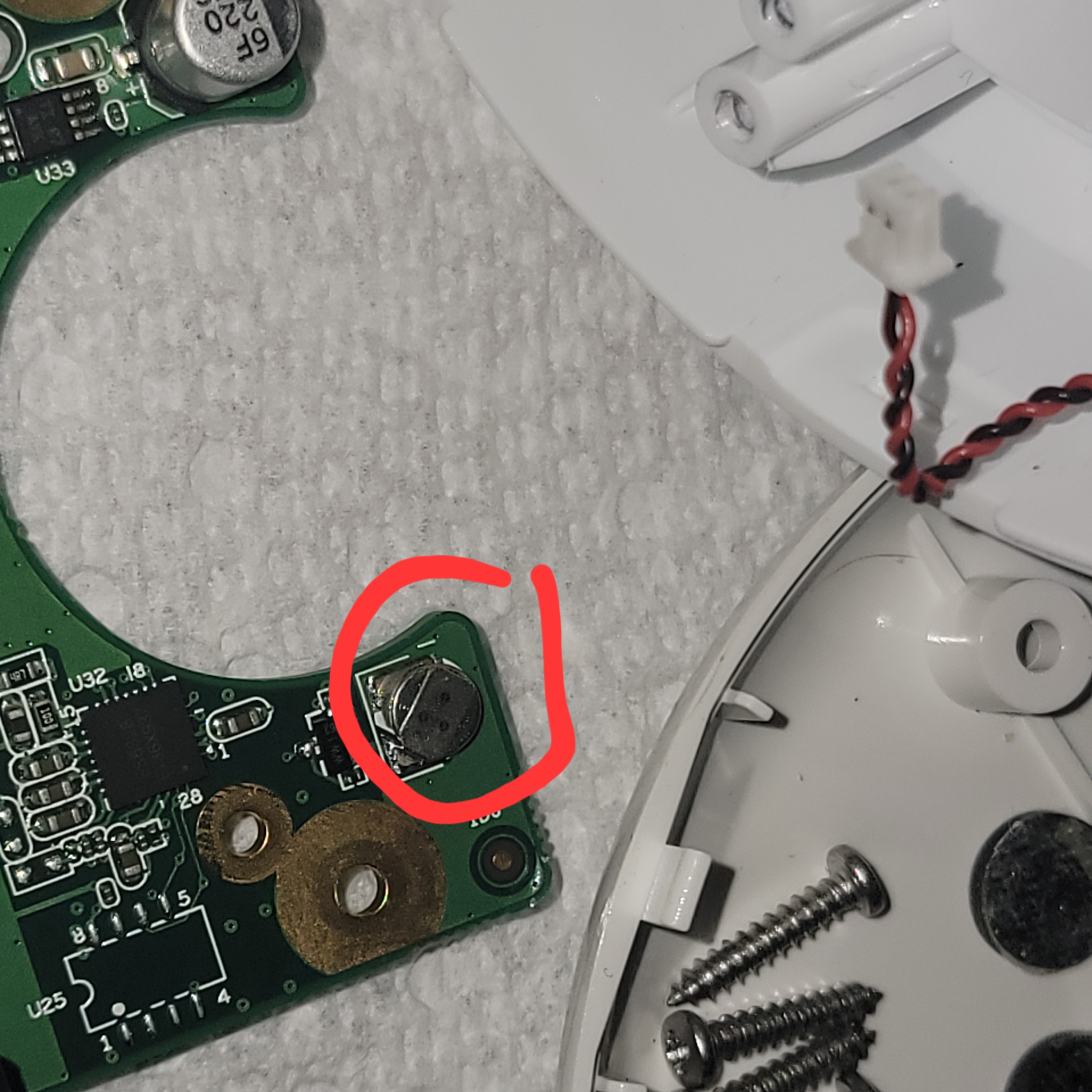

Did you happen to notice the Clock Battery? it is on the inside of the PCB where the ribbon cable is.. Marked BT1.. If the clock is ever off after reboot and don't have the system setup NTP or NVR setup to set the time it will be off until set.. Still can't sorce the battery lol.. So on the ones I need I just put in a small pack battery in its place..

Interesting.. I just revisited my nasty Black camera that I tested on the base with what I thought was IPA but must have been some of the Diluted solution that I use for a different flux clean up lol. Because I just tested pure IPA from a new bottle and that top layer does come off down to a gloss plastic like the White.. Not really sure why they had that put on to start with.. But nice to know that it will come off..

Thank you @Pogo if wasn't for you I would have just kept this camera on my basement stairs away from sight of others but now my ugly duckling don't have to hide anymore lol Yes this camera is VERY OLD.. If you look at the date stamp of the Stepper motor you can see that was built in 09-09-2015, I have a few older 841s then this one.. They are nice cameras even if all the cameras I own have dead clock batteries besides the few that I added in a battery pack in the place because they are behind a firewall without internet access so no way to update time in the current location. The new camera I got for the new Release of the 2019 FW also had a dead battery out of the box direct from Amcrest.

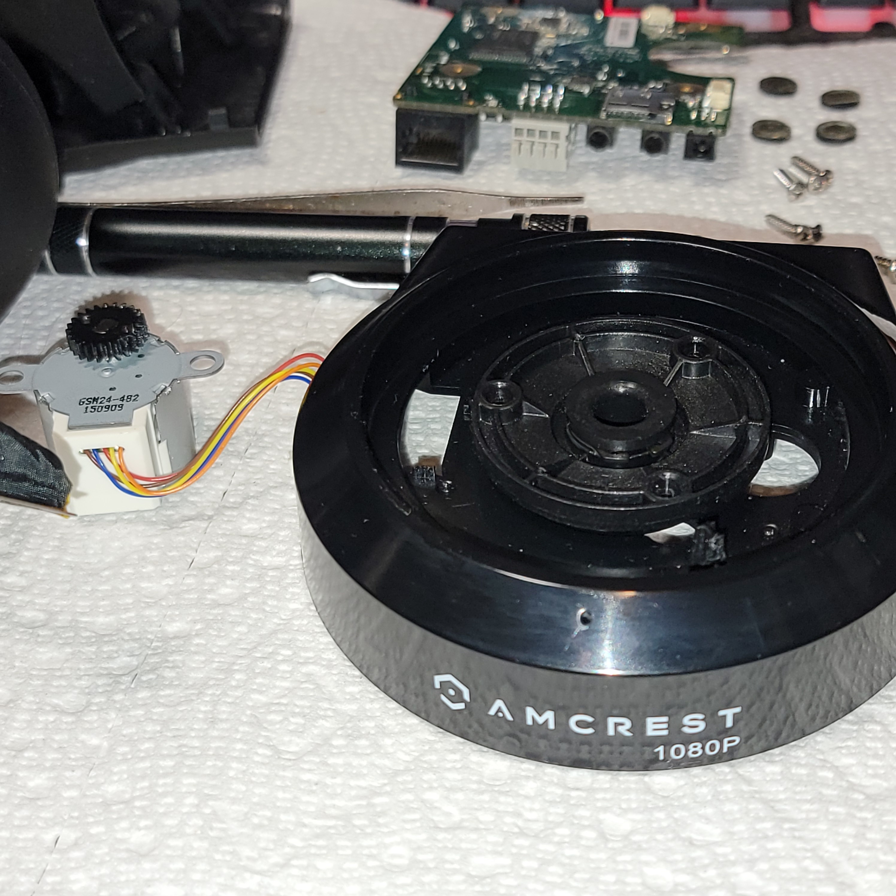

The ribbon on the board was slightly skewed and not all the way seated so I corrected that. Unfortunately it still exhibits the weird behavior so I'm back to total disassembly for investigation of what else I may have screwed up..., starting with the other end of the ribbon connection.
I may have also mounted the turret incorrectly as there seemed to be some type of motion restriction with pan and tilt before the camera just shut off like a connector popped loose. (Hopefully that's all it is!)
I'm not liking the possibility of the other ribbon connector being installed backwards so am hoping I may have just not seated the retainer securely enough. I took pics of the orientation, but still may have screwed it up.
Question: What is the default rotation routine before it stops at 'home' when it boots up? This one goes to the left (clockwise when sitting on the base) until hitting a stop in the turret base (seemingly prematurely) pointing directly backwards and then returns to a normal forward looking position. Something doesn't seem right there.
I'd hate to have toasted this thing after being so meticulous and putting so much effort into it!

Back in business. I'm not sure what corrected the image problem but assume it was by reseating and securing the ribbon connector in the camera head.
While trying figure out the rotational restriction and tilt snag, I realized the turret assembly was actually backward to the range of rotational motion since it was stopping just left or right of directly forward which logically seemed like it should be directly opposite at the rear.
Figuring out how I managed to do that took some head scratching, but it ended up with the camera head being situated both backward and upside down relative to how everything seemed to be designed to work. I also discovered the rotation motor gear was not properly engaging the turret gear and was lucky there wasn't any significant damage there.

First not had the issue with being in wrong.. I guess I should have mentioned the issue with the pan gear. Not easy to tell but when you put the gear back in, need to keep an eye on the gear placement. The motor don't shift enough to keep it where it needs to be and if it is not held with good preasure while installing the screws the motor can be secured in wrong. While I have not done it, I have looked at the ability and how it might not be secured right and know that I take extra care there to make sure the scews are returned with the gear in good placement..
Next, When you go to remove the top of the base it is best to position the camera with the lens facing the front of the camera. This way when you add everything back and install camera top back to base you know that it is going in the right direction. Plus that naturally the way the camera should be placed to remove the screws securing the 2 parts..
