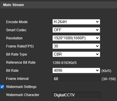

This 840 will not retain a 30fps setting to save its ass with any of the settings combinations I've thrown at it. It will run beautifully at 30fps/4096bps all day long but revert to 720 after a reboot every time.

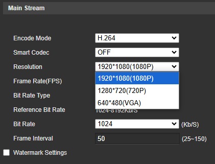

It actually appears to be the default setting in the camera I have. Fresh power up is 1280x720 / 25fps / CBR / 1024Kb/s / Frame Interval 50
I'll need to sharpen my OBS skills to compile a screen capture covering the entire sequence that leads to the actual issue in real time. Not sure I'm up for that tonight.
Any chance the firmware itself may be auto-compensating for the lens as it boots or is reset? I can obviously force the change once it's up and running. It just doesn't like it from a fresh start. The reason I ask is because when I initially put it back together after cleaning and had the ribbon cable connector issue, it displayed some pretty strange settings and options that were anything but standard selections -- like defaulting to 4fps with a bit rate of like 20 or something. It recognized things weren't right then, maybe something similar now with the struggling lens?

A reset defaults and successfully saves to 1080. A reboot reverts to 720 every time.
841 Reset Default.jpg (34.29 KiB) Viewed 7605 times
841 Main.jpg (34.2 KiB) Viewed 7605 times

Well I am not sure, It is something new to be honest. I remember when the first 2019 FW was released and with all the issues that others had I don't remember anyone with the Format change of the camera it self..
With your camera and adding the ribbon back it might have shorted out something in the camera boot section that detects what the camera is after a reboot. I mean I am sure the camera runs a bootloader after power up or reboot and has some things in the system to check for different things along the way and if something fails to load as normal to then load as something else to keep the system able to keep going without the program hang..
Something to try. Once the camera is running with the correct settings you want them to run at. I would update the camera again with the Firmware you are running and see if that cures it. Maybe just needs a reflash of the FW..
