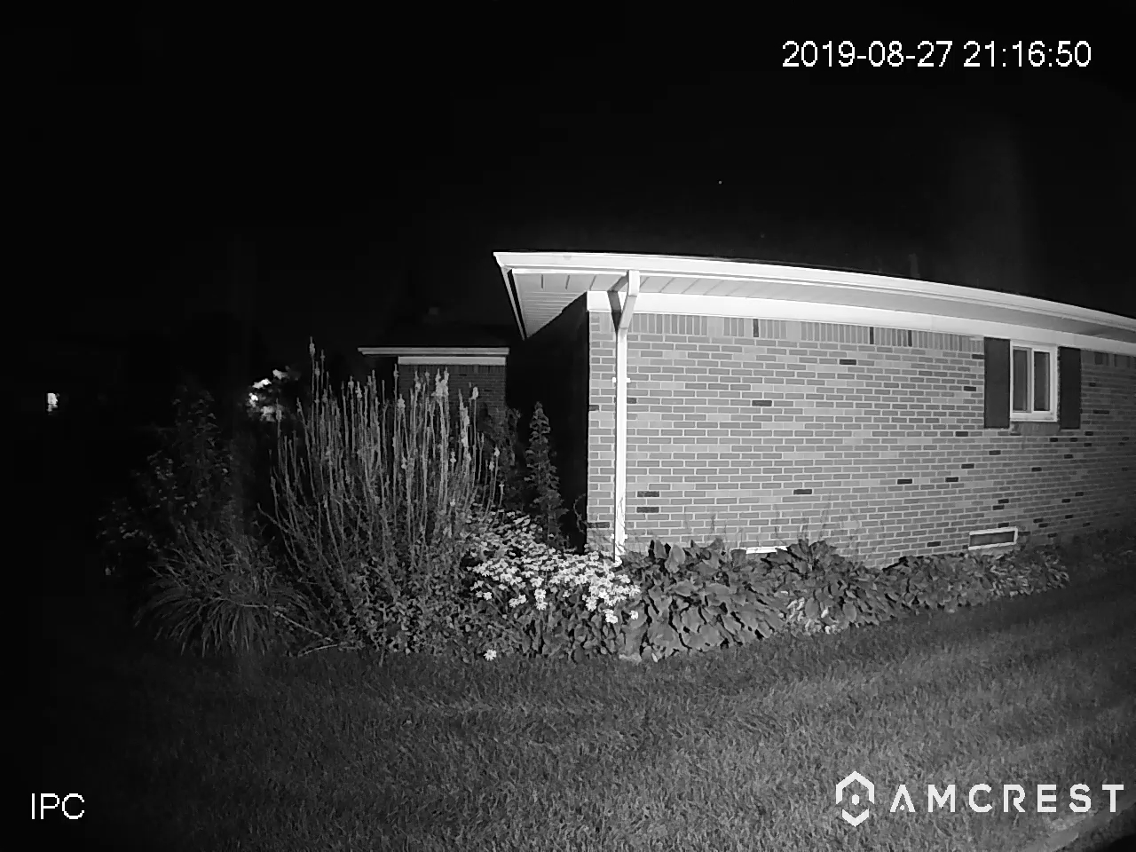

Re: IP3M-HX2 vs IP2M-841 video noise comparison
I have attached the images from H1X and H2X taken at night using bright LED lighting.
H1X image is far superior in clarity. See how sharp the tall plant is and how sharp the leaves of the shrubs are. HX2 image has a haze everywhere. Of course a picture is worth a 1000 words.

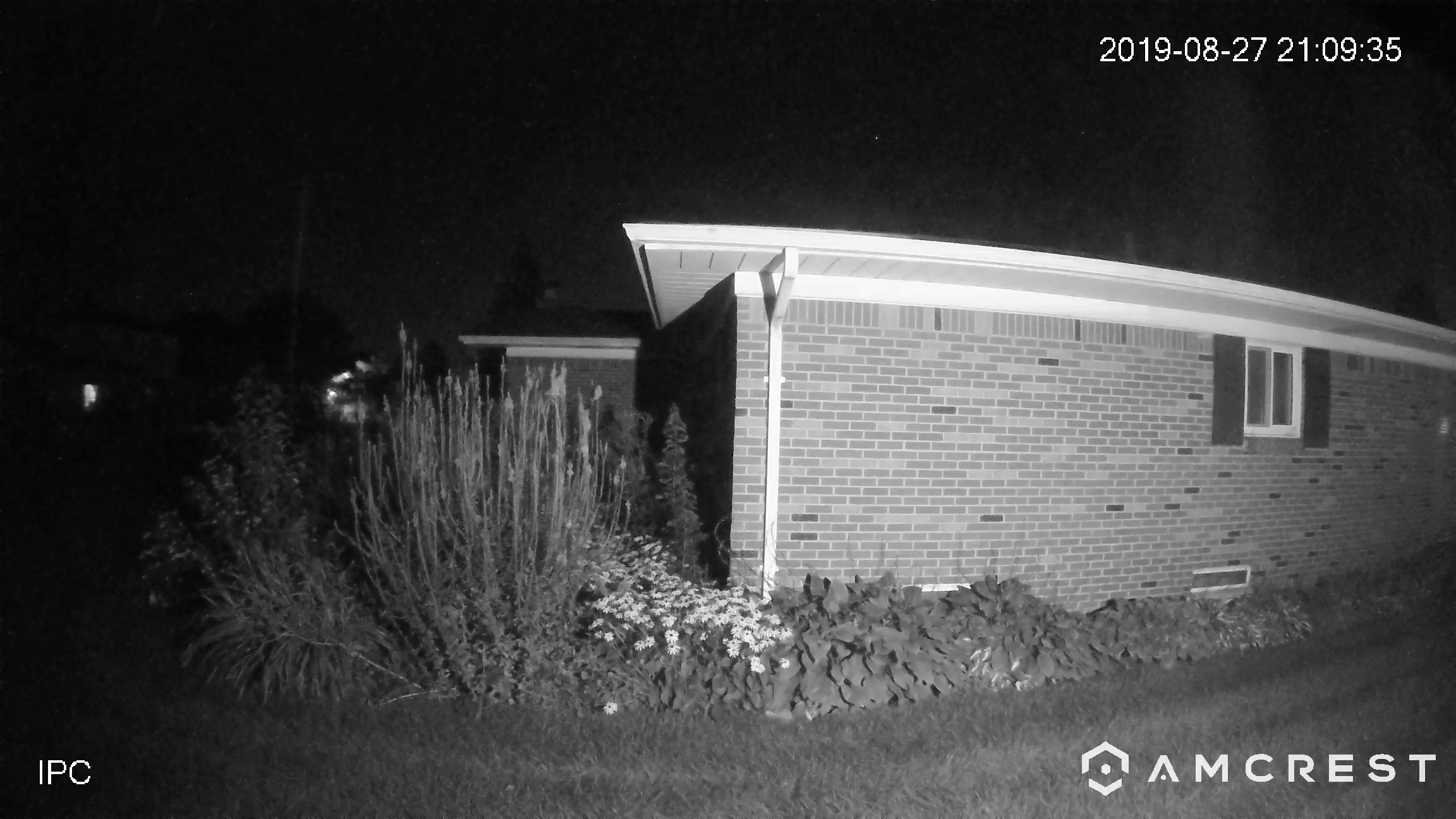

Yes the HX2 is setup to highest possible image quality. They are both on wifi. I have tried wired also. H264H or H264B or H264 didnt make any difference.
Here is the image from IP3M-941W. Of course it will be a lot zoomed in as it has a smaller FOV. I feel that the HX1 is sharpest of the 3
- IP3M-941W.jpg (889.65 KiB) Viewed 1734 times

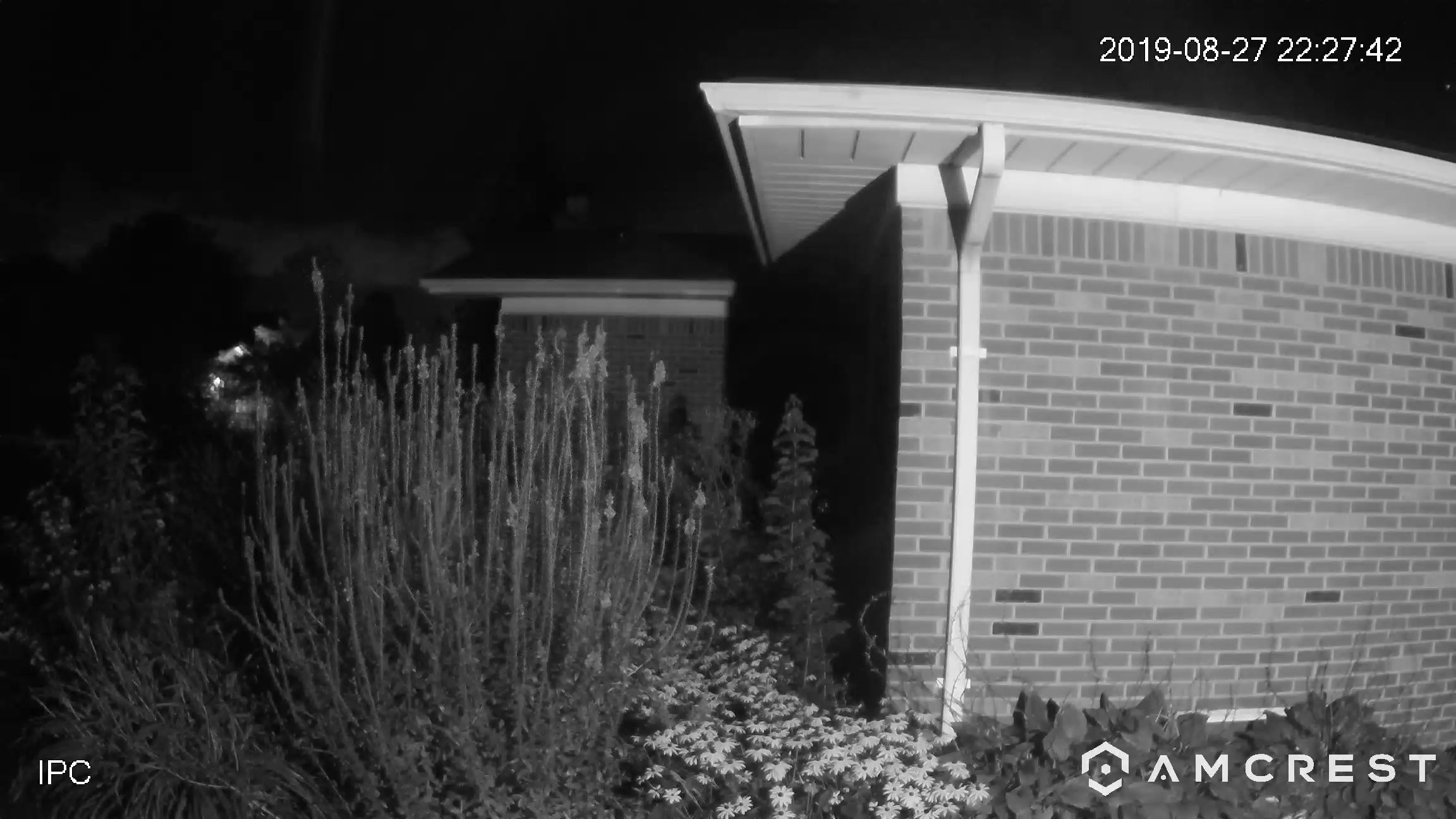

HX1 image is sharper than HX2. Why?
You can go to the thread given below for some background.
Basically HX1 image is a lot sharper than HX2 image, even in bright light. This problem was reported way back in 2017 by the OP in the other thread but no one responded to that thread. May be ge got the RMA and so didnt care to pursue. Instead of just reviving a 2 yr old thread which is not going to get any attention, I started a new one.
https://amcrest.com/forum/ip-cameras-f1 ... t3042.html
I have 2 HX2B's, a HX2W and a HX1B. I didnt realize that the HX2 image has so many hazy spots until I bought a HX1 and looked at the images side by side. See images attached.
I dont think this is just one random case or a defect. The OP of the other thread reported in 2017 and now I have 3 HX2's that have an image a lot hazier than a HX1. I would like an explanation as to why a lower res camera can have a better image.

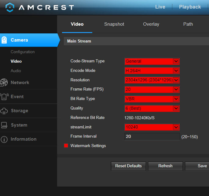

Re: HX1 image is sharper than HX2. Why?
Your screenshot shows the video encoding settings and I don't think that's the place to look.
I think that any improvements that you can make will be in the camera/configuration settings for each profile normal/day/night particularly the sharpness and contrast although I'm sure you have already explored those settings

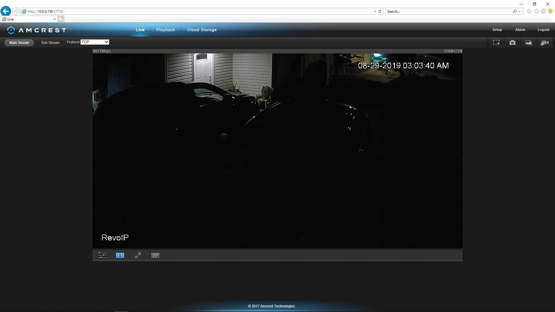

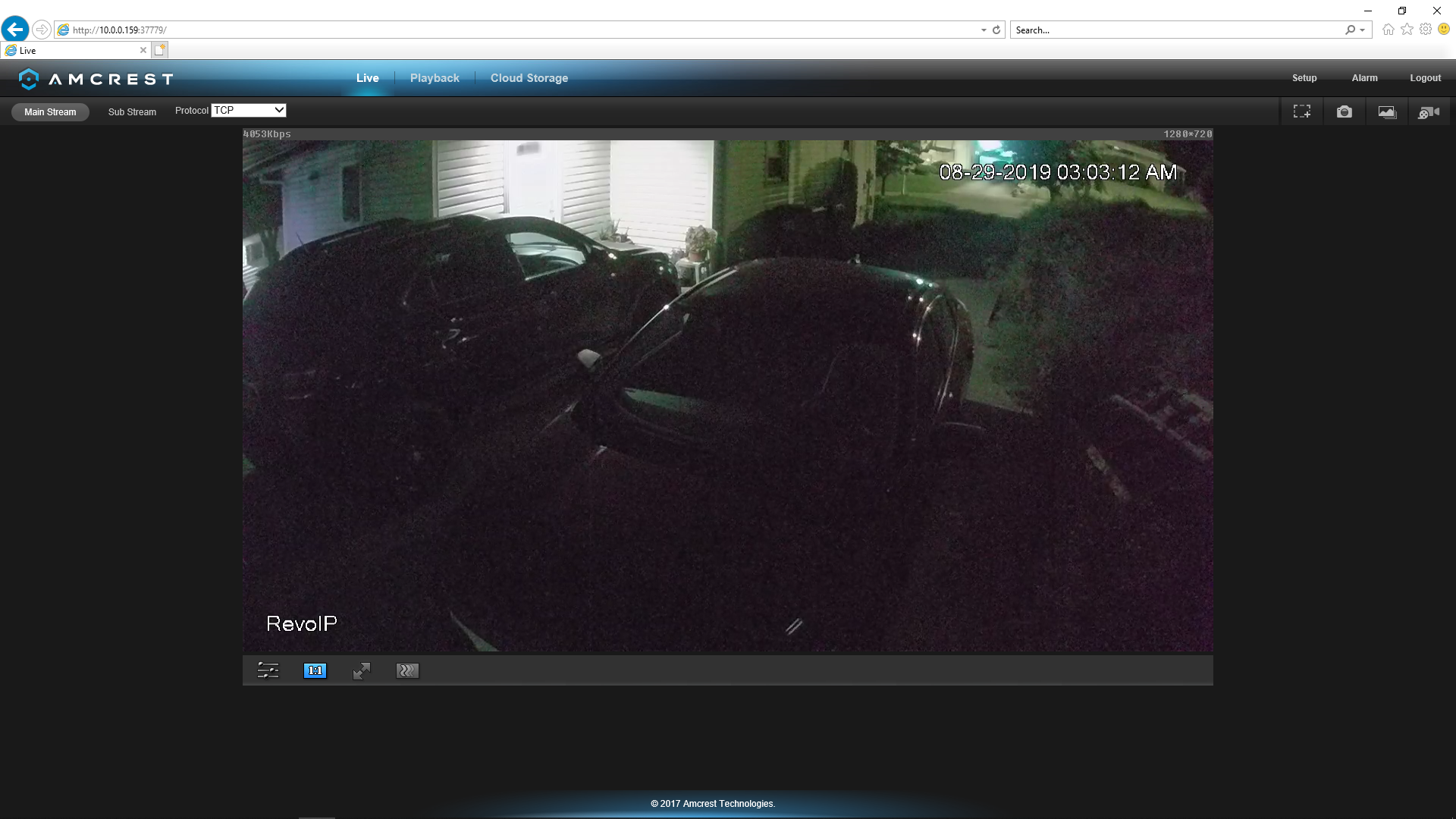

So while I don't have your camera I do have a 1.3Mp camera that I use at 720P.. I have Multi cameras doing double duty and so some I have set for Color at night only with Options that let me see what i want to see. While other Cameras are doing same View with Different Settings to get what this camera I am going to show you... In the first Picture it is with WDR turned on. While WDR can be a good setting it isn't how I want it. The second Picture is with HLC on and that is what I want and how I keep This Camera. Also I am not going to Resize them and even a screen shot with only changing the settings and does show more in the picture doubled picture size as well. One of the Reasons I run this mode with this camera lower space used at night other cameras catch the full view of the SUV and Car... This is mainly for Door and Plate capture of someone pulling into my Drive...
Sadly I think the H1 has a better Shutter speed then the H2. While the Hx1 has a f2.0 and the Hx2 has a f2.2 I think that will play into some of the factor. Also the Fixed lens plays a little into this mix as well... One of them is a Fixed 2.8mm lens where the HX2 is a 2.0mm Fix lens...
Sadly Both of the cameras have loads of settings that I can't see in your Pictures. Video Quality isn't going to help as longedge had mentioned with Picture Quality....
So one of the things I would try is make sure that all the settings are set the same for both cameras.... One of the main reasons I LOVE my DVR's is because if I don't like the way my cameras look if I make changes in them I can do a Reset without having to worry about changing IP and setting up Passwords again lol But TBH and fair I would Reset both Cameras back to normal or factory encoding if that option is there. Meaning if there is a way without having to reset the Whole camera back...
