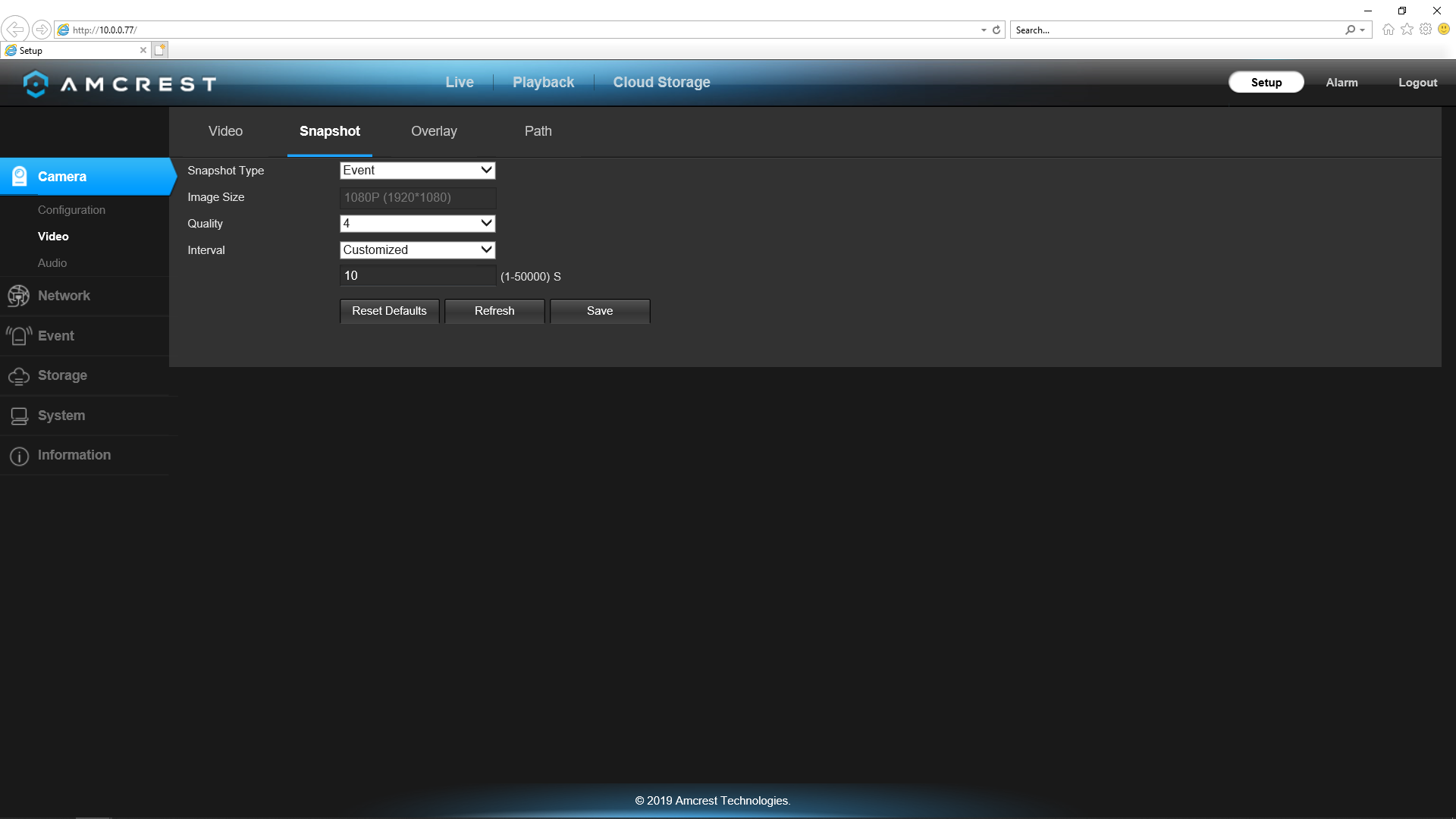

So I have some ideas as I was setting up the One with new FW V2.420.AC00.18.R, Build Date: 2020-02-17
I just thought of something. I did a Reset of the Camera back to factory, I setup a new Location because didn't like the one it was in, I setup the mail server info, I got my test message. I then went to look at the info in Motion, Setup a grid, Noticed it was setup for 0 LOL Ok that is odd before I changed them all to 0 this one was factory reset and at 0 go figure..
I then went to camera to configure the snapshot area under Trigger (Event) that is important.. Then found where I think the issue is. That needs to change from default 1 second to something outside of that. In your case maybe you wanted 10, so setting that to 10, your still going to get 3 images every 10 seconds on a per Trigger for motion
Screenshot (1732).png (144.95 KiB) Viewed 1117 times

I can try what you are suggesting but how does snapshot frequency effect email alerts ? Please let me know.

Re: Excessive Alert Emails
Well I am doing images, I mean I guess if your doing video or live view but from what it sounds like that you were talking about sending your email images?!???
So in that case when your sending images it will send the 3 and wait 10 seconds before it would send out more if there was more motion event to reports I mean correct me if I am wrong but that is what your trying to do right? Keep the numbers of images down?
Sorry I guess I miss understood what your trying to do
