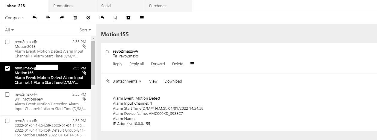

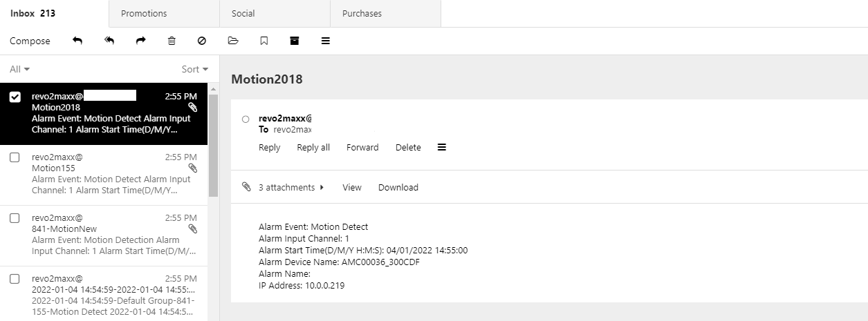

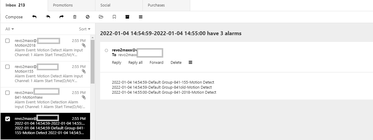

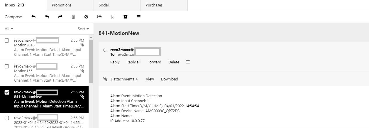

ASP sending email as 1
Screenshot (1735).png (51.49 KiB) Viewed 879 times
Screenshot (1736).png (49.25 KiB) Viewed 879 times
Screenshot (1737).png (50.83 KiB) Viewed 879 times
Screenshot (1738).png (50.75 KiB) Viewed 879 times

Well I don't know if you have done a reset or any other thing that I offered as some things to try. I can tell you that after my 3k emails today alone I am pulling my testing.
Only 1 time did I think the NEW FW was going to have an issue but come to find out it was because of the position of the camera it was getting the flashing of the 4ways before the other 2 cameras as the truck was rolling to a stop. The 2020 FW had 2 emails that the other 2 didn't give over about 30 seconds time. Then all 3 from that point on for 10 minutes while that truck was parked there with flashing lights on just at the Grid line (No motion outside of the lights flashing into the grid zone) after the truck left all emails came back as normal. I know your thinking 3k emails that is a lot however that is around 725 emails between 3 cameras and ASP sending for the motion in there as well. Then the rest was some other cameras I have setup for motion email in ASP in a different area it has been very windy today so 2 of my other cameras had some motion of leaves and animals that I got emails for..
Outside off all things in my testing there was a point about 3pm today I wish I would have had 2 emails on the dual event and only got one. Starting into the scene was human, then a truck and I got 1 picture of the truck and 2 of the human, In truth looking at the feed on my Amcrest 7108-AI that I have running in SMD mode for that channel I thought the human should have triggered another 3 pictures however in the time they left the grid just as the time was up and only small part was left in grid and not enough to trigger an event.
All in all 722 emails from 2020 fw, 727 from the 2 other cameras with the rest of the emails as I said from ASP.. Oddly the 2020 fw didn't pick up a couple of motions that I am guessing was caused by the color of car and the position of the camera. Or it was just taking a nap not sure but I did look at all the cameras pictures and most of them are really close to pictures emailed.
For people reading this I am not sure everyone knows how these cameras work. Seeing they are all on Reset settings for Frame Rate and Bit Rates of 30 Frames and 4096 for the 841 on a fresh install. That means in a 3 second period there are 90 images taken. When you setup for pictures of 3 out of 90 images the camera is passing in email or on some recorder only 3 of them images..
