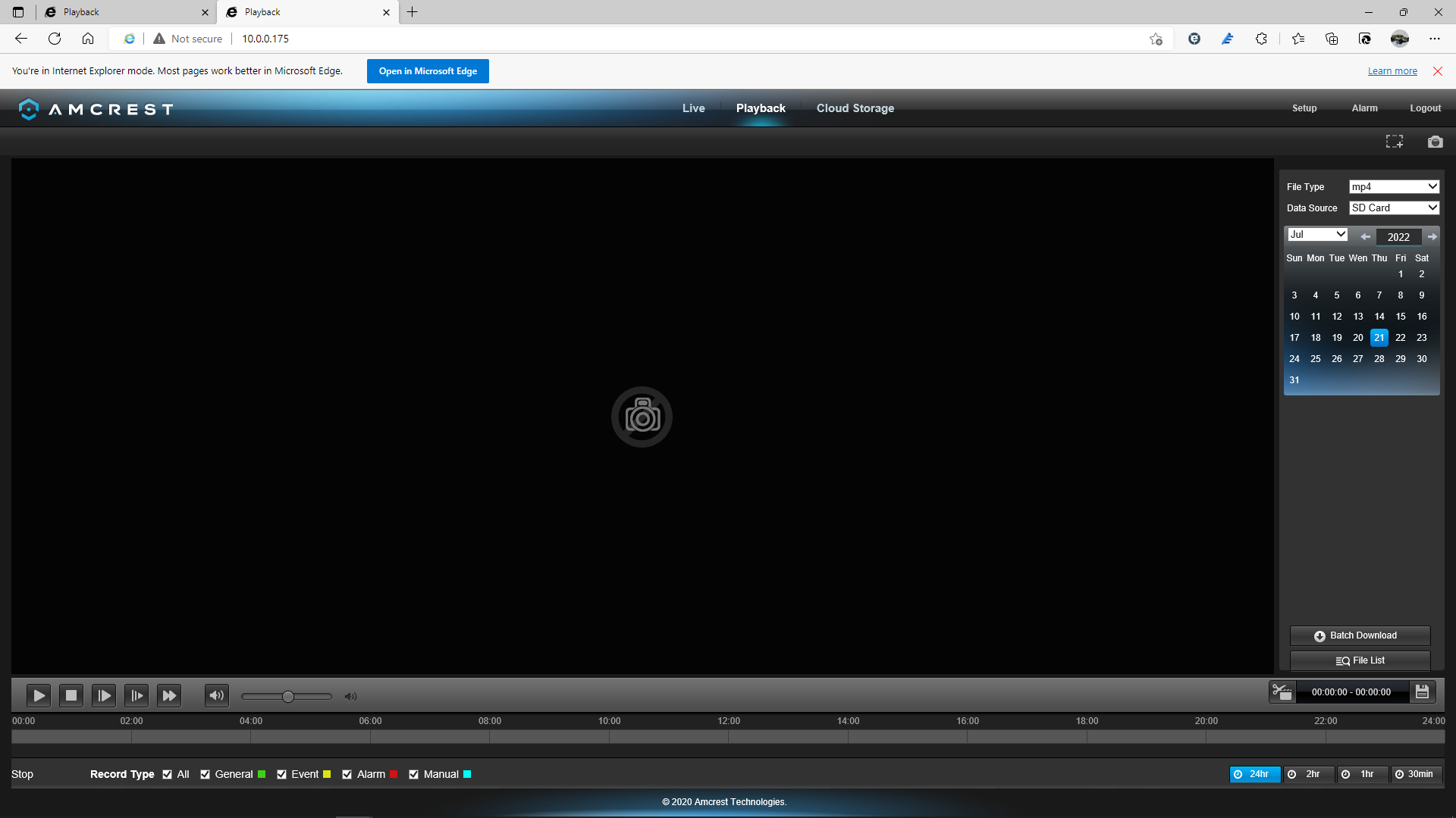

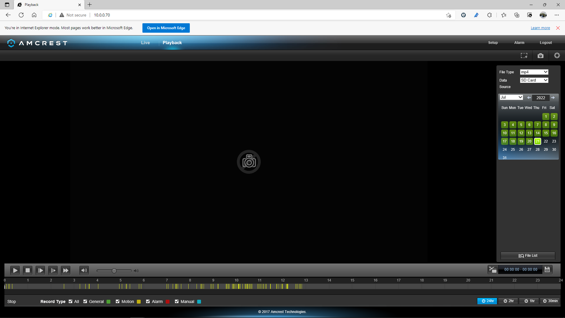

Well there are 2 things thing. One your using Edge without using IE mode. Looking at picture below you can see what it looks like for IE mode in edge. OR second it might be that your FW no longer has the Timeline So I don't have a 841 right now with Msd installed so I can't look however my 841v3 that was made for Chrome normally does work in IE mode on edge and there is still a time line in there. In Edge without IE mode no time line. I did just format the 841v3 early AM so there are not current files but showing for time line
The picture at IP 175 is the V3 841 and the 70 is my Amcrest 850EB with 128gb WD Purple cards.
Screenshot (2672).png (149.67 KiB) Viewed 1175 times

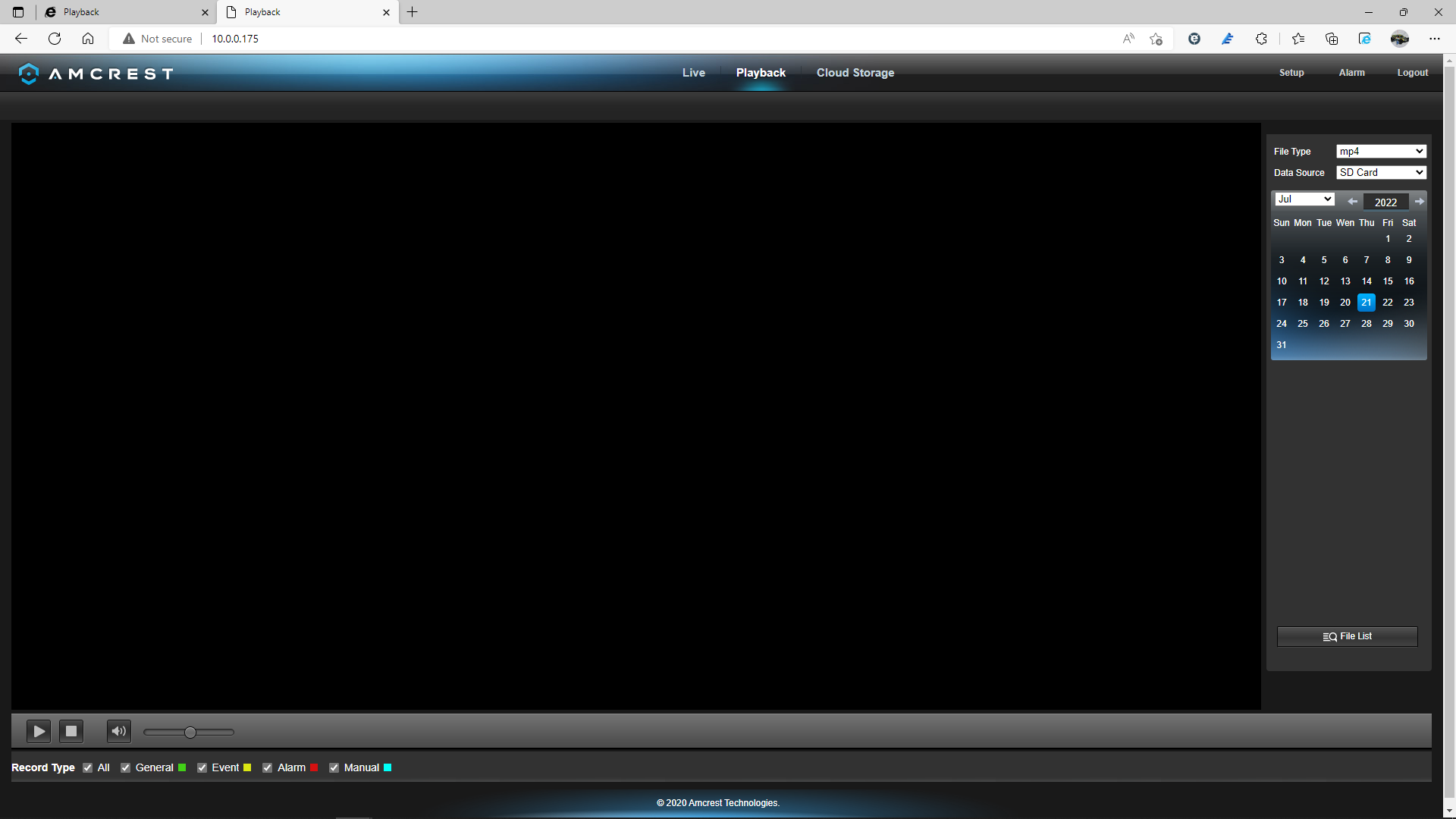

Re: Error accessing SD card recordings after firmware update (IPM-721B and IP2M-841B)
In Edge normally..
Screenshot (2674).png (127.98 KiB) Viewed 1175 times
