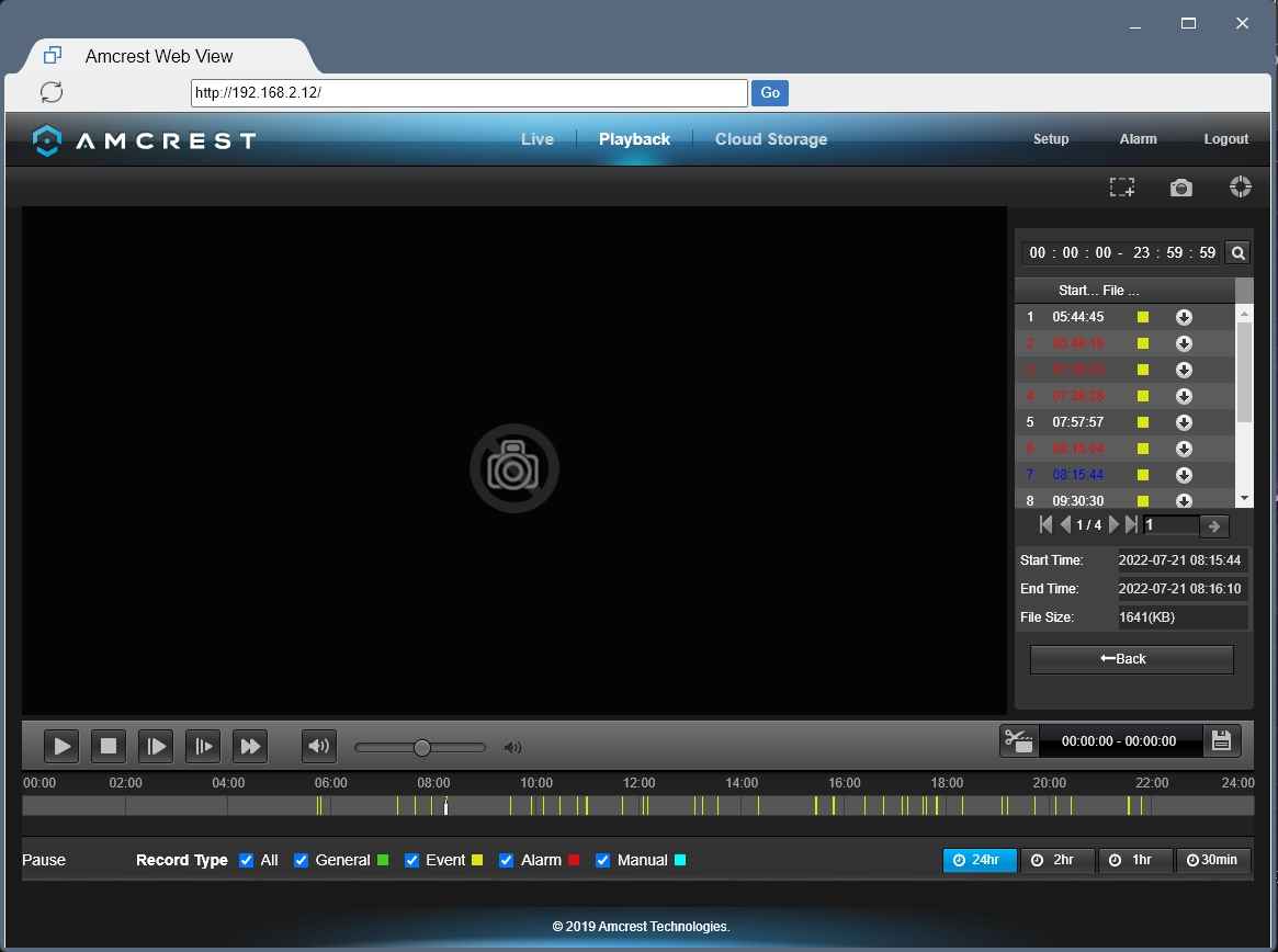

That's interesting. Of course I tried it out immediately.
The browser also shows me the timeline, but it comes the message "IE no longer supported. Please use Google Chrome " and no recordings are shown to me.
With the Chrome extension everything is then as it should be, but the error described in my first post happens.
By the way, on the following photo you can see that e.g. the red marked shots are not considered in the display.

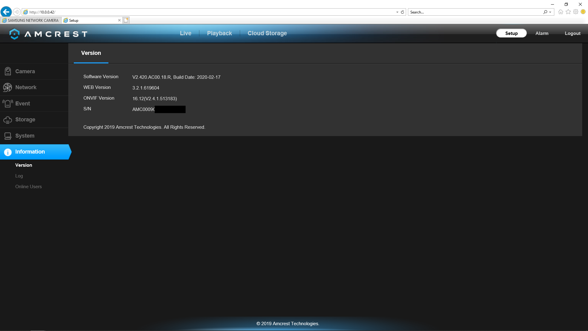

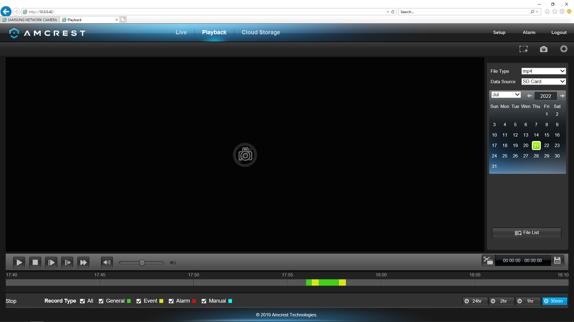

So I had to search but found some of my 841's with newer FW on it as I said most of them either are on older now or a couple of newer just some of them are on POE NVR's so I don't have cards and it was a PITA to find one.. What I find interesting is I have a 841 that does work on both IE and Chrome and when I went to look at the new FW on the page of FW at Amcrest the one I have isn't even listed they only have a newer one and the one from 2019 and sorry the 2019 one is Problematic to start with... Now because of all my POE cameras I needed to update some of the MSD cards I wasn't able to find one with a card. All my POE cameras are not easy to take down or remove MSD so I took the one out of my Amcrest Car Cam and installed in this 841. I would maybe contact Amcrest and see if they can send you the link to V2.420.AC00.18.R, Build Date: 2020-02-17.. There might be a reason they removed it and or don't offer it anymore but if there isn't then I would ask for it as I can use IE and Chrome
Not sure I understand your last post about the red white and blue. I mean they all look like they were motion events and are in your list and timeline not sure what is up with colors of the times but I guess I would need to see more info of how you have it setup in the WebUI...

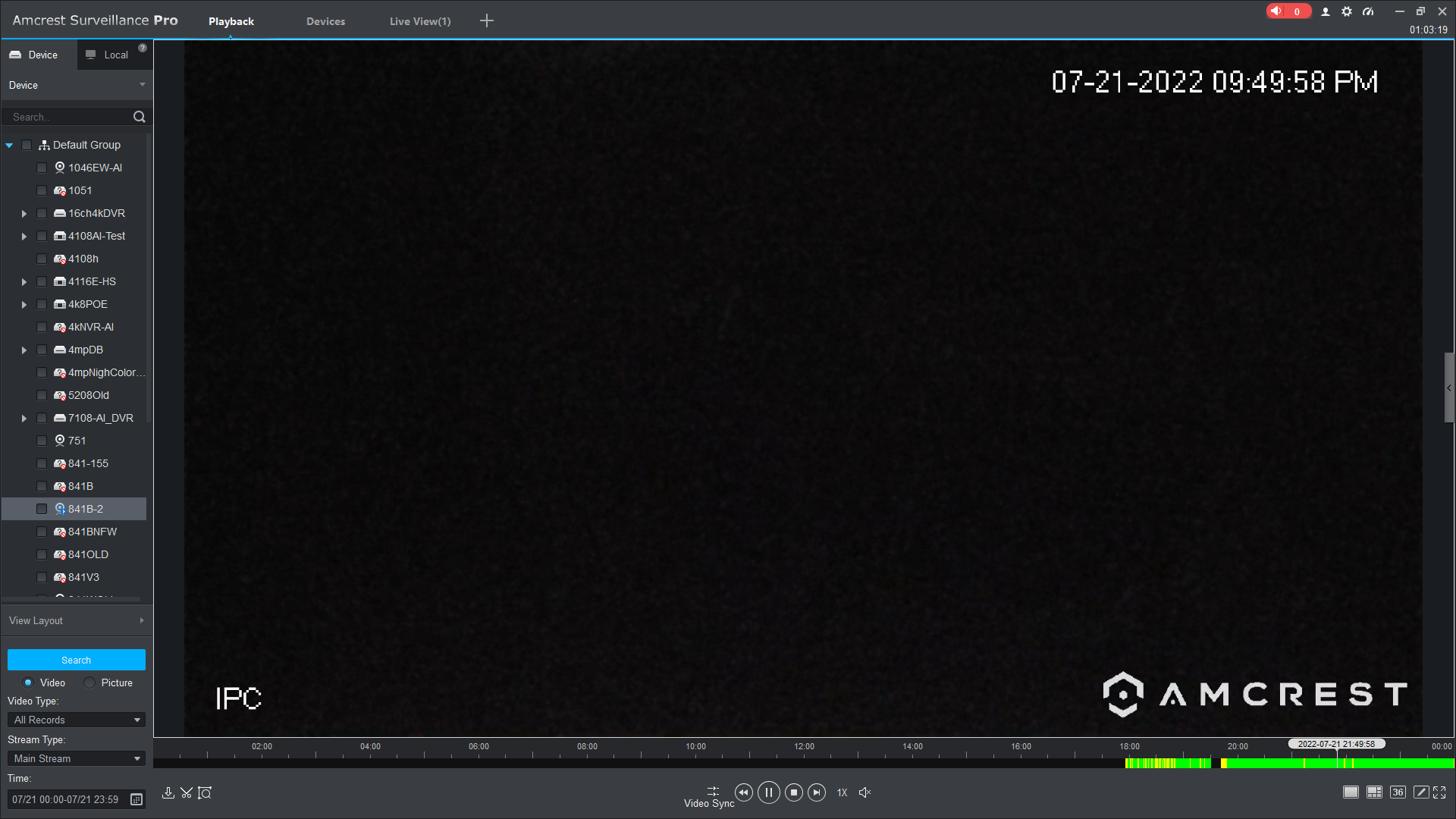

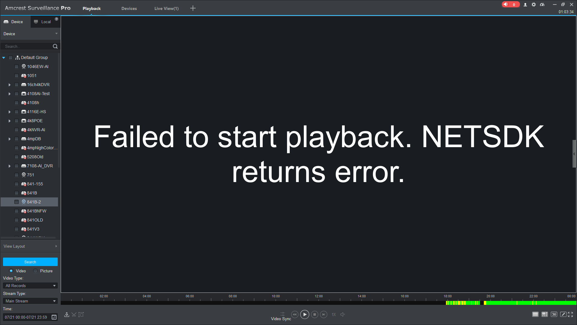

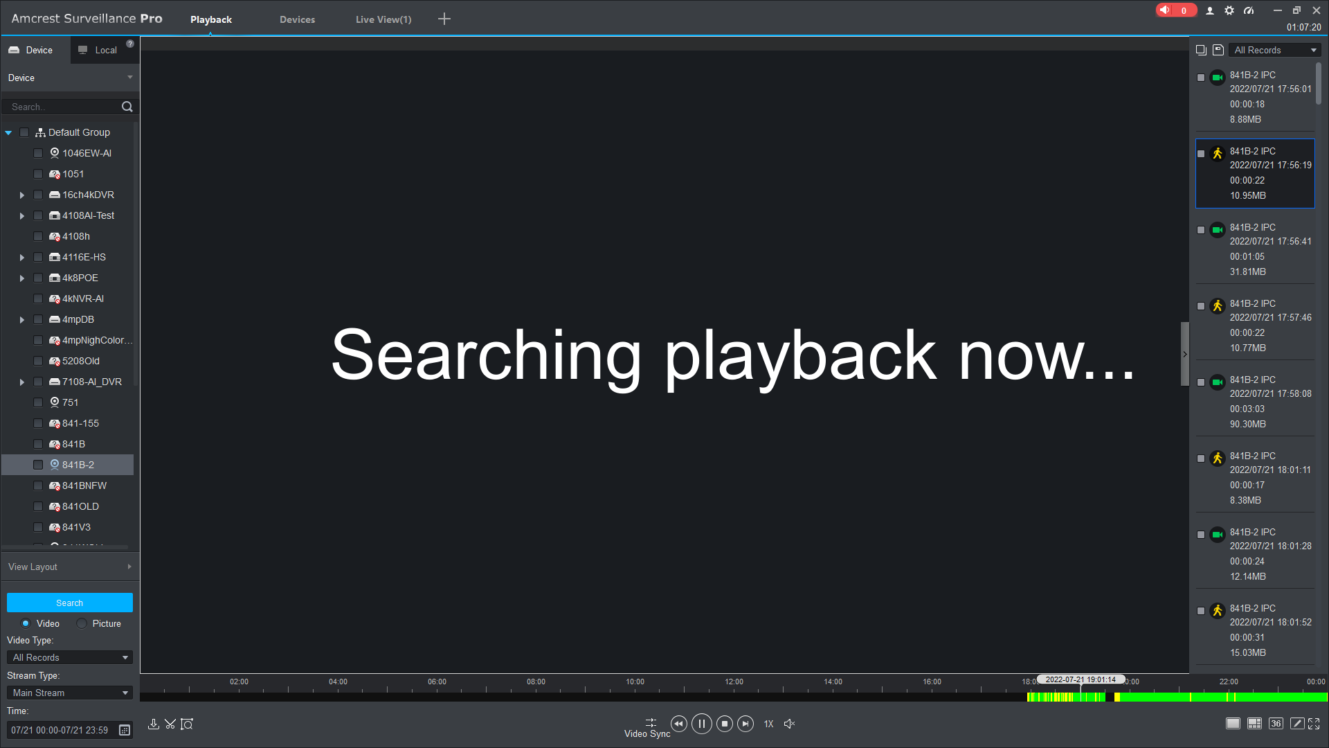

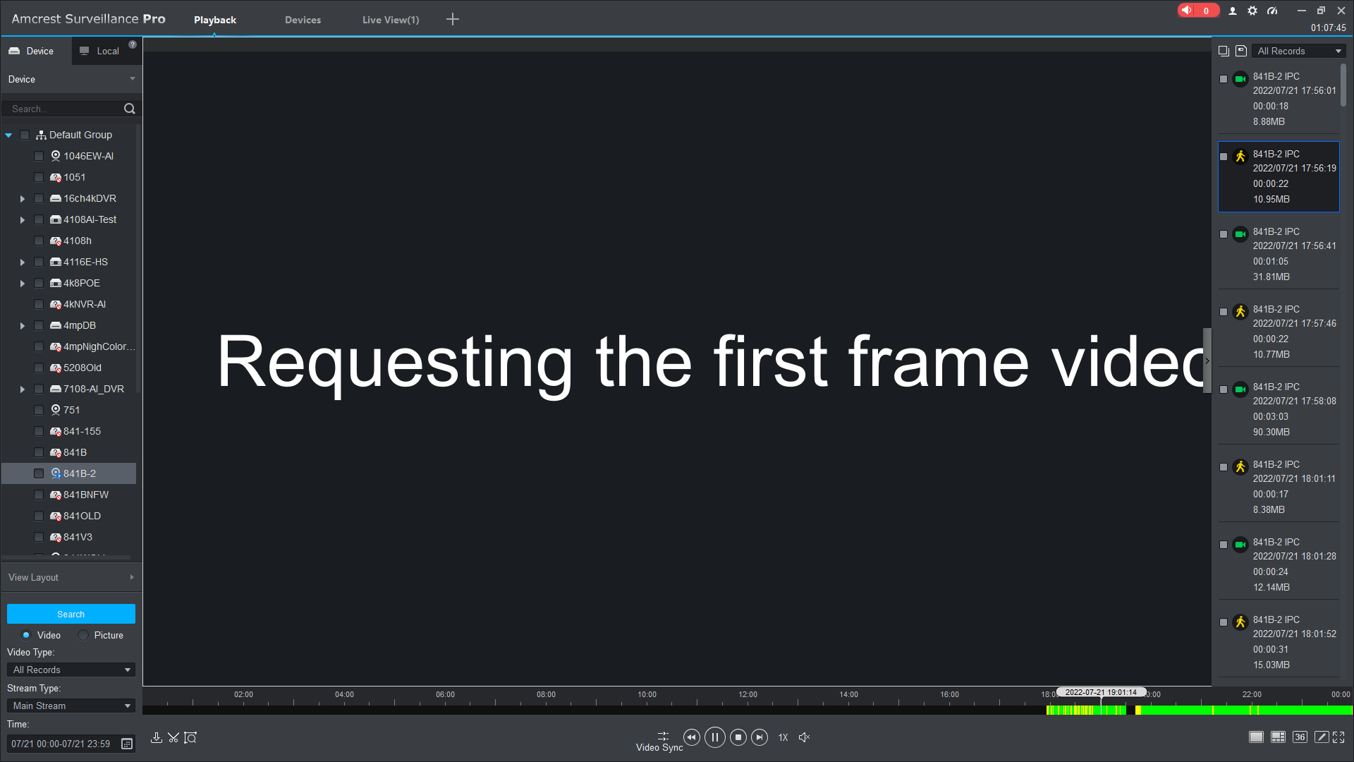

So before I made some testing with one of my cameras. I did it local I then setup in my V3 space because the V3 was logging out constantly and needed to find out why seeing my MSD was full I formatted it as that has been an issue in the past but that didn't work. So I just moved my normal to it's spot so I can bench test the 841v3.
Found that the recordings that I made on my Desk while testing worked out fine Talking about my normal 841 now, I can play them back after some Verbiage being displayed about finding first part of the footage or what ever it was. Then after I moved it I tried to play it back and it fails for the first hour or so of the footage. Then it starts to work again as I also back notice that it was in Full time color mode so I fixed and it has no issue after about the first hour after the move.. So in the first picture is of my 841 playing while still in color at night so you can see logo and time just no picture as there is no light out there only IR in the FOV of the camera.. Second Picture is back some where the error is and this is from playing after the move to start.. Then the last 2 are from area that does play but it brings up these 2 screens of text before it plays.. However for me playing back in WebUI for the camera in IE there is little to no delay and plays back all areas that is able to be played back for some reason there is some bad data after the move not sure why..

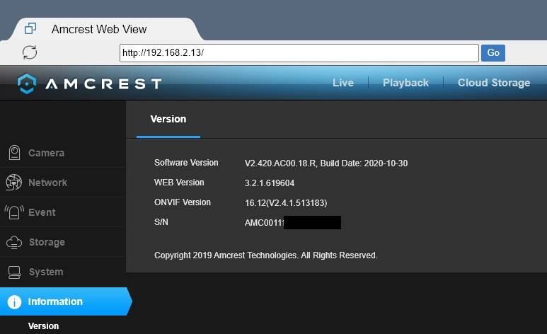

- 2022-07-22 Version-bea.jpg (29.17 KiB) Viewed 1042 times
Re: Error accessing SD card recordings after firmware update (IPM-721B and IP2M-841B)
Little info on my last post:
Looked again at a camera that has a lot more shots stored on it. It always plays the first shot, then skips three, plays one, skips three again, and so on.
Also the firmware version V2.420.AC00.18.R.20191218 shows this error pattern.
