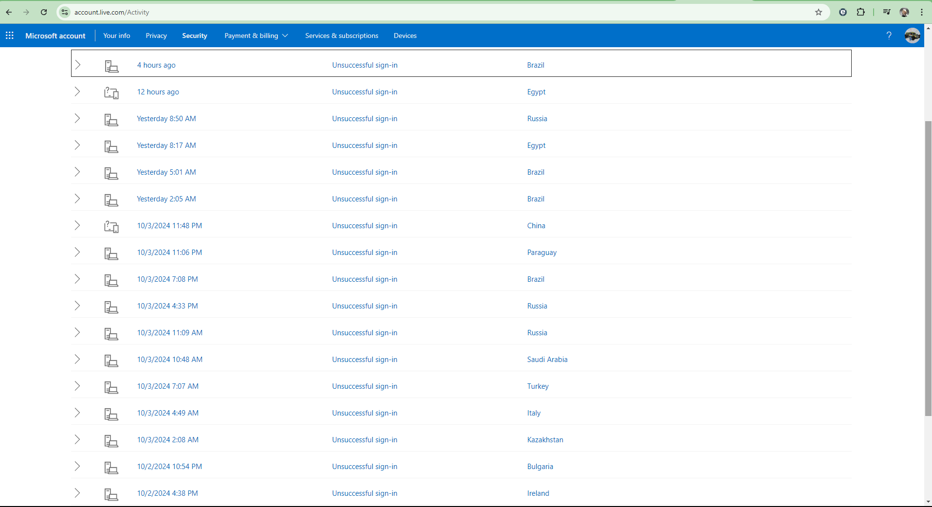

You know what, after looking at my account and all the failed attempts of trying to hack my account, I am not going to be using my MSN or any outlook accounts that I have to access my machines. I am not sure why there are so many attempts on my account but I don't want to add anything that someone might be able to get access to my accounts.
Seeing I control my servers that I use to send and receive emails if something does happen to get past I will just restore a backup to my server and change my passwords. I have had my accounts for many years and don't need someone taking control. Already happened once like 15 years ago and took long enough to get that one back.

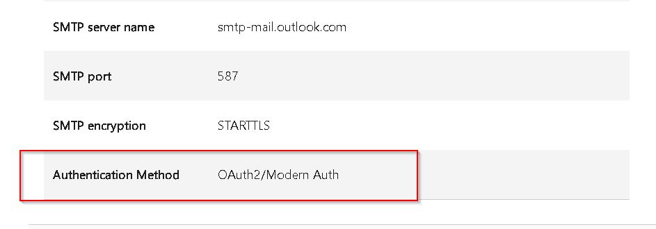

I had a dig around on the MS Outlook site and found this, see attachment.
SMTP needs "Oauth/Modern Auth" settings to work

- outlook SMTP requirement.jpg (24.94 KiB) Viewed 6924 times
