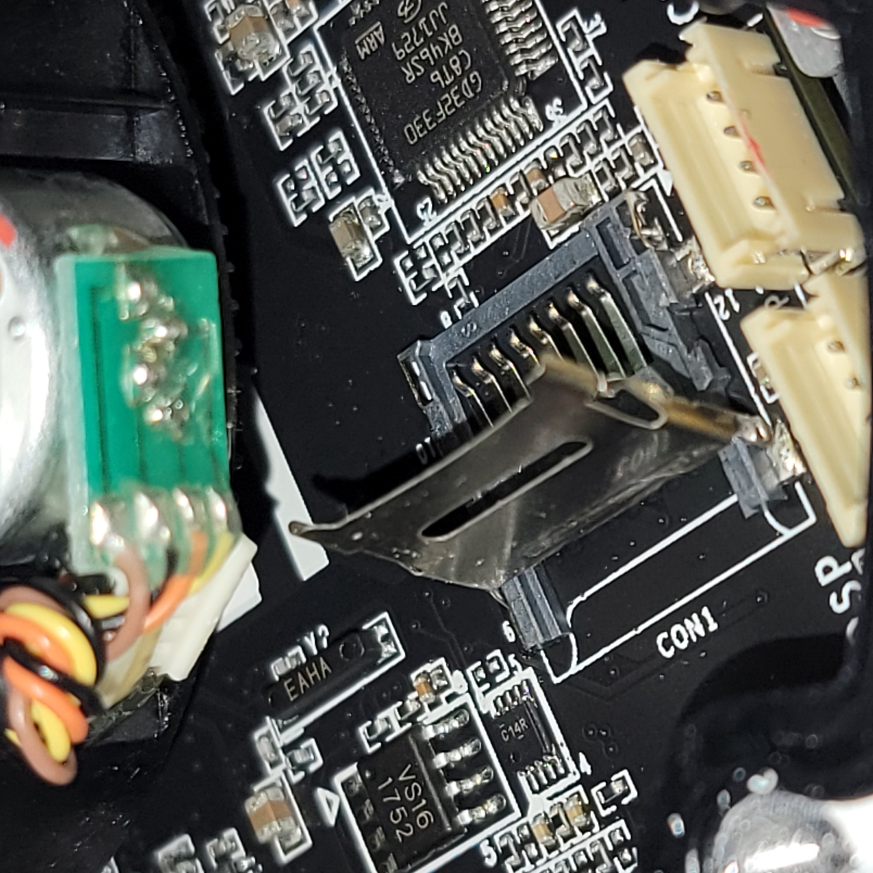

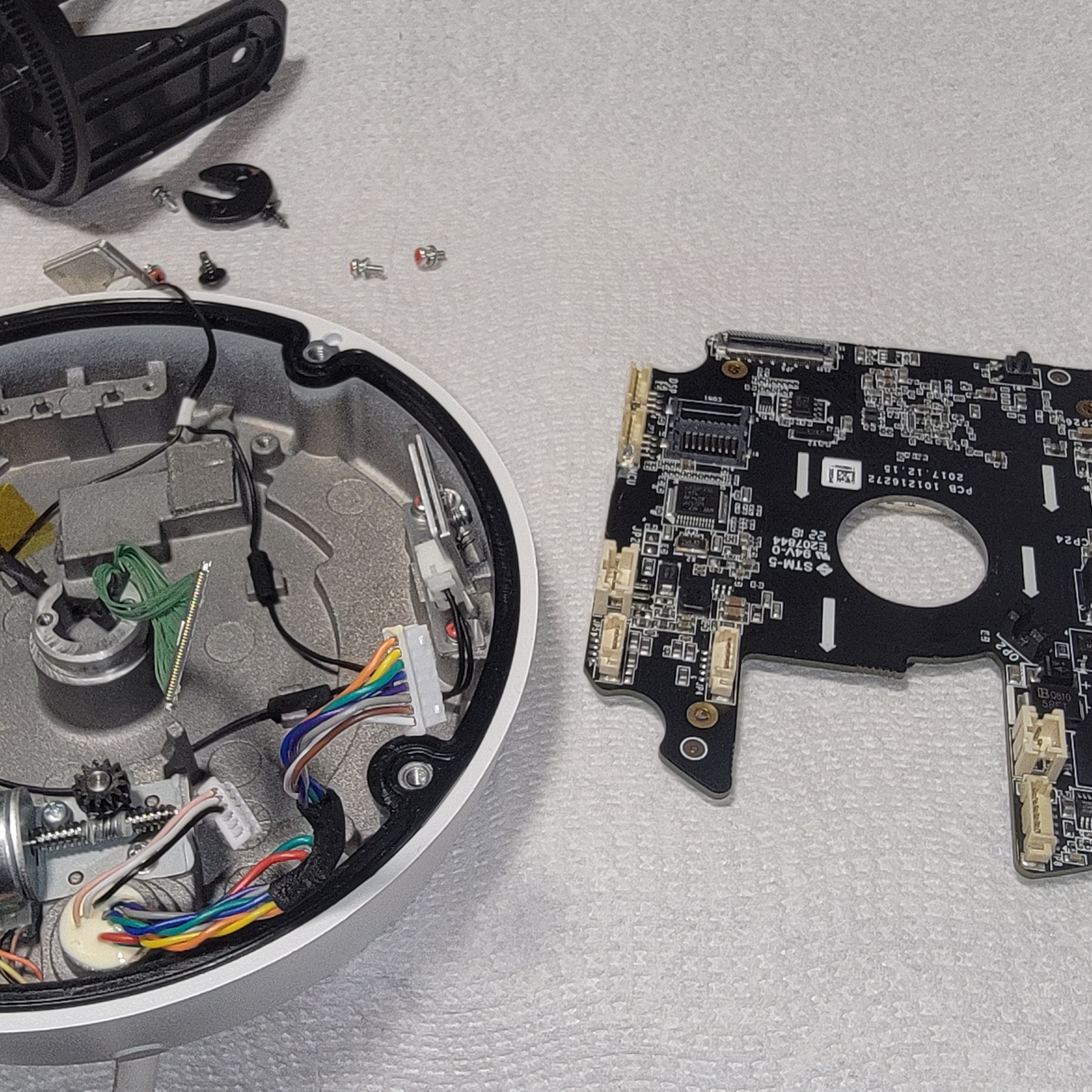

So I have a Mini ptz that is kind of built like 866 from looks. Had this camera installed since 2018 on my remote location over 1800 miles away. It's POE AI and had it connected to nvr so didn't add micro SD. This had a slot that may be like others from Amcrest where the cage top moves you lift and lay in the card close and slide to latch.. well never added card and to be honest haven't even used the system but 2 times since installed. When my son was there last week there was someone knocking on windows so he panned the camera around to see who it was and camera died. So had him pack and ship it to me. Either over time or since installed it seems the Micro sd slot cage touched the tilt motor and shorted out the camera.

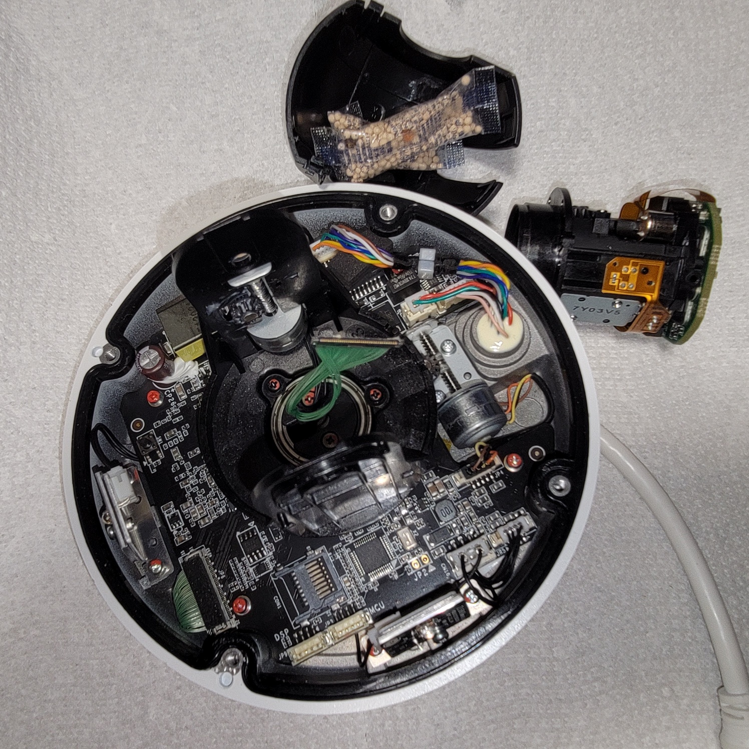

So far found some damaged parts protection diode and one of the Bridge Rectifiers are dead also thought I would mention if you have been in your camera and don't see gel packs don't assume there isn't any this one had 2 in the very hard to remove camera body and I have some Dahua cameras that had them under the PCB where no one would look normally.
Have to remove whole system from body so had to remove camera from cage to remove cable from camera board and reason I found this 2 packs. I will have my son go look at the other 3 I have installed at the barn have him add some tack tape to cage to keep them closed.
First picture shows with part already removed it was jammed into the tilt motor 2nd picture shows how it was found however its just laying there as I had already removed the jam

Also to be honest the cost of this camera and that of 866 if it dies just round file it. I am invested into repairing this but my time is worth more then repairing it. So now at this point I will add in a new micro slot as well. This install I to this body wasn't designed to get removed for repairs pan bearing is pressed onto shift had to use my RC bearing puller to remove it from body and PCB has hole not slotted.

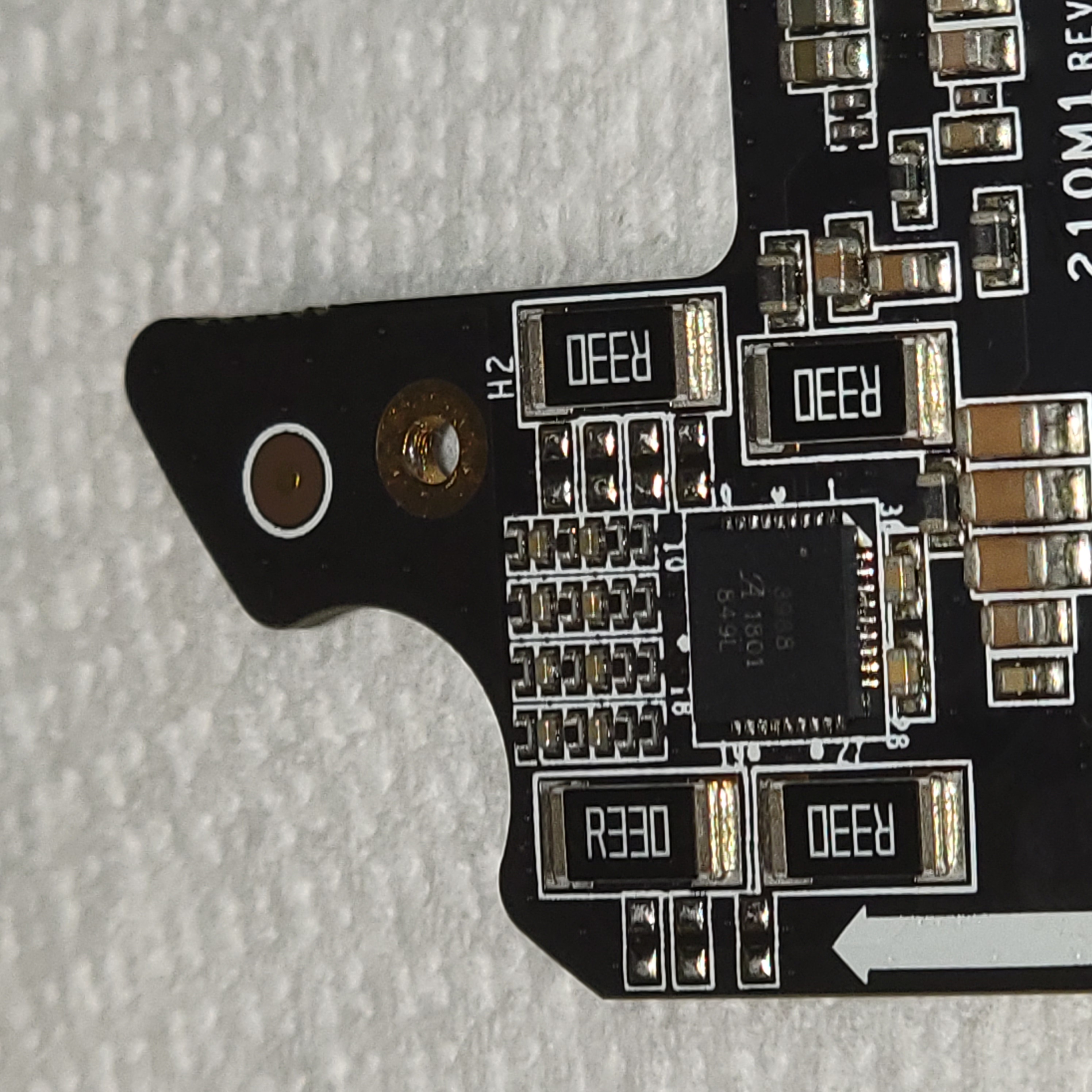

Well found biggest part of the failure its a QFN package 36 pin quad Dmos full bridge PWM motor driver along with other parts. This will be fun lol
