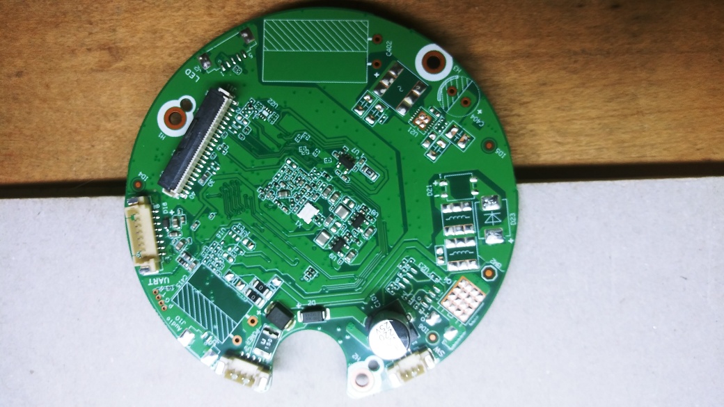

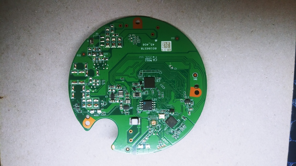

I already had this pulled out and discovered a few diodes I could test with my large test probes. They were all open. I squeezed them into a couple tighter areas and got mixed results with a couple of the smaller ones -- like over 1.0v on one -- maybe on the hot side of a cap?
So does this look like anything you're familiar with? Sure would be nice if you had one in a box in your garage or basement! LOL

Re: Caution about installing mini PTZ
My guess the the first one right after the fuse. Remove it with soldering tweezer or use 2 soldering irons if you don't have any. Then test others. When 1 is bad to ground it can make others look bad if you don't have in circuit test equipment. Once the bad one is found and removed testing others should show correct values.
How ever there could be other issues as well. If the protection diode is removed and short to ground is still there it will require board level testing and when comes to cameras it could be better to just replace. With yours being zoom could be better to repair.
I removed my last post, I remembered that the dome camera you were working with was CVI or 4in1 anyway and the picture of the one while it does have some of the same type protection was of a IP camera. So I removed it as I don't want to make things more complex then it is already. Just keep in mind that some of the components that don't show the right values could be just showing in Circuit values and best to have a in circuit tester or remove at least one side of the component to test out of circuit.

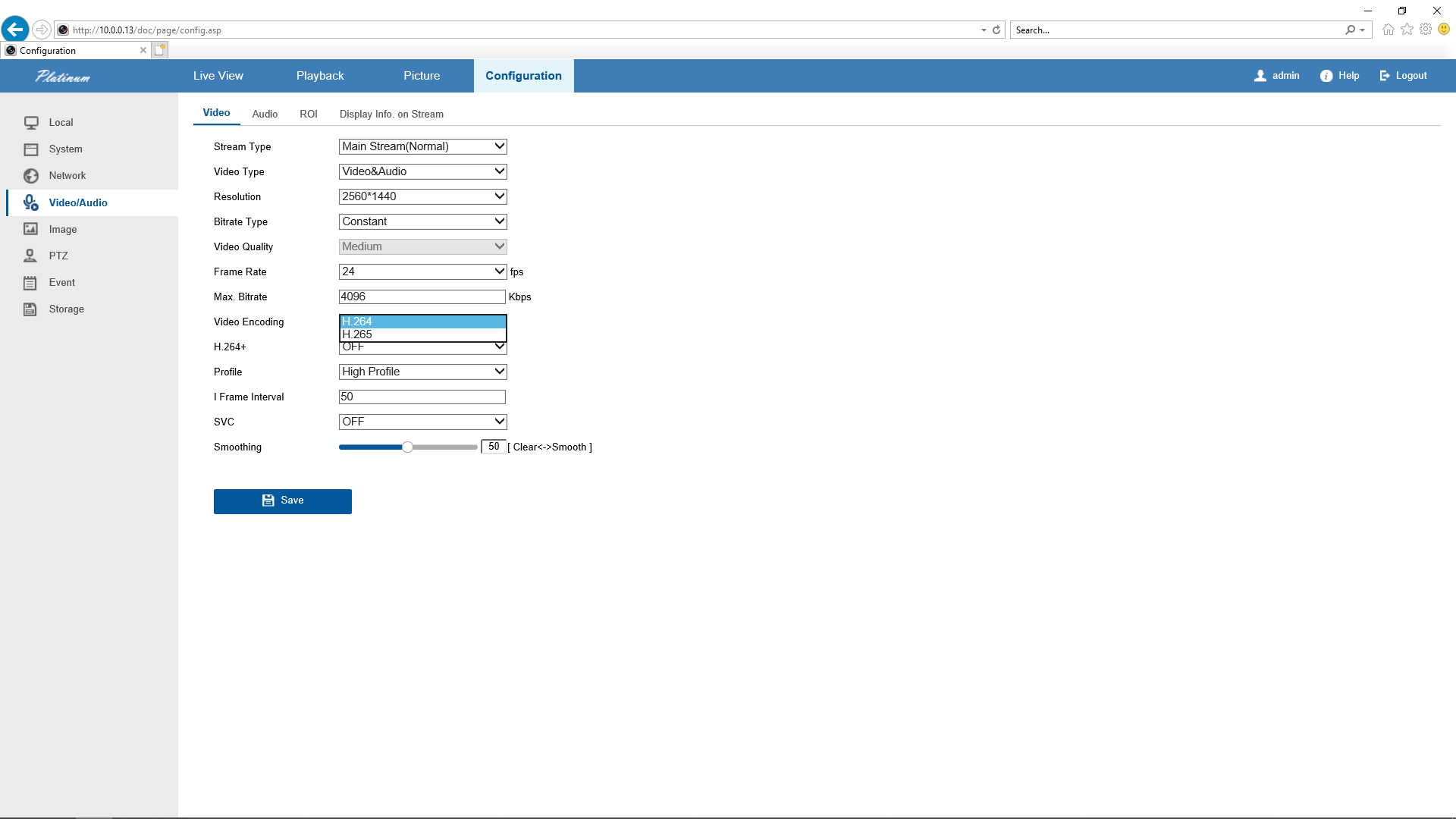

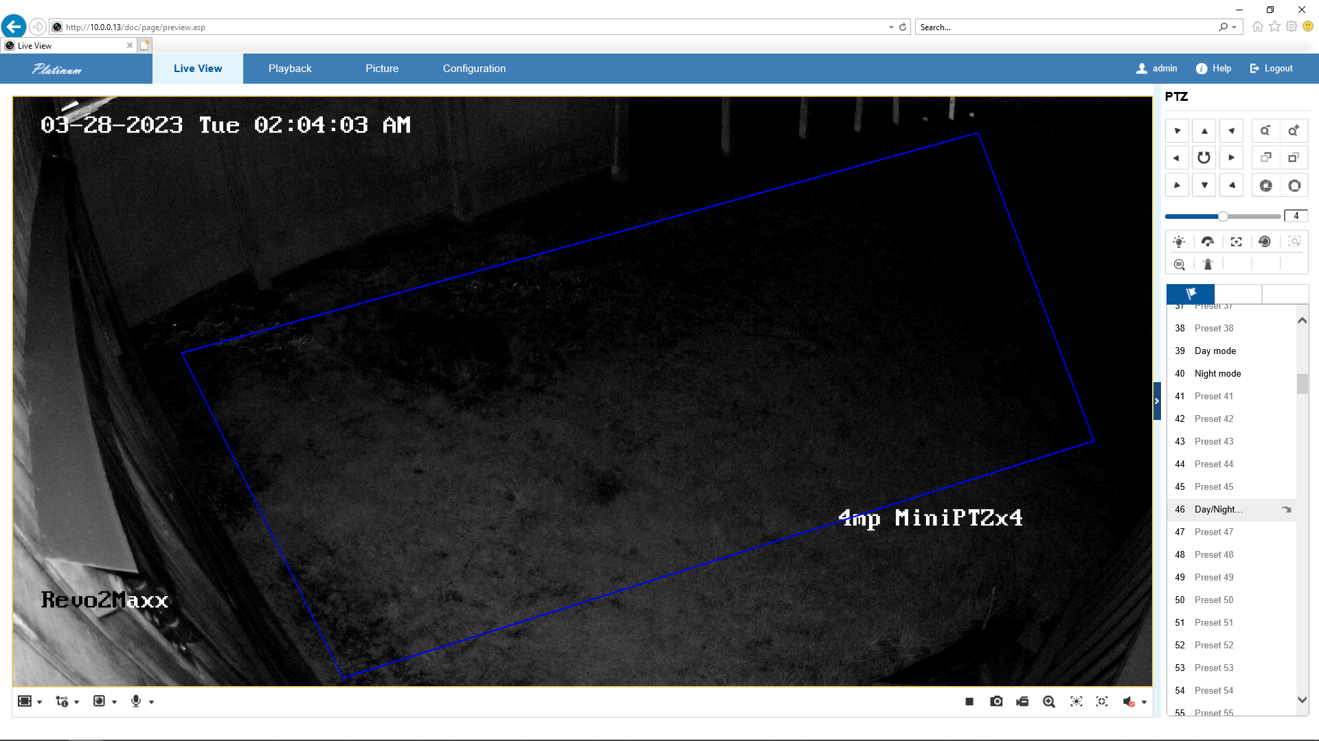

Well the parts came in today for my Mini PTZ. I took down my 846EB for now. Normally this camera is in a better lit area. I forgot the LEDS on it stinks lol.. I mean my old POS outdoor Foscam has better IR and that is behind the dome of the little mini PTZ camera. It is just so slow that I don't use it much only keep for a back up. Anyway this little PTZ has 3 IR on the front, right and left of the case, connected it and forgot that it was normally working in Color at night so I had to change over to Day/Night and one of the cool things about this camera was ability to use Preset for some adjustments. It is AI and won't work with my Amcrest or Dahua AI NVR's so I had to install a new Micro SD slot for a card as the old one is what caused the damage. Normally the Amcrest 846 has built in Mic so I have this connected to a Hikvision Mic seeing it isn't built in, does have audio in and out so that works. They call it a 4mp however to me it really is a 3mp because the video size is under 4mp.
Glad I bought 2 chips. 12USD each I am not sure what happened but the first one I installed failed on boot after installing everything back lol What a pain I had to take it all out again. Hardest part was the camera body mount has to be pulled off the base with a bearing puller. The camera did the dance and just as it was getting to the point it would normally come online; Greeted with some Magic Smoke poof..
Screenshot (4257).png (1.06 MiB) Viewed 1434 times
Screenshot (4258).png (62.52 KiB) Viewed 1433 times
