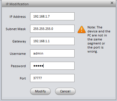

Also, figured I'd include this screenshot from the IP Config tool:
Annotation 2019-10-31 140240.png (14.16 KiB) Viewed 24749 times
Am I understanding correctly that the 192.168.1.1 number is the ip segment you're referring to? Why would it be telling me they're different? And if that's not the problem, how would I figure out which port it's actually trying to use?
