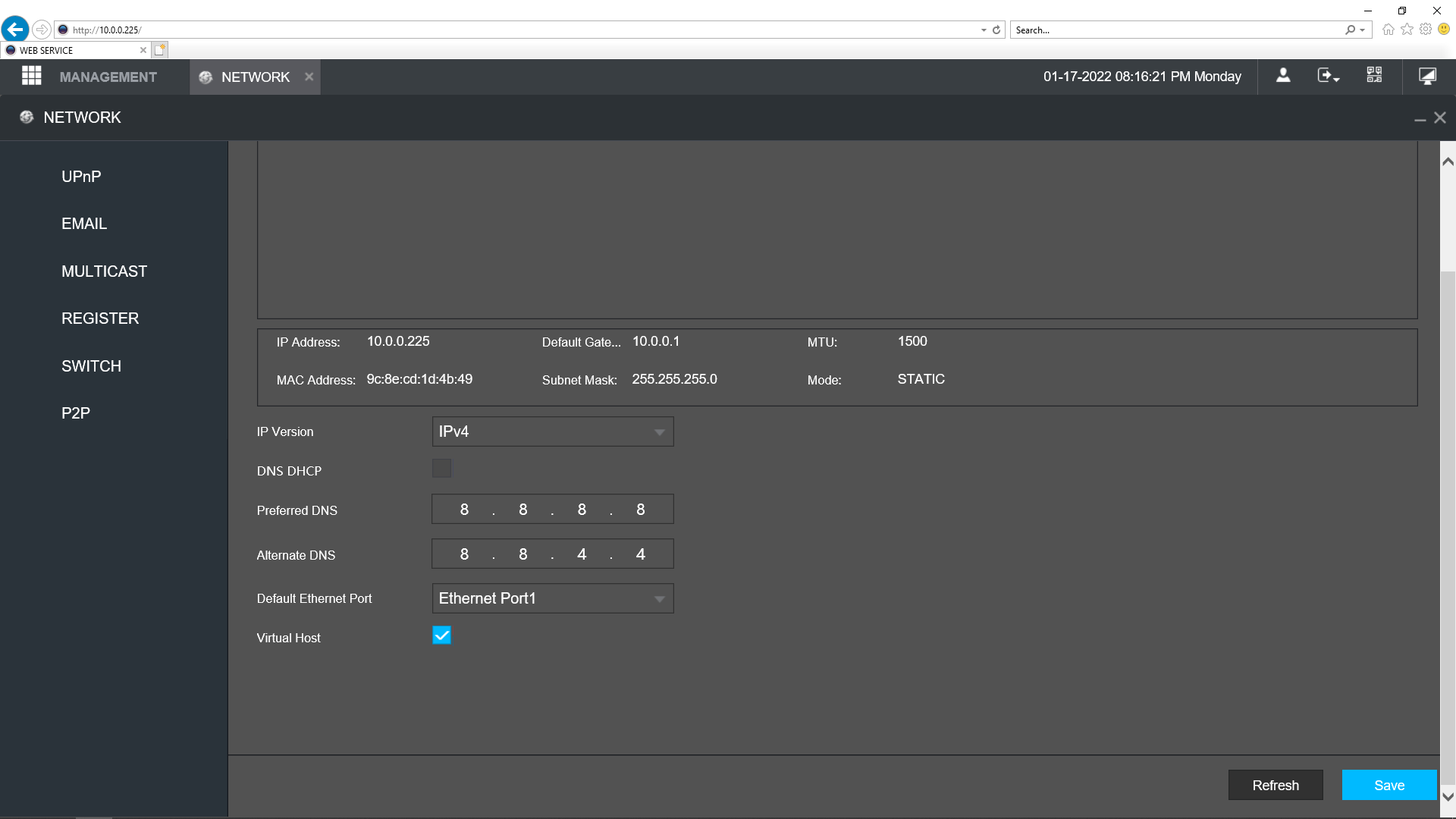

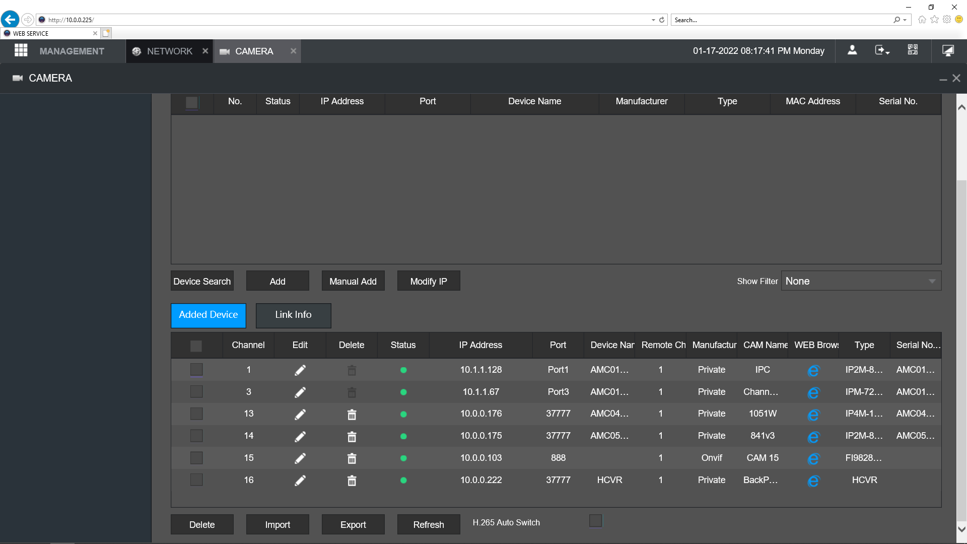

Re: Cannot Access Web Interface through Browser
I would double check your NVR WebUI, you would do so by going to a Web Browser IE is best choice at this time, http://yourip and press enter, Then login with your user and password, then on the top right Click on Management, then Network and there should be on the main page there an area that Says Virtual Host make sure that is enabled. if it isn't then scroll down and press Save.
Now click on Management again, now press Cameras, in the bottom set of windows click on the camera you want to configure
Make sure to note that doing so without ever logging into your cameras you will be required to change the password in the cameras and you will need to make that change in the NVR's setup for the cameras or you will no longer have footage from then on...
Pictures Below show what I am talking about using 4.0 software

What NVR are you using?Revo2Maxx wrote: ↑Mon Jan 17, 2022 7:18 pm I would double check your NVR WebUI, you would do so by going to a Web Browser IE is best choice at this time, http://yourip and press enter, Then login with your user and password, then on the top right Click on Management, then Network and there should be on the main page there an area that Says Virtual Host make sure that is enabled...
Pictures Below show what I am talking about using 4.0 software...
