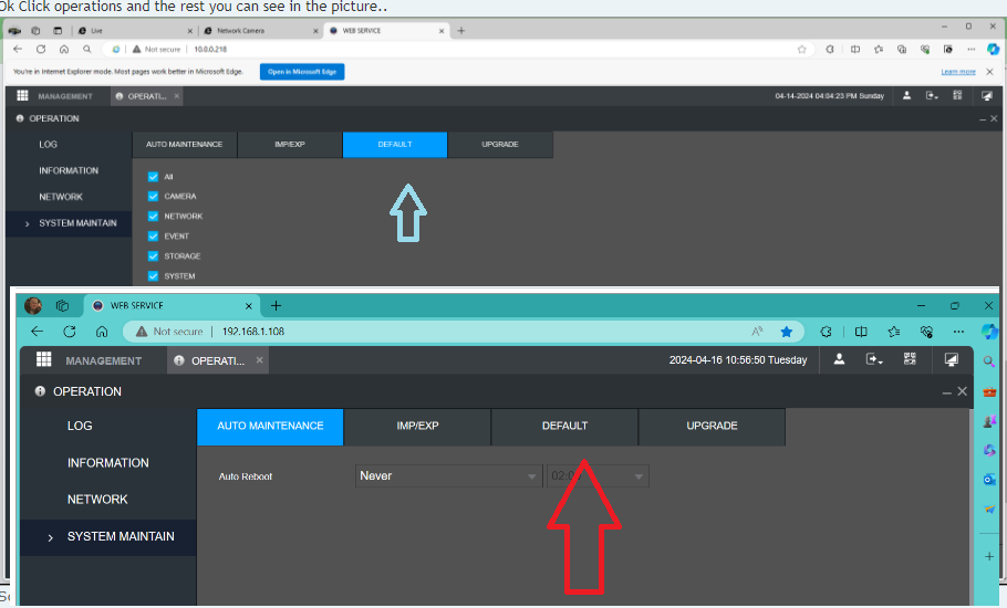

Operations, System Maintain, Default and if there is no default and find that odd seeing I have every 4108 offered.. And sure will admit that the 4108-A2 has a little different look then the HS model it is just maned different but mostly in the same space as the HS model that you have..

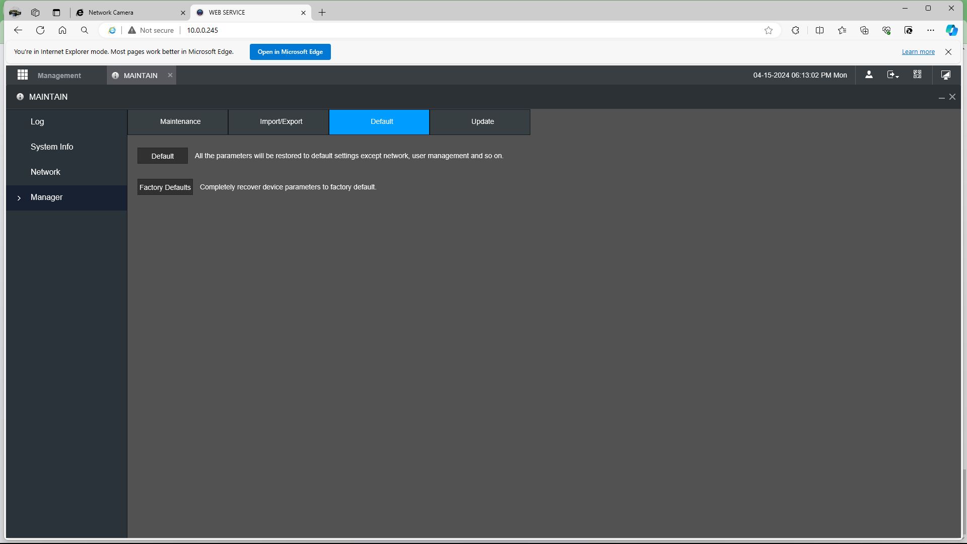

As you can see in the picture below Maintain and manager is how you get to the reset area on the A2.. Sorry thought by looking at the picture that I posted above it could be followed to what part of the menus I was in trying to save some typing time..
If in your Maintain there is no top menu for Default would love to see a picture of it and know what firmware you are using

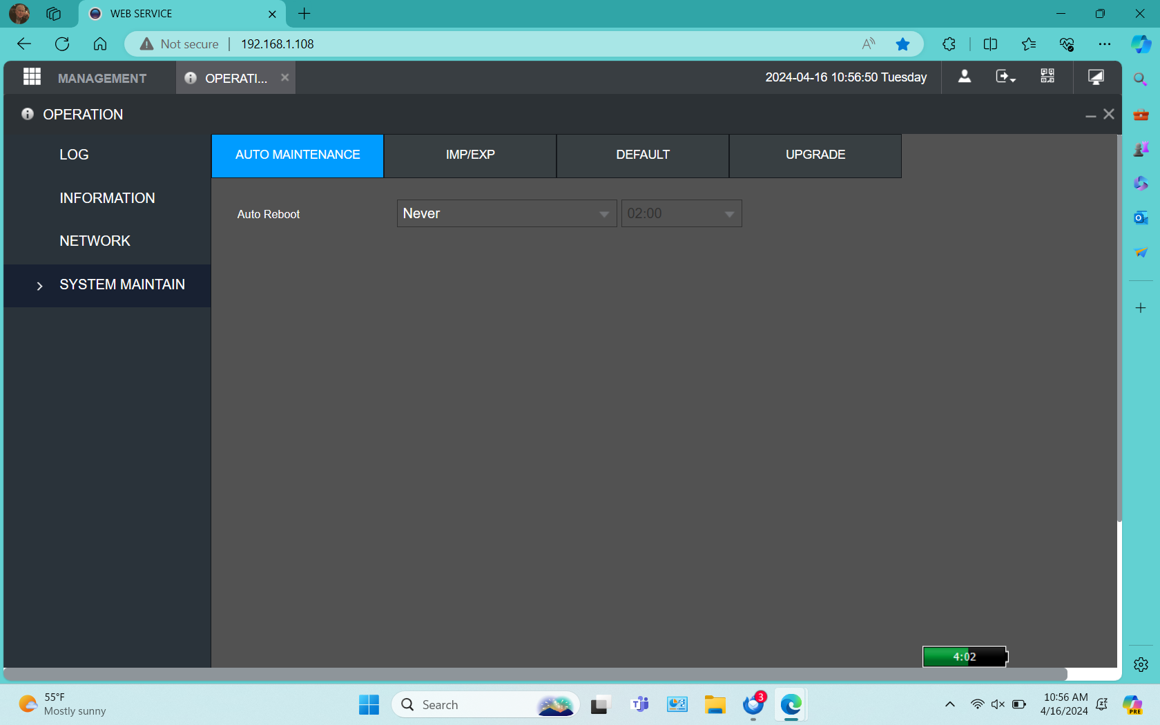

There are no screens on my 4108-HS like the ones that you have posted. I have attached a screen that is closest to your last post. My firmware version is V3.2.7,121467. I did an upgrade which appeared to install the latest version, but the number didn't change, so I guess I had the latest. Or maybe what I think is the version is wrong. I will post a pic of the screen that I thought had the version later.
Regards, Jim

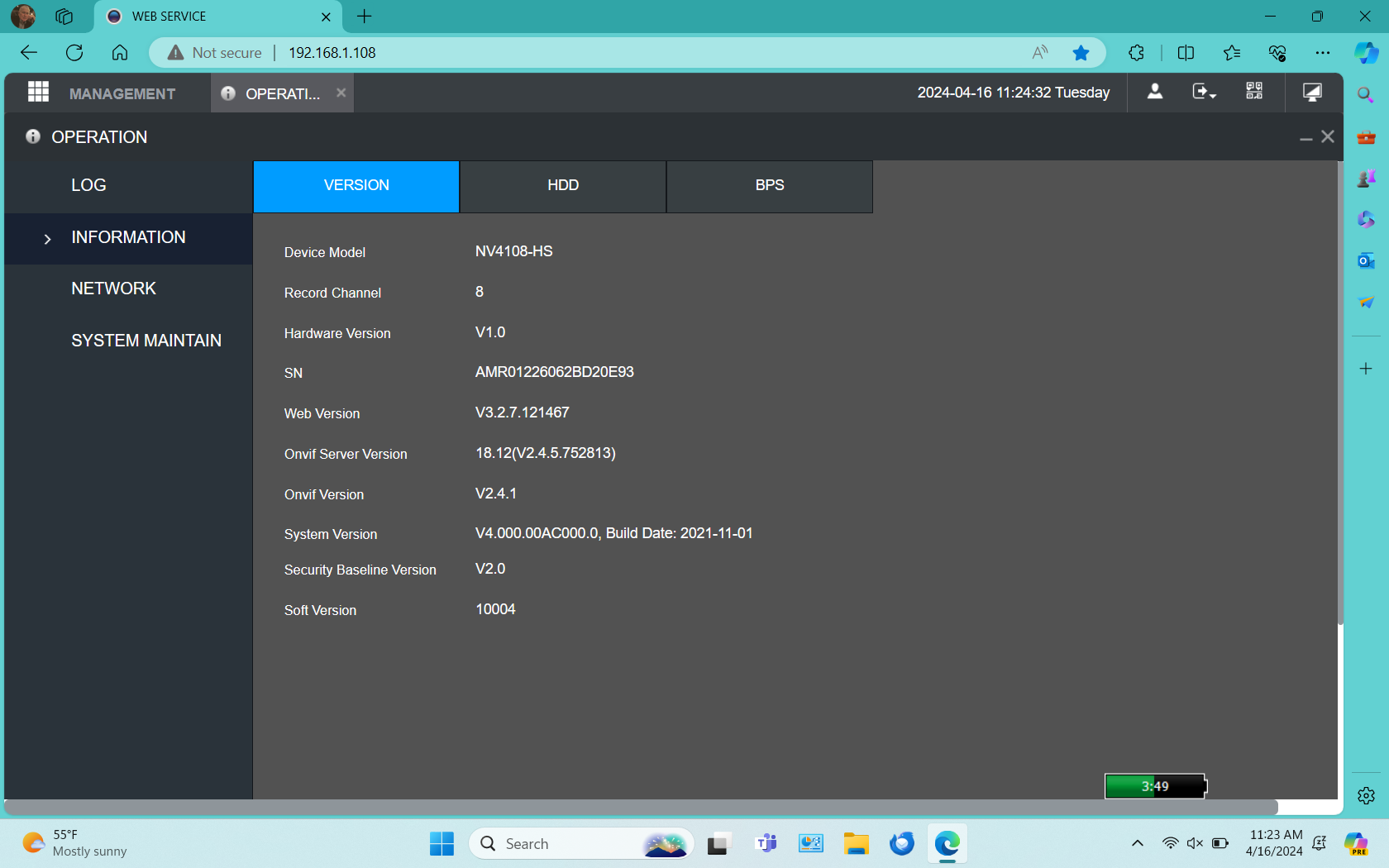

Here is a screen shot of the page where I got the firmware version, web version V3.2.7.121467.
Regards, Jim

Re: Can't View Cameras on Surveillance Pro
Screenshot (1877).png (74.41 KiB) Viewed 11683 times
