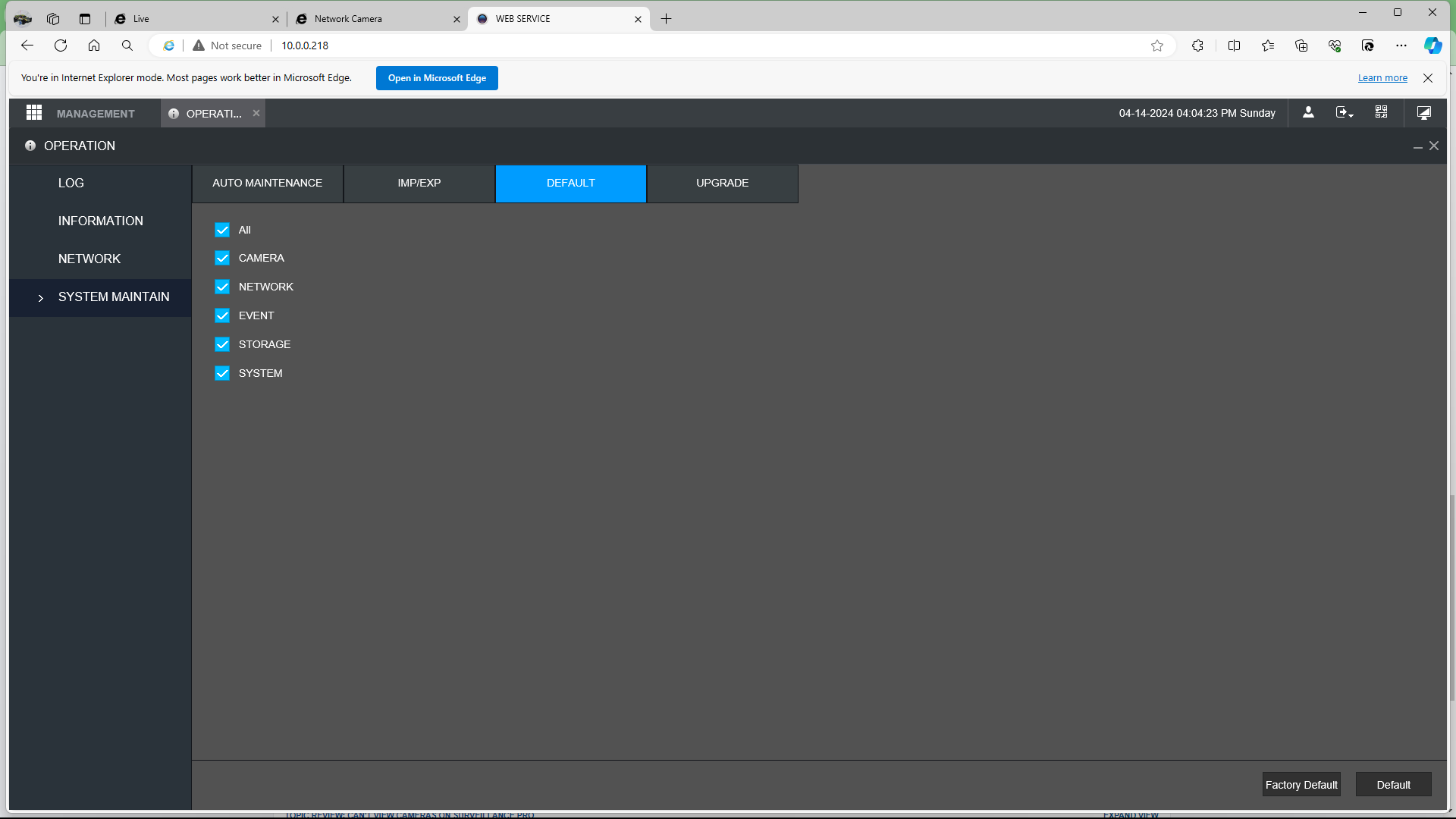

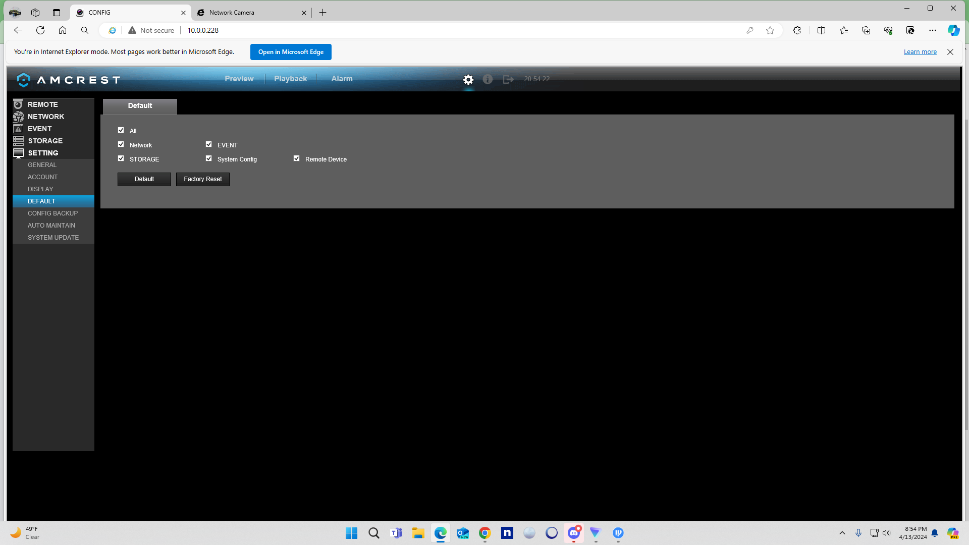

I would look at doing a Factory Reset to the NVR. What I do before doing so is take apicture of how you have the NVR setup. Even if you have to do this over the NVRs GUI. I use WebUI most times for tihs. However keep in mind that setup of the NVR would be best on the GUI because the IP of the NVR normally gets set to DHCP and the IP changes. For me I have not only setup my DVR/NVRs to Static on the recorders I also setup Static in my Router so that is why it works on WebUI for me..
Manual reboot in WebUI and Reset to factory see pictures below for a normal 4108h.

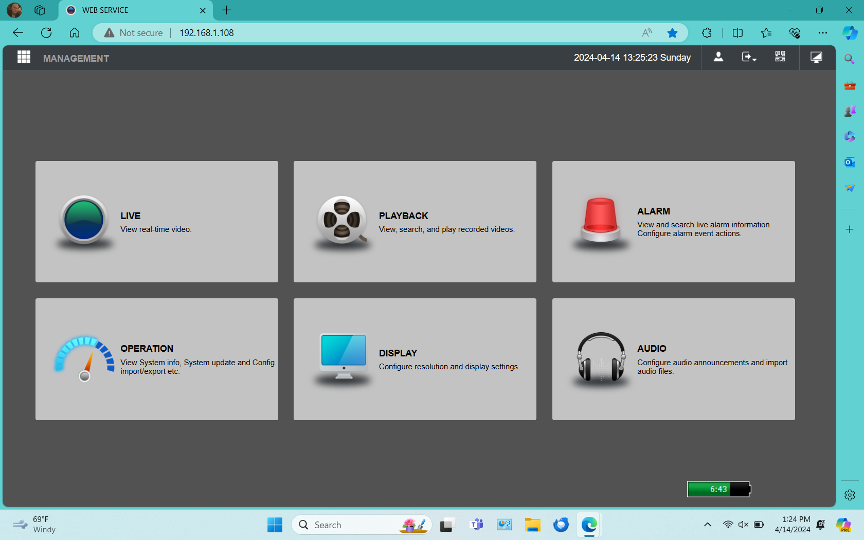

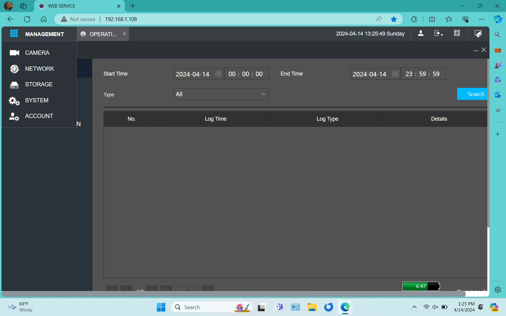

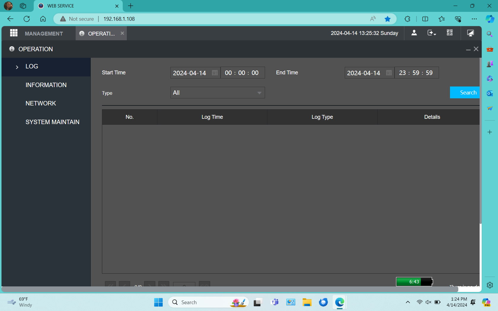

Just an explanation of the issue. I start the ASP to view my cameras. But, no camera will connect. Screen shows "Searching Video". All devices show as online. If I put the IP address of a camera in my Edge browser, it shows up with no problems. If I put the IP address of the 4108 in my edge browser, I can login to the 4108 and view any of the cameras.
I have tried to get to the NVR screens that you put in your message. I log in to the 4108 by putting the 4108 IP address in my edge browser. I get screens similar to the ones you posted. But, I don't see any way to attach files. (I am using Quick Reply.) Maybe if I use the Full Editor, I will be able to attach a couple of screen shots?
Regards, Jim

OK, here are some screen shots of the 4108.
Regards, Jim

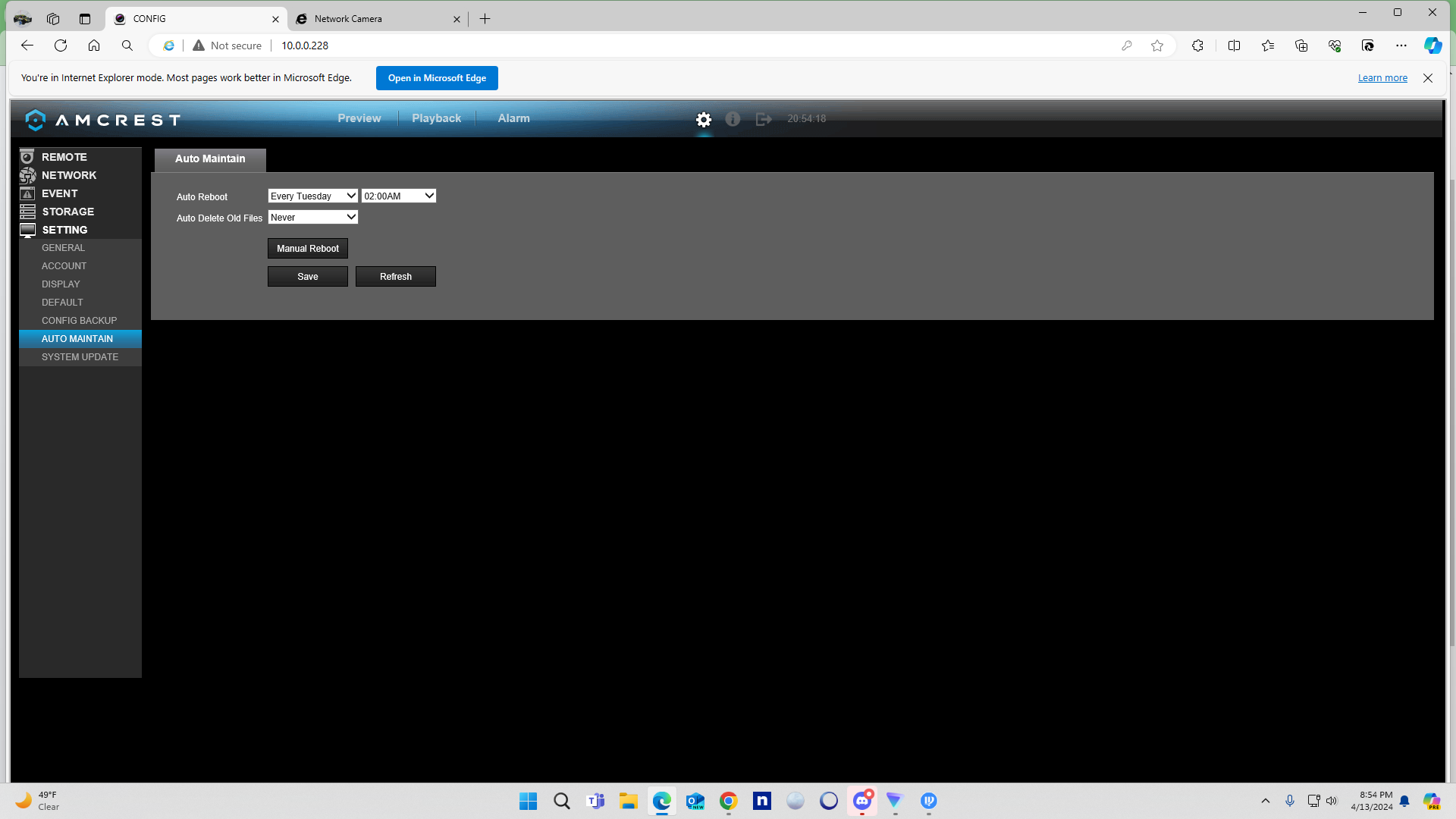

Re: Can't View Cameras on Surveillance Pro
Ok Click operations and the rest you can see in the picture..

Revo:
I get none of the options that you show in the screen pics that you posted. Neither under Managment nor Operations. If you look at the screen shots I posted, you will see options for Management on one pic and options for Operations on another. Mabe I should go to the NVR directly rather than use the edge browser?
