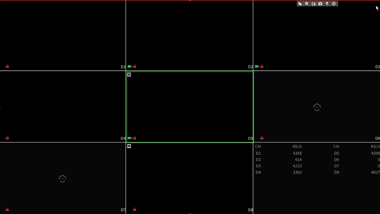

Are you talking about something that looks like this?
Screenshot (4463).png (53.09 KiB) Viewed 16791 times
Re: Cameras Offline After NVR Reboot
If that is what you are talking about. Then you will want to while logged in. right click, go to main menu, then system, then under General under Auto Log out if you don't want your NVR to log you out change that to 0 Press Apply. Then next to that area where you put the 0 in is Monitor Channel(S) when logout and click that then click all, then press save.. Now once your NVR reboots or your system logs out if you left auto log out turned on it will still show the cameras on the GUI. Just keep in mind if you have to log in before able to access the main Menu and other things like PTZ and one reason I leave my systems logged in because I want fast access to my PTZ cameras. if I have to log into the Recorder and then bring up the PTZ menu after bring up the camera view the issue could have already moved out of the area of interest.. So leaving it logged in keeps 1 less thing that has to be done before I can have direct access to my cameras view..

Revo2Maxx wrote: ↑Sat May 27, 2023 8:42 pm Are you talking about something that looks like this?
Looks something like that. Each camera feed box has a text input field.
