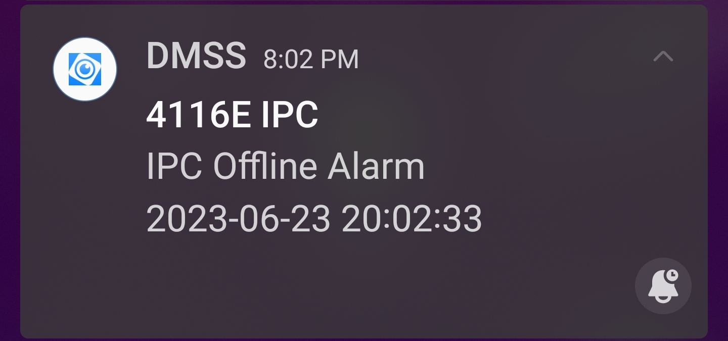

I would also setup on your Amcrest View Pro a push Notice for an Offline alert. This way you get a notice when the camera goes offline. However I am not 100% sure that is on Amcrest View Pro I have mine setup with DMSS and might be why I get offline notices. If you have Email you can setup an offline event to be sent to your email.
Looks like maybe someone might want to ask in the feature request to add in the IPC offline alarm in the push notices..

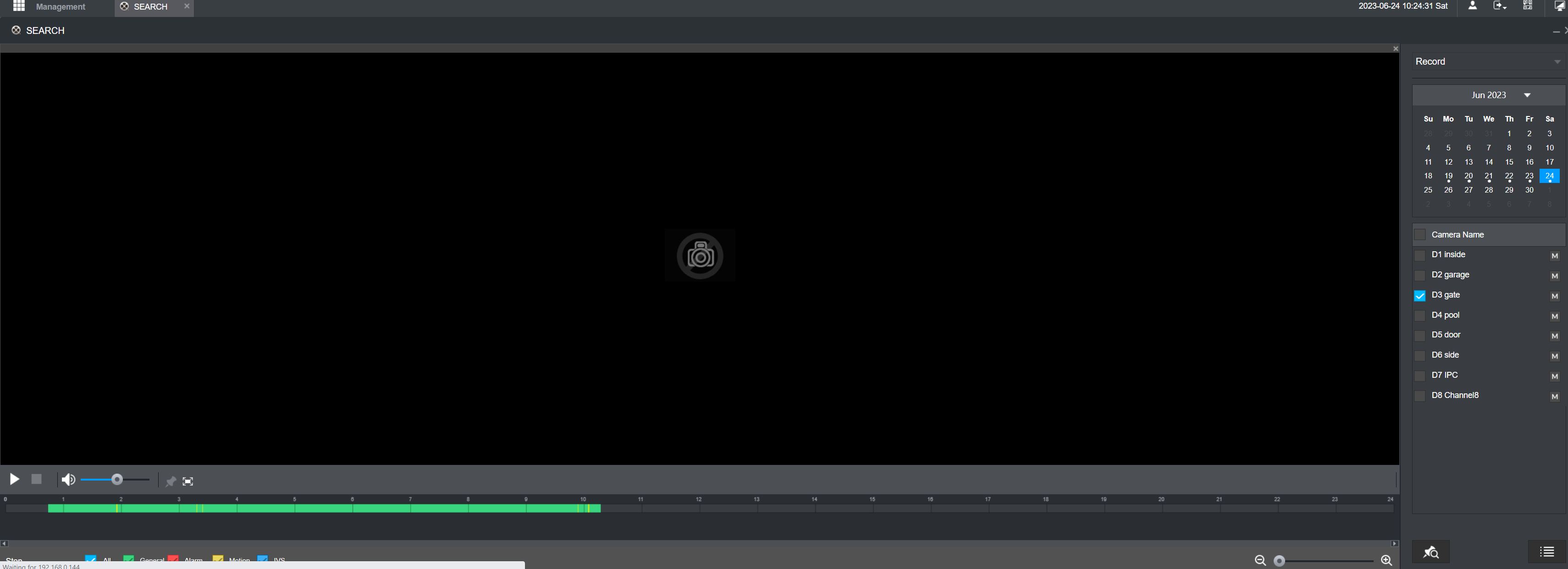

doesnt miss , online 12:30am , offline 10:30am
- arm.JPG (152.13 KiB) Viewed 2307 times

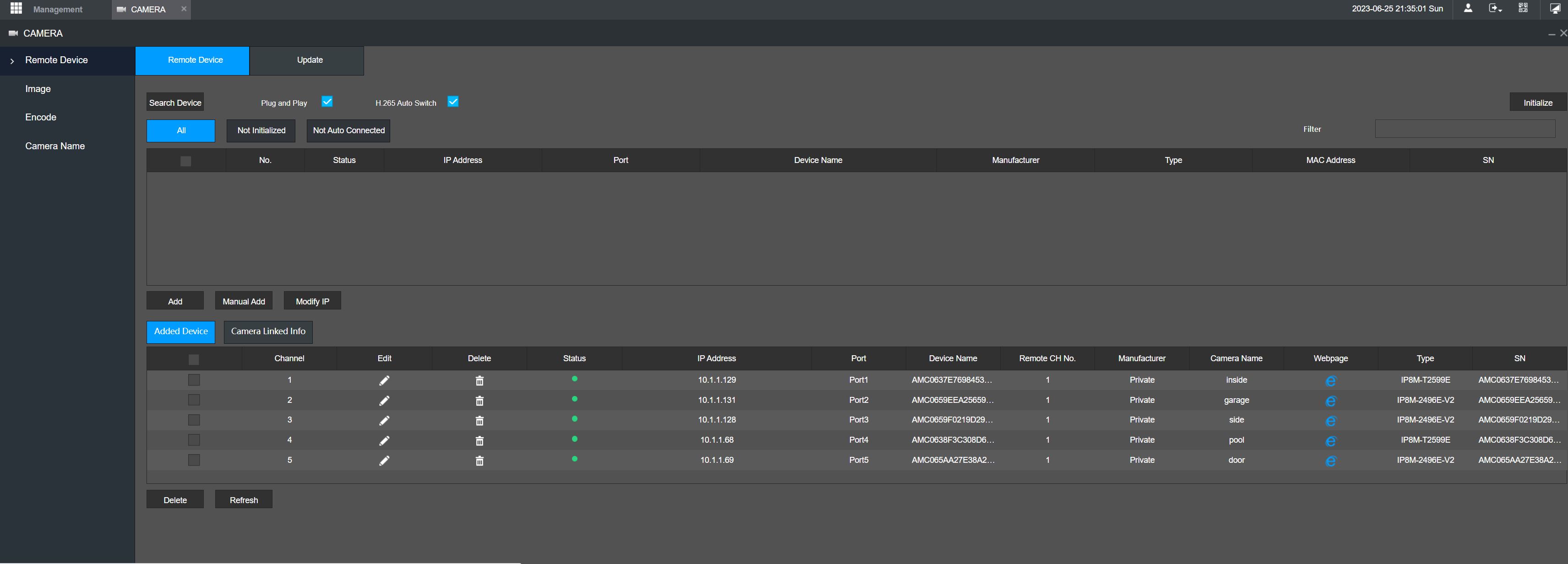

I reset it back to factory, that didnt help, entire camera goes down not just the recording ,so my channel 3 is acting up. i switched channel 3 and channel 6, but now i have that same camera on both channels, two channels with same IP, i deleted channel 6 , now i have to wait for camera to wake up so that i can add it back to the channel , as of now i can see that camera anymore , hopefully it shows up at night like usually

I hate to say it but I think you need to Reset your NVR back to factory. However please do the following before you do.. With a Sharpie make each one of the cables Port# they are on right now.. Once you do this remove the cables from the NVR, Do a Factory Reset o the NVR. Then Uncheck Plug and PLay and also un check Auto H.265

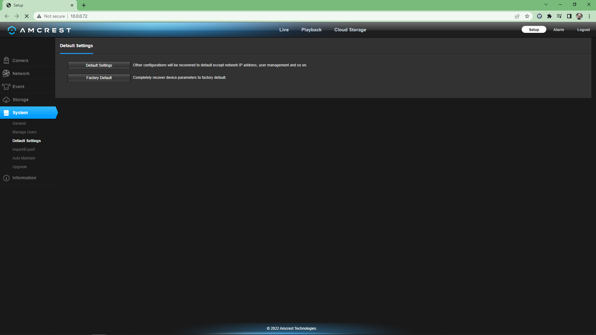

After you do this take the Non working camera and connect to Port 1, Then go to the page you just post the picture of and press the e to log into the cameras WebUI. It will load your NVR's IP address and a Port number for mine it would be 10080 for the first camera. Anyway log into the cameras WebUI, and Reset it back to Factory. IT will normally on my NVR anyway come back online as admin admin and you will have to change the password in your settings on the NVR to reflect the admin admin for it to come up..
I hate to say this but in Truth you would be best off to reset all the cameras back to factory defaults. However if you don't it would be wise to at least log into each of the Cameras WebUI and Change the Encoding type to h.264 I say that because that is what the camera comes factory and that means there might be an issue with H.265 format.
Once you get them all connected and either reset to factory or logged in and changed the encoding on the NVR go to the page to reset the NVR's password. You are doing this to change all the passwords on the cameras to the NVR's password.. (Important step. If you have ! or any other of the Special setup in your password right now DON'T use that one as your new password because the Special could also be an issue... Once you change the password on the NVR a Box will pop up and ask if you want all the cameras as well Choose yes or Ok or Apply what ever means yes and then another box will pop up and say if it was good or fail...

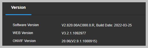

Also thought I would mention this is my current version for my 2496EW-V2 that my Camera is working with..
