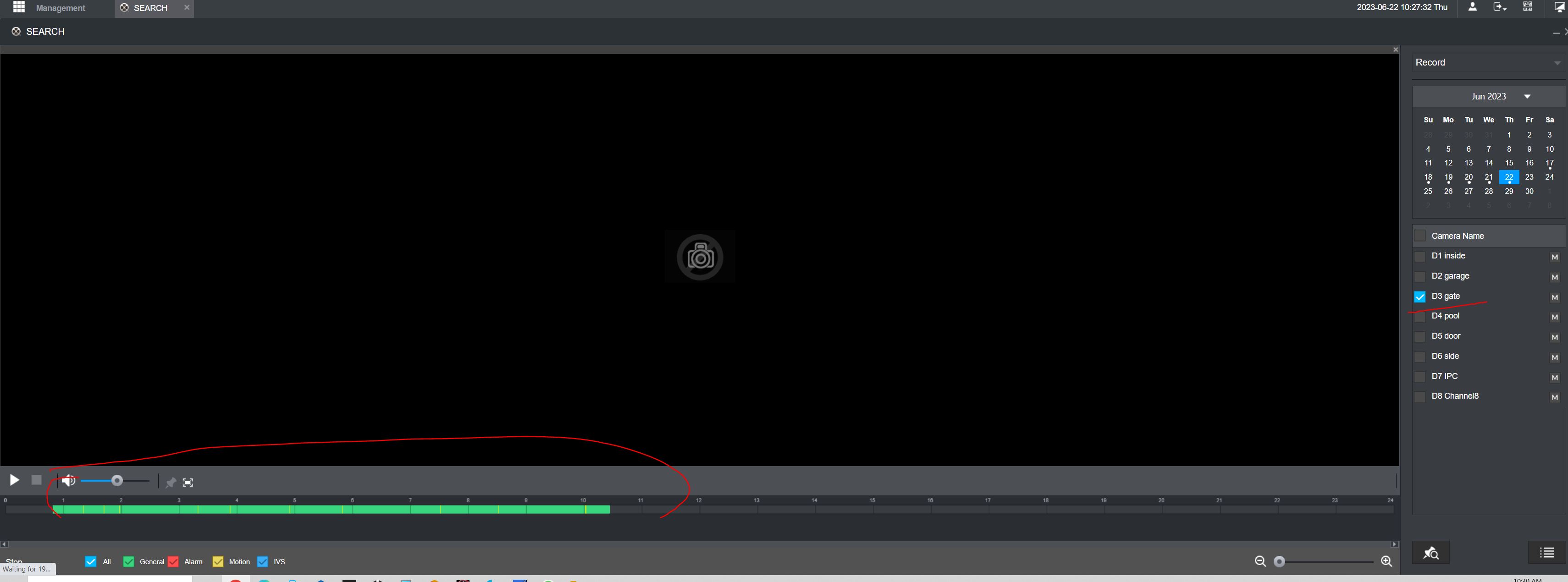

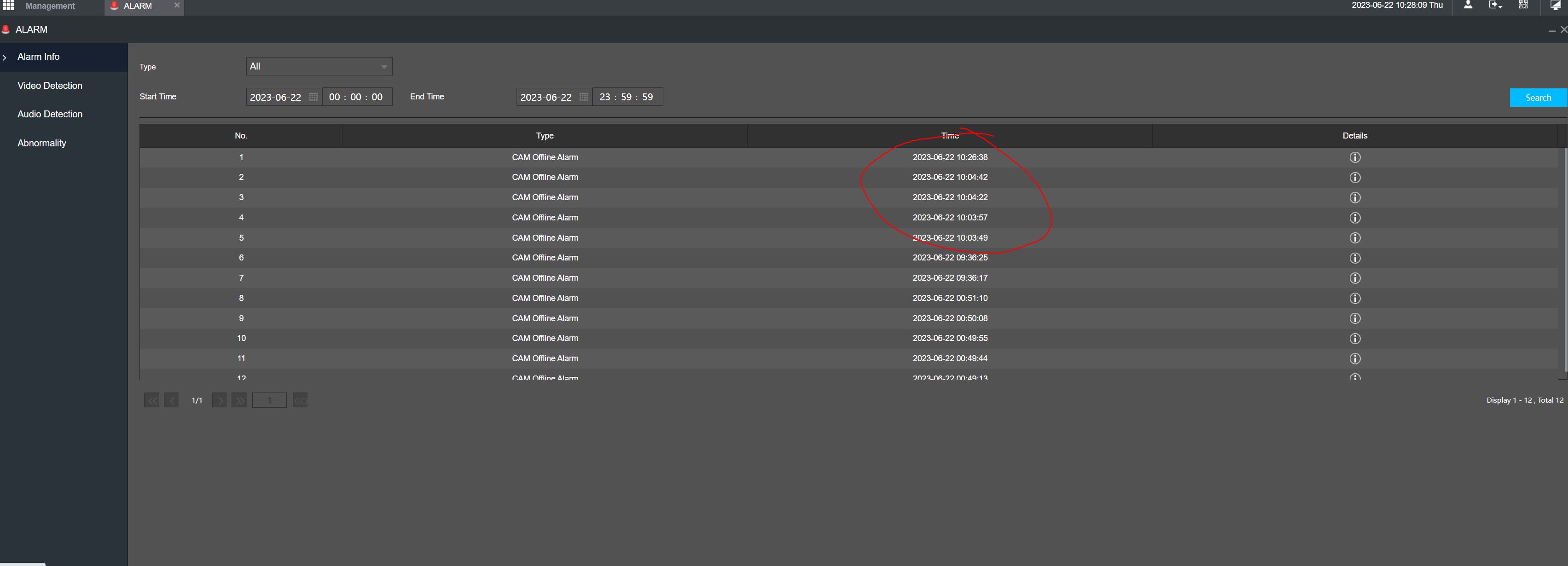

today it worked from 1am and it just stopped working at 10:30am
- arm2.JPG (185.34 KiB) Viewed 3424 times
- arm1.JPG (167.86 KiB) Viewed 3424 times
Re: camera works only at night
it just stopped working few minutes ago at 10:30am
