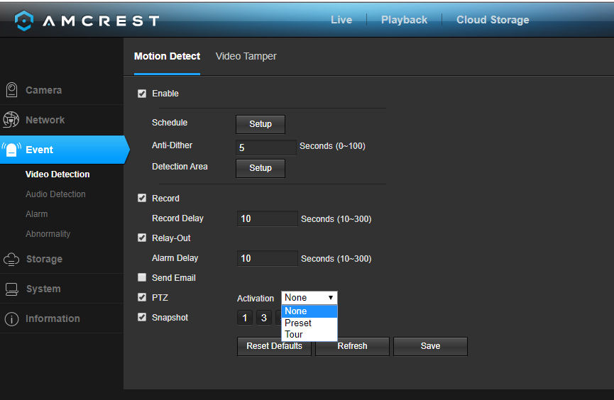

Re: Camera rotates when motion activates
Please note the picture below then. THis is from the WebUI please check this area and if it is checked please uncheck

Post by nzvlnr »
Ahh...ok. I will. Thank you !!

Post by nzvlnr »
Well, that wasnt it. There was no setting for the event .
