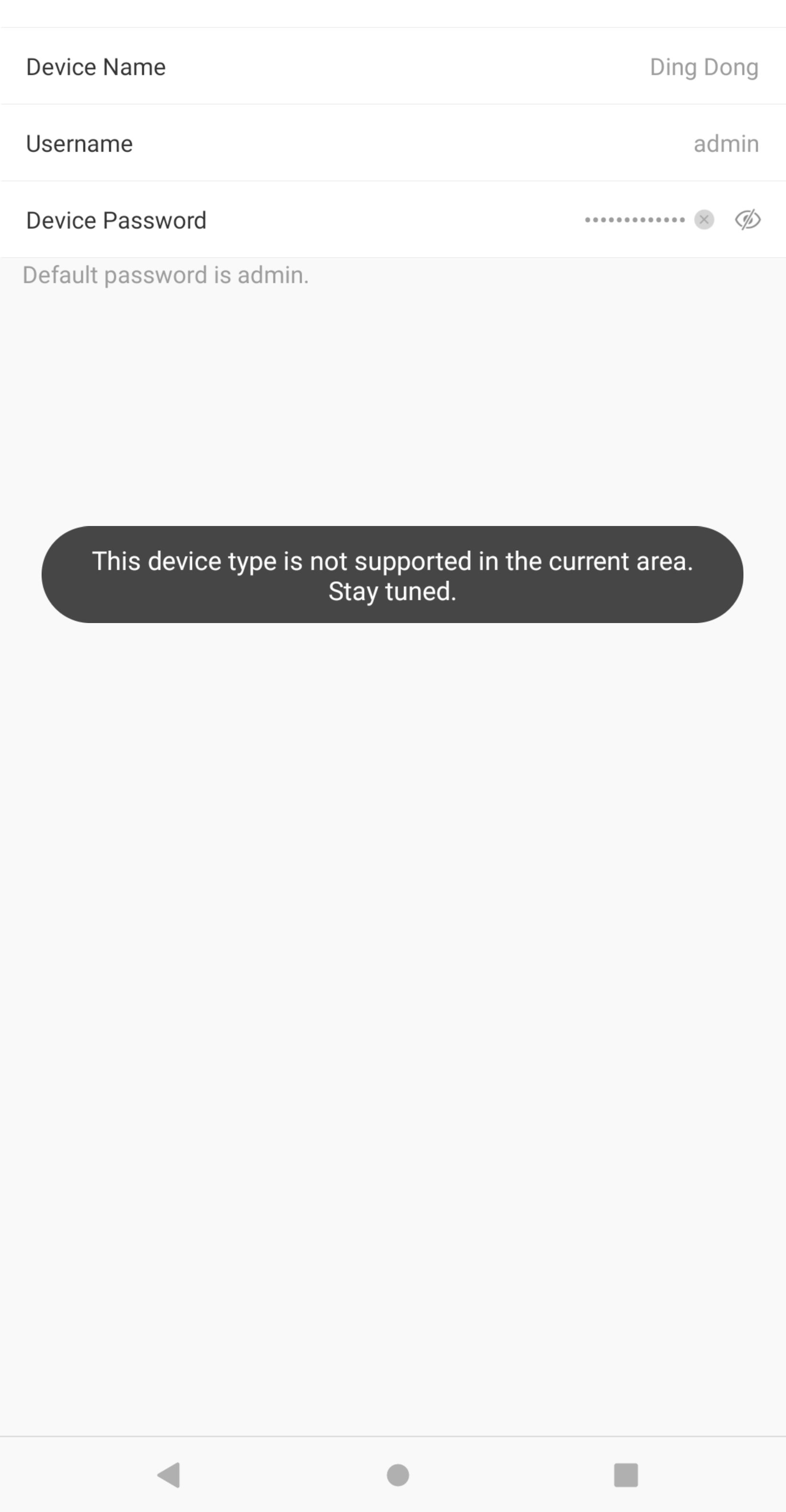

Has anyone successfully added their doorbell AD110 to Amcrest View Pro 2 app? I get an error, "This device type is not supported in the current area. Stay tuned." I selected USA region.
I can see/add it to Amcrest View Pro, and Smart Home apps.
- Screenshot of Error.
- IMG_20250118_074804.jpg (76.59 KiB) Viewed 15286 times

Re: Adding Doorbell AD110 to Amcrest View Pro 2?
But late last night I did find another POE doorbell cam that is WAY off the radar.. IMO.. (https://linovision.com/products/hd-vide ... com-door01)Revo2Maxx wrote: ↑Sun Jan 19, 2025 11:57 pm Seems to be doorbell only issue. Seeing I can add my other ASH line of cameras to AVP2
Cool! So might just be software lagging product.
Keep in mind that the AVP2 is newer then it was last month and was able to add the doorbells in the other AVP2. The new one I can't add Ad110 or Ad410 to AVP2 but all other cameras from Smarthome can be added.
My first exposure to AVP2, and Amcrest overall. Is there a way to get the previous version of AVP2, or is that advisable?
So to add to my previous statement, really looks like software issues.![]()
Next when the Smart home first came out couldn't add any of the SH to AVP.. So it might be updated to let in the Doorbell in some new App update in the future. But really other then just for Monitoring why would it matter? Can't answer the doorbell with that app have to use SH app for aswering the doorbell anyway..
That last line... "Cant answer the doorbell with the AVP2 app".. I can talk 2-way with my Amcrest IP2M-841W-V3 from the AVP2 app. But the doorbell being "SH" evidently does not allow? If so, THANKS for the heads up! The doorbell had (3) tasks - 1) Ring the exisitng inside bell unit 2) let us see who/what is there and 3) Speak with them. Looks like the AD110 only does one of them.![]()
Plus like having the other app for fast access to SH line where I don't have to pick from a list of Ip cameras looking for one of the SH line.. But not everyone has as many camears as I do either..
I am only at 16 (?) cameras, with BI being my environment of choice (ATM) and looking into Frigate/Home assistant on a Debian box. I am a total n00b on linux, just getting my feet wet. Just loaded Debian onto an old laptop two days ago to start to get used to it. Plan to have a mini computer (HP EliteDesk 800 G6 Mini ) running 24/7.
I am calling them soon, as they are a time zone over and just opening. Will report back.
Update! For those who might follow...
BE SURE THAT THE CAMERA YOU BUY HAS WHAT YOU WANT!! IF it says 'Amcrest Smart Home' ... BEWARE. I will be even more careful reading from now on. I am having to return the AD110 for not paying attention. Gotta love Prime... great CYA.
Chatted with David at Linovision. I had called the sales number (by accident..
) and then the correct support number.
No answer on either, but they called back!!
The camera DOES have a web interface, and is made to be compatible with many systems. Hope it works with the AVP2, but if not no biggie. Comes with Guarding Vision, an app that is compatible with P2P devices (Like all my other Amcrest cams!)
The only other option I found was the ReoIink POE doorbell. Many people (myself included lately!) thought it was the only option for POE doorbell. I got lucky and found a reference to the Linovision, and the resulting web search was fruitful. I have had NO end of frustration with ReoIink, so I was very happy to find an alternative. YMMV of course.
