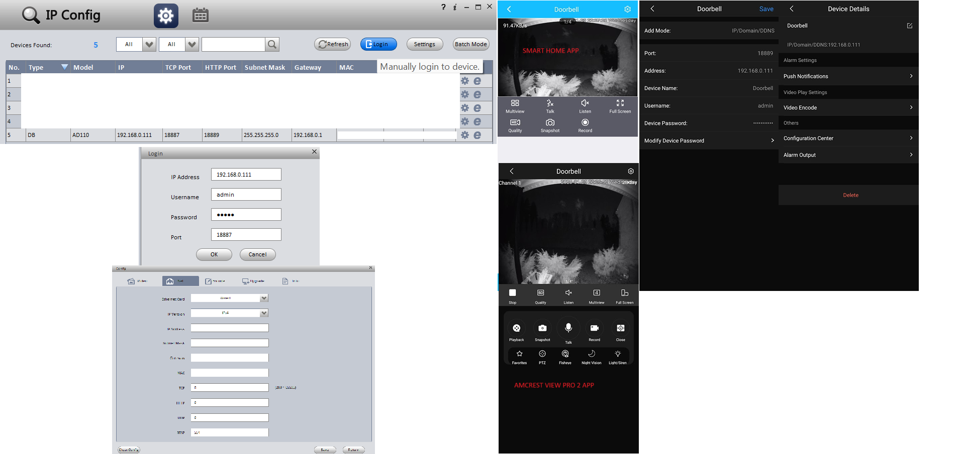

Yes, I was able to get the AD110 working in the Amcrest View Pro 2 app. However, since the AD110 doesn’t have a built-in web server, you have to work around it—and it's not a great experience.
Steps I Took:
1. Download the Amcrest IP Config Tool – You can find it here: https://support.amcrest.com/hc/en-us/ar ... l-Download
2. Log into the AD110 – Use the IP Config Tool and enter the password you originally set up when onboarding the doorbell through the Amcrest Smart Home app (which, to be honest, was a painful process).
3. Assign Ports – Since the View Pro 2 app requires a port to add a camera, I manually assigned ports to the AD110.
4. Add the Camera to View Pro 2 – I used the IP method within the app, and after that, the camera started working.
My Thoughts:
- Terrible user experience – The process is completely undocumented, making it frustrating for users.
- Poor design by Amcrest – If it weren’t for local microSD storage, I wouldn’t consider purchasing another Amcrest device.
- Inconsistent product development** – I have 12 Amcrest cameras that work seamlessly with View Pro 2, yet the AD110 feels like it was designed by a completely different team. Unlike the IP2M series, it lacks essential web features, which is frustrating for long-time Amcrest users.
Hopefully, this helps others trying to get the AD110 working in Amcrest View Pro 2! If you run into issues, let me know.
Screenshot 2025-01-29 225122.png (317.17 KiB) Viewed 11673 times
