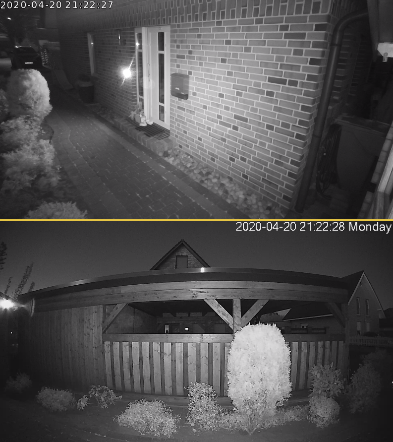

I installed my AD110 today and during daytime everything was working fine.
Tonight i realized, that i kept on hearing the "successfully connected to network" prompt and saw the IR cycling.
What could this be? This is extemely annoying, not only cause of the disconnects, but also because of the voice talking in direction of the neighboring house every 5-10 minutes.
Please help!

AD110 - frequent reconnects/reboots
- ir_party.png (831.85 KiB) Viewed 2706 times

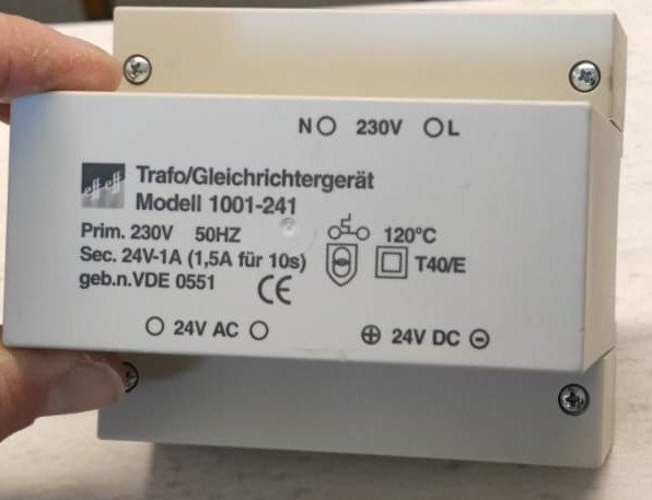

If this is a power issue, i simply dont understand.
The user manual (https://drive.google.com/file/d/1JmduLO ... UHB7M/view) states:
This is the transformer i had an electrician install:
Patrick
thanks for the feeback and the welcome!
I had my transformer replaced, especially to suite the needs of the doorbell.The device is compatible with a standard 16~24V AC or 12V~24V DC power adapter.
Patrick

IF you are trying to power it off the specs that I am looking at there are 2 issues...
1 the Power supply while I am not 100% sure looks like it is a DC 24v or maybe it is purely 2 type supply depending on where you connect the wires DC if connected as Diagram shows on pegs in that area.. And AC if connected to pegs in that area... SO is that is the case and you connected to the ac side sadly this brings me to another issue I see with this supply..
2 the Power supply shows only a 1amp 24V and 1 amp is far to low of power to make this camera work.. To be honest I am surprised that it even powered up to start with... If we look at it in effect of what numbers are your power supply is only a 24v 24va power and min wanted power is 16vac 30va and at them numbers that is 1.875amps so if we were to use a PSU under 24v and still needed to keep the 1.875amps we would need a 24vac 45va power supply...

Sadly on Page 3 where they say a 16 to 24vac is required there is no mention of the Amps needed... This is the first Manual that was made for the First Doorbell that was built for Amcrest and it is said that newer version of the Manual will have more info about Power Requirements..
As I was saying before with an under rated Power Supply the system might work for a bit however under IR load it wouldn't work long if at all because the power would drain before the supply could charge the caps up inside the camera... Without the Caps in the camera as it is now the camera wouldn't function past the first Connected message because that would be enough to discharge the system and power supply not able to reload in time.. However with the system working right and Power removed from the unit the system will take about 40 seconds to 1 minute for the Caps to discharge to the point the camera halo light would go out...
Also you have a Quote with DC as being OK and this is Not a DC Powered ITEM needs to run on AC 16 to 24v and on page 3 says 16-30vac is ok

Sadly I had my friend call me and asked me to explain the numbers and I can't edit my post now so here is some info for the ones that are looking for more info...
Looking at this and wondering how to know what amps a 24vac 45va is doing you would take your AC power in watts 45 and divide by the Volts 24 and this you would get the Amps of 1.875.
So doing the same with 30va 16vac power supply would also be 1.875 amps... Hope this clears that up...

Hey James,
thanks for all the work, but to be honest:
This is simply unacceptable.
I am buying a camera for 130€, buying a transformer for 40€ and also paying an electrician to have the upgrade done to the power requirements stated in the items handbook and then it does not work as expected?
Where else am i as a consumer meant to do research as to what i need to have this item work?
I am neither an electrician, nor planning to become one, which is why i had an electrician review the manual, requirements, verify the transformer as i bought it and also install it.
I would really like a clarification by amcrest as to what im supposed to do now.
Sidenote: Since we're in the middle of a pandemic im unable to return this now used transformer to the merchant, since he denied return.
Edit: This is an AC/DC Transformer, simply differntiated by the ports you connect it on.
