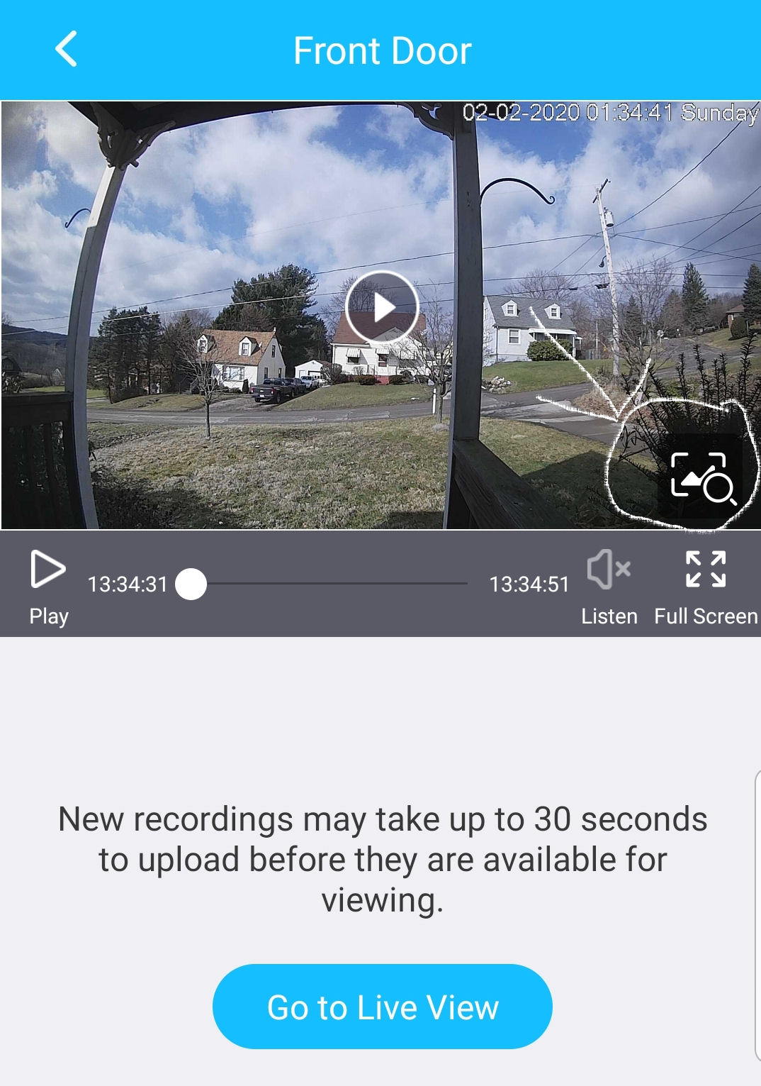

How do you download an event from the micro sd card? I have tried on the Amcrest Smart Home android app and also in Amcrest Surveillance Pro on a mac (which indicates "Channel Channel 1 search failed." when i try to view events.

Well for some odd reason mine just stopped working lol... Seeing I haven't done it many times I wanted to test it out again so I knew the Steps however when I just tried it says Network Error grrr...
Anyway when you have a Clip that was recorded. I Press the Pause, Then on the bottom right is magnify glass You can click that and it will have Share and download. So for what ever reason that clip don't like me I just did the second one in the list and it worked fine... This can't find the access on full screen so when the screen is with picture at the top of the screen you can get to it from there.. Then it saves to your phone folder...

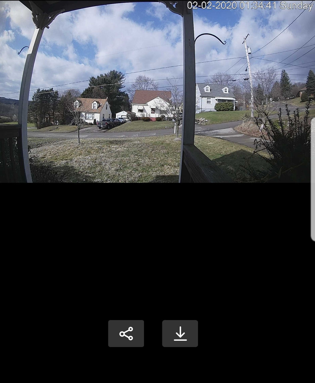

Ok well I never needed to check it until now while that option is there sadly I thought it was for DL the footage and come to find out it only for the Image that is displayed lol.. So Disregard what I said Before... I tested but never looked and dl file just left in folder until just now.. Only an image.. Sorry I am only Human..

The app on my android phone, only shows that symbol when I select a notification from the android pull down screen. That takes me into the app with the "download or share" options. When I select either it says "network error". That symbol doesn't show up when I review events straight in the app.
