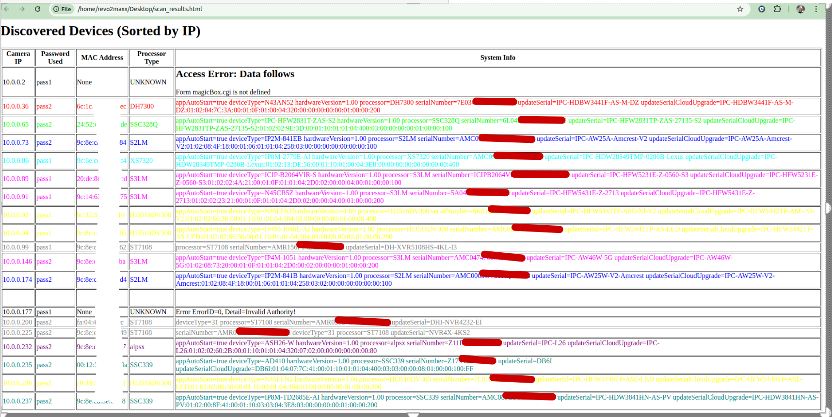

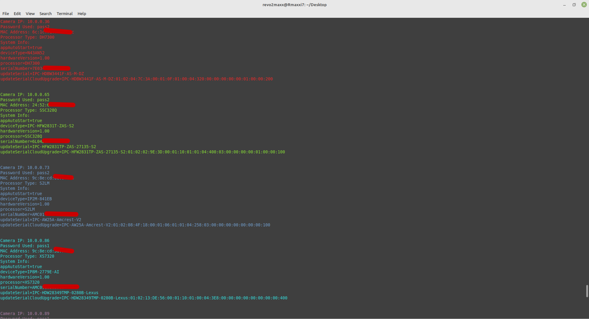

OK well I got it working somewhat lol. I mean maybe in the mind it is better then the real results. Took a good few tries and being locked out of some of my cameras before I got it working to a degree that I like it enough. First I setup using only 1 password, then thought well that won't work seeing I have cameras that has more then 1 so setup having multi passwords. Found out that passwords and script wasn't happy so I had to make it so I could put in the specials and different ones seeing I have a few different passwords with !@#$%)+
Some how I knocked out one of my Dahua cameras in all this testing of my script, I got locked out, used one of my other computers to reboot the camera and it never came back online. So I logged into the POE Switch it was connected to and rebooted that. All my other cameras came back online, but some reason it won't come up. It is all good The camera faces an area with little to no traffic.
If you happen to do scripts can you take a look at this and see what I can do to clean it up a little? Also if you are reading this and would like to have a version that won't have to scan the whole network range I could post a little change in the code that will only scan a set number of IP addresses rather then the whole network.

Re: Need some help with my Script This works want Mac info as well
So I will admit I have not worked on this much but I did get a result that I am happy with.. You can find the script below if you wanted to also do something like it. I have a few different types of these script in place and seeing I have it worked out in my head well enough now I can make changes if I need. However trying to get more data will require messing with things so that might not be as easy..
So after some time I was able to get it to search my network and list devices. Then I wanted to update so it would only list devices that will be printed. However after making that change from showing each ping to just saying that it is doing a scan and then it just sits there and waits until it ran the whole range. I thought ok lets make it so I can watch as it goes but didn't post any device info until the end. Then just as I thought that is good enough I added another camera to my setup lol. I was like man I don't want to have to wait until it scans the whole range again so I went in and added the ability to just scan 1 ip if I wanted to this way I can add in new cameras added after setting up the list for my records...
So this end result is a script that will scan my network using in my case 2 different passwords and then printing out to screen the list of devices. Again running the script it will ask if you want to do 1 or the whole network..
Changes you will need to make. 1 if your network isn't setup on 10.0.0.xxx then you will need to change the code where I have my network range added. Also you will have to change the passwords. Because of the way passwords work or fail I have added to the script the ability to do special Charactars as well..
I am not a script guy so this I am sure isn't going to be perfect. I am sure there are things that I could have done that made this smaller to easier but it works for what I want and having the ability to have some info about each of my cameras 1 in print form seeing I have also printed out the list. I can put in a 3 ring binder and keep info in arms reach.
This does Dahua and Amcrest cameras. If I feel like it at some point I might add in the ability to also get info from Hikvision cameras. Seeing most of my cameras are Dahua or OEM of such I didn't try much with hikvision before I just kept it Dahua Based..

ultimatecodewarrior
Posts: 26
Joined: Mon Jan 13, 2025 3:04 pm
Post by ultimatecodewarrior »
My remix with up to 256 threads in parallel for a less than 15 second complete scan of your IP range.

OK I need help lol So I wanted to list the output in connection with same Processor just so I knew.. So yeah as it printed in terminal in color with same color to same CPU, Then I setup so it would save to a text file but forgot that it won't save in color that format so I thought ok will just do something in HTML format and well you can see what I really want in the first picture but then I went over board and the output to html is worse lol I mean sure I could do screen shots but that is just to much.. Right now have some of my devices behind VLan so they are not showing up as these are the ones in my current PC vlan.. Once I gert it to an output I like I would like to open my network do the scan and then do a full list.. Plus need to work out something in future that will let me add in my POE NVRs connected cameras as well lol. Covered the SN and Mac address into in the pictures don't want trolls lol.. I know I need to make some changes in my colors as well lol.. In terminal output looks fine for most part.. Geez need to take a break lol..
Screenshot from 2025-02-19 07-20-41.png (150.59 KiB) Viewed 6308 times
Screenshot from 2025-02-19 07-09-45.png (589.34 KiB) Viewed 6308 times
ultimatecodewarrior
Posts: 26
Running the script will :
-Scan for the Cameras
-Create HTML table with dynamically sortable columns, just click on the column heading to sort asc/desc
-Startup a small webserver
-Launch your browser to load the HTML file.
-Don't forget to change the passwords/ip range

<!DOCTYPE html>
<html lang="en">
<head>
    <meta charset="UTF-8">
    <meta name="viewport" content="width=device-width, initial-scale=1.0">
    <title>Discovered Cameras</title>
    <style>
        table {
            width: 100%;
            border-collapse: collapse;
        th, td {
            padding: 8px;
            text-align: left;
            border-bottom: 1px solid #ddd;
        th {
            cursor: pointer;
        th.sort-asc::after {
            content: " ▲";
        th.sort-desc::after {
            content: " ▼";
        tr:nth-child(even) {
            background-color: #f2f2f2;
        tr:hover {
            background-color: #ddd;
    </style>
</head>
<body>
    <h1>Discovered Cameras</h1>
                <th onclick="sortTable(7)">Hardware Version</th>
                <th onclick="sortTable(8)">Update Serial</th>
                <th onclick="sortTable(9)">Update Serial Cloud Upgrade</th>
                <th onclick="sortTable(10)">App Auto Start</th>
    <table id="cameraTable">
        <thead>
            <tr>
                <th onclick="sortTable(0)">IP Address</th>
                <th onclick="sortTable(1)">Password Used</th>
                <th onclick="sortTable(2)">MAC Address</th>
                <th onclick="sortTable(3)">Processor</th>
                <th onclick="sortTable(4)">Device Type</th>
                <th onclick="sortTable(5)">Serial Number</th>
                <th onclick="sortTable(6)">System Info</th>
            </tr>
        </thead>
        <tbody>
        </tbody>
    </table>
    <script>
        //<td>${camera.hardwareVersion}</td>
        /// <td>${camera.updateSerial}</td>
        // <td>${camera.updateSerialCloudUpgrade}</td>
        //  <td>${camera.appAutoStart}</td>
        document.addEventListener('DOMContentLoaded', function() {
            fetch('discovered_cameras.json')
                .then(response => response.json())
                .then(data => {
                    const tableBody = document.querySelector('#cameraTable tbody');
                    data.forEach(camera => {
                        const row = document.createElement('tr');
                        row.innerHTML = `
                            <td>${camera.ip}</td>
                            <td>${camera.password_used}</td>
                            <td>${camera.mac_address}</td>
                            <td>${camera.processor}</td>
                            <td>${camera.deviceType}</td>
                            <td>${camera.serialNumber}</td>
                            <td>${camera.system_info}</td>
                        tableBody.appendChild(row);
                    sortTable(0, true); // Default sort by IP Address descending
        function sortTable(columnIndex, descending = false) {
            const table = document.getElementById('cameraTable');
            const tbody = table.tBodies[0];
            const rows = Array.from(tbody.rows);
            const th = table.tHead.rows[0].cells[columnIndex];
            rows.sort((a, b) => {
                const aText = a.cells[columnIndex].textContent.trim();
                const bText = b.cells[columnIndex].textContent.trim();
                return aText.localeCompare(bText, undefined, {numeric: true});
            if (descending) {
                rows.reverse();
            rows.forEach(row => tbody.appendChild(row));
            Array.from(th.parentNode.cells).forEach(cell => cell.classList.remove('sort-asc', 'sort-desc'));
            th.classList.add(descending ? 'sort-desc' : 'sort-asc');
    </script>
</body>
</html>

# Main function to run the scan
if __name__ == "__main__":
    try:
        scan_network()
        print("\nScan complete. Discovered devices:")
        for cam in discovered_cameras:
            print(f"\nCamera IP: {cam['ip']}\nPassword Used: {cam['password_used']}\nMAC Address: {cam['mac_address']}\nSystem Info:\n{cam['system_info']}")
        # Run the server to display the HTML content
        run_server()
    except KeyboardInterrupt:
        print("\n\nScan aborted by user. Exiting script gracefully...")
        sys.exit(0)
