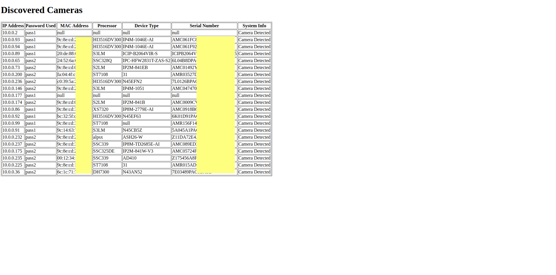

Need some help with my Script This works want Mac info as well
ultimatecodewarrior
Posts: 26
Joined: Mon Jan 13, 2025 3:04 pm
Re: Need some help with my Script This works want Mac info as well
Post by ultimatecodewarrior »
-Forum wouldn't let me update last post.
-Updated Code above, the column sort wasn't bouncing asc/desc as it should.

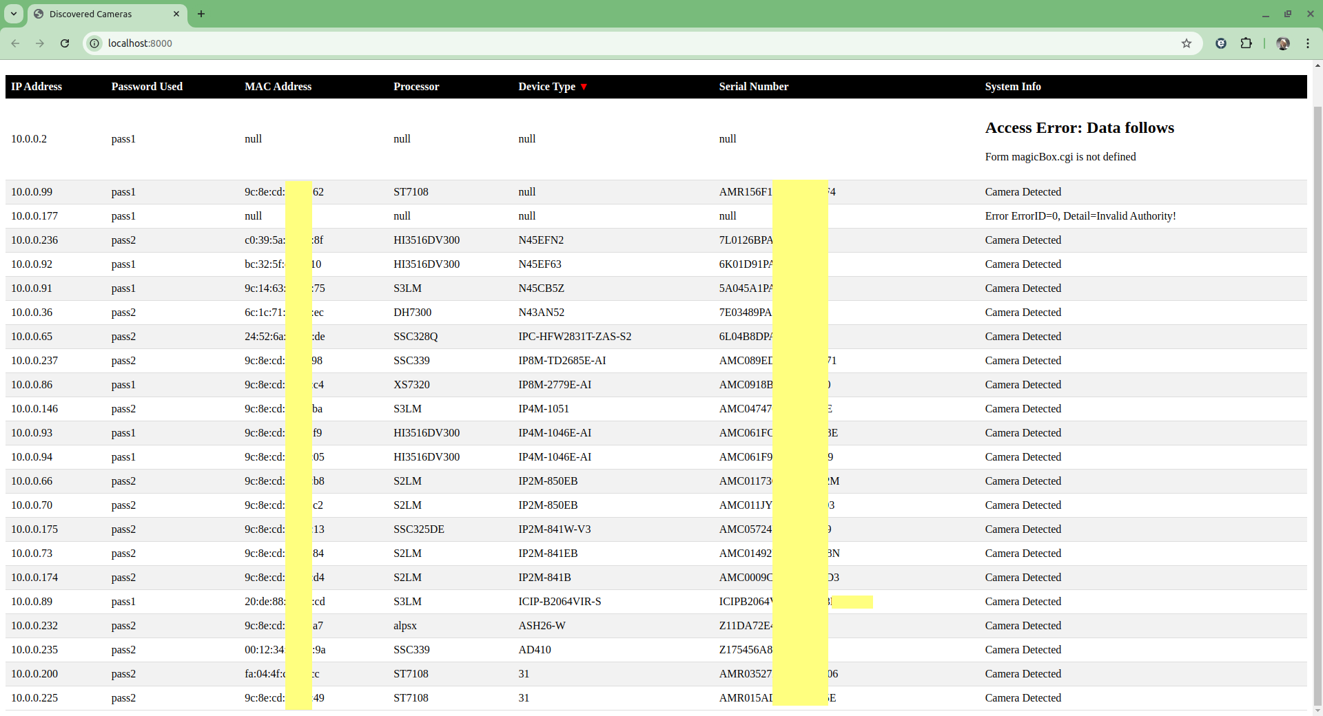

Thank you.. Very interesting. Now I just need to edit to where it don't scan my switches IP address because the junk it takes into the html makes it a mess lol.. So for now I edit the JSON file to remove the bad IPs for now and makes it look better.. Thank you..
Again thank you. That format is interesting and have to go over the script to understand it more seeing it is above my oldish man skill level lol. Oddly this time there are some things missing that I don't remember being missing from old scans. Yet seeing I printed off a list before making the color change idea lol. It did show 31 type and didn't think about it because it was showing the device in the updateserial line so didn't notice now with all the data being in a line it is easier to notice things. Plus the update info is missing so makes the fact the name showing up as 31 a larger deal lol..

If you only want to see cameras, you could do something like this:
Code: Select all
                if fields["serialNumber"] is not None:
                    system_info = "Camera Detected"
                else:
                    system_info = "Camera Not Detected"
Code: Select all
Or you could omit writing them out in the JSON.
                else:
                    continue

Sorry just got back from a couple of Doctors Apts.. Anyway I thought I would give the Ai thing a try.. Taking your script that works but as I said had some junk from a couple of my switches.. So took the script as you had it, Gave it to the Ai and asked them to rewrite it so it would work as it is setup right now but removing a few IPs from the scan list.. It rewrote it and then when I ran it it did take out the Ips and listed the found cameras in terminal but when chrome loaded for display there was an error because it took out the loading of the web service that was in your script. So I told it about the error and started to write again but after a few tries it still failed to understand what was missing from your code to the updated code to make it work.. So not sure how others make this thing work lol.. It is like here is kind of what you want if you really want it to work buy an upgrade lol.. geez so I changed one of the switches password and now only 2 switches are an issue. so asking the Ai to update the code and fresh off yours that works to not scan 10.0.0.169 or 10.0.0.170 and again fails lol.. Oh well. I will just do it my self lol..
Ok got it to work once but still not as good as yours but thought I wouldn't give up to fast here is the output after giving it to Ai and telling them it failed like 4 other times to do what expected lol..
Screenshot from 2025-02-19 17-34-04.png (158.99 KiB) Viewed 4267 times
