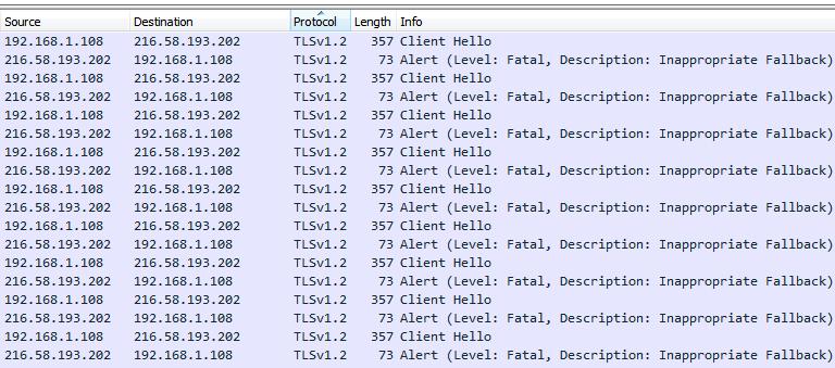

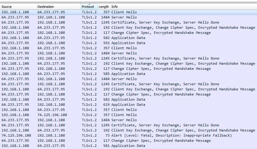

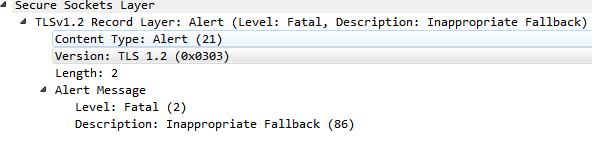

Below are some pictures, first of TLS v1.2 failure message from inside a packet, from the main fcm or googleapis addresses that has the Alert message, Alert 21 and 0x0303. And a picture of an inbound connection not working with TLSv1.2 from a 216.58.x.x address. Also a picture of a successful TLSv1.2 inbound connection by the 64... address. In the picture the wireshark packet capture results from NVR are sorted by Protocol so they appear to be happening all in a row but they are actually mixed in with thousands of other connections NVR makes in a few minutes.
Alert error message type Alert 21 and 0x0303
TLS v1.2 not working from 216.58.x.x or 172.217.x.x
TLS v1.2 works when coming from 64.233.177.95 Notice the one address toward the bottom to/from 74.125.196.108 which I think is Gmail is also giving the alert message when these packets were captured. Which might be why it opened the 64.233.177.95 address as a second resort for Gmail.
