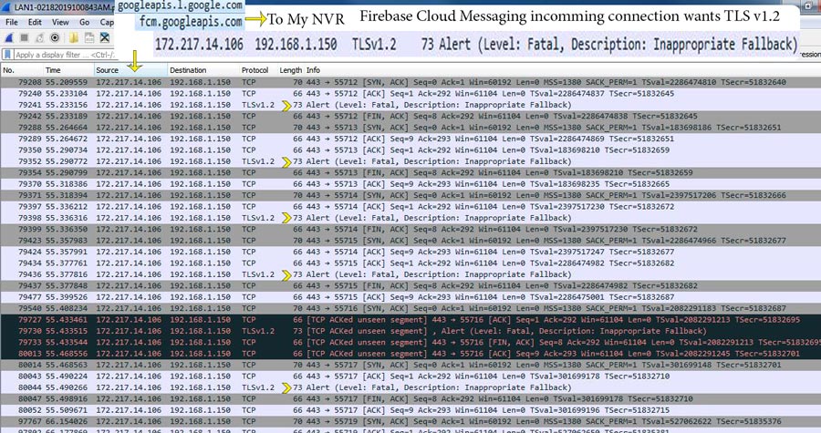

Still not found a solution just things that could be related. Saved the network packet capture from the NVR while making motion on camera that would normally send push notifications. Had to install Wireshark and it's 2 other included programs in order to read network traffic and some packet info off of NVR. I later uninstalled everything when our network slowed to a crawl around 1.5MB per second. Might not have been caused by those programs but also all the router logging, various port forwarding, changes to router, Installing required browser plugins, had 3 installed.
When my NVR makes the outgoing connection to firebase -> fcm.googleapis.com which usually shows as 172.217.X.X range. Messages going out from my NVR usually transmit OK except a for a couple reset requests to start sending them again.
When firebase -> fcm.googleapis.com tries to make an incoming connection to my NVR, it appears that firebase wants to connect to my NVR using TLS v1.2 and my NVR is not able to match that for the incoming connection.
Every few IP packets received from Firebase server say Alert (Level: Fatal, Description: Inappropriate Fallback) which repeats every few packets I read a server certificate is needed to allow TLS v1.2 connections to be made. So I tried the create your own certificate option that is included with the NVR and also tried it on a camera. On NV4108-HS a browser plugin is required to access the area to create your own certificate and install it, except NVR does not have a spot to put your email address or use a third party certificate like cameras do. Tried creating all 3 certificate types, one with my custom Amcrest DDNS name. then again my private IP 192.168.X.X, then again created a certificate to my public facing IP. Did not make any difference still saw these errors when Firebase tries to make incoming connections to my NVR. Not sure if TLS v1.2 can be accomplished on the hardware chips in future or in the software like in a NVR OS update? Tested it with UPnP enabled and P2P used on NVR, and also enabled port forwarding 443 to NVR but did not make any difference. IE and Chrome don't like the self created certificates either and both say invalid because it's self signed. I guess signed certificates are real expensive to buy and not sure if that would solve that problem anyhow.
The NVR makes like a thousand network connections and packet transfers in a few minutes of packet capture. Firebase messaging incoming to my NVR was the only connection with this type of error. Alert (Level: Fatal, Description: Inappropriate Fallback). which repeats every few packets or so. So I looked up TLS v1.2 and see that more of the big software companies like Google, Microsoft, Banks, card processors, are making connection with TLSv 1.2 mandatory. I am not sure how much of a problem it could be causing with incoming Firebase connections or just giving a warning that TLS v1.2 can not be made and the fallback method needs to be fixed. Is it possible Google Firebase might have just recently made TLS v1.2 mandatory when they connect out to individual servers? Also wonder if the data is transferred successfully when Firebase tries to connect even though it gives that message? The data in the exchanges between them do look encrypted. Also see in picture below that Firebases is using their 443 port to try to connect to my 55712-55719 port even though those were not forwarded. Rather than trying to connect to my 443 port. The connections in the picture below are all sorted by the firebase server incoming IP address to my NVR and is why they are all shown together in picture.
Then searched Firebase for TLS and see some results regarding TLS but could not tell if required when Firebase connects out to individual application server or not.
https://firebase.google.com/s/results/?q=TLS&p=%2F
Have screen capture pictures.
- TLSv1-2err.jpg (148.98 KiB) Viewed 3482 times
