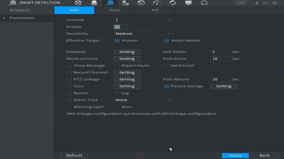

The Grid for Motion detection is the Grid that is used for Smart Motion Detection 100%. It used to even say it when it was setup that it works off the Motion grid. All settings in the Motion Grid area will work for the SMD as well as long as the SMD is enabled. Meaning if you setup for Email, alerts, or what ever is in the Motion Detection area it will pass that same info when SMD is enabled.
Lets look at MSD in the way of your IVS for a moment. When you setup an IVS rule there are some cameras that come with the Filters turned off. (Also there are some cameras that have IVS without filters) Then by turning on the Filters in IVS a dog, cat, mouse, rat or anything that passes the IVS rules line won't trigger it has to be a Human and or Vehicle.
So with Advanced AI cameras that offer SMD S=Smart Motion Detection that smart is the 2 items for the filter. While it isn't 100% perfect it keeps down the amount of false alarms being sent to push or emails.
I have many AI cameras and not all of them are setup with IVS I have some setup with SMD because of the device that I have them connected to. Normally my iVS ruled cameras have motion turned off, so if I want one of my cameras to work on a non AI recorder.
So here is a picture of one of my older AI recorders with SMD. I have the channels using IVS rules so the SMD is not enabled but in this picture you can see that says it Synchronizes with MD Configuration...
Screenshot (87).png (233.26 KiB) Viewed 8008 times
