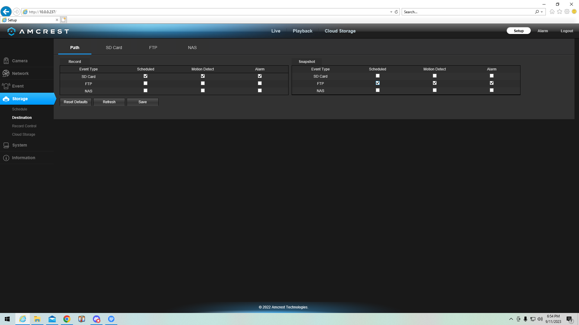

Re: IP8M-VD2893EW-AI Setup
Sorry to ask again but can you look in the cameras Storage area, Make sure that you have Snapshots setup for FTP and not local or NAS..
Also to confirm you setup your camera to take Snapshots? Also in Video Configuration area and Snapshot the Event one is setup for 1s and not something that might have been meant for Full time snapshot. Maybe by accident the event Check was unchecked and so it no longer does it. Just trying to offer some ideas of what it might be..
Post by GaryPSU »
It’s not that. I have both snapshots & video storage going to FTP. I’m getting all snapshots via email so it’s not a big deal. My previous Amcrest camera had both going via FTP. I do have an SD card installed, but haven’t set it up to receive any motion detection. Maybe just by it being installed is causing the problem. I don’t think that I can view the sd card files on my iPad. I’ll check on my laptop tomorrow. Thank you.
